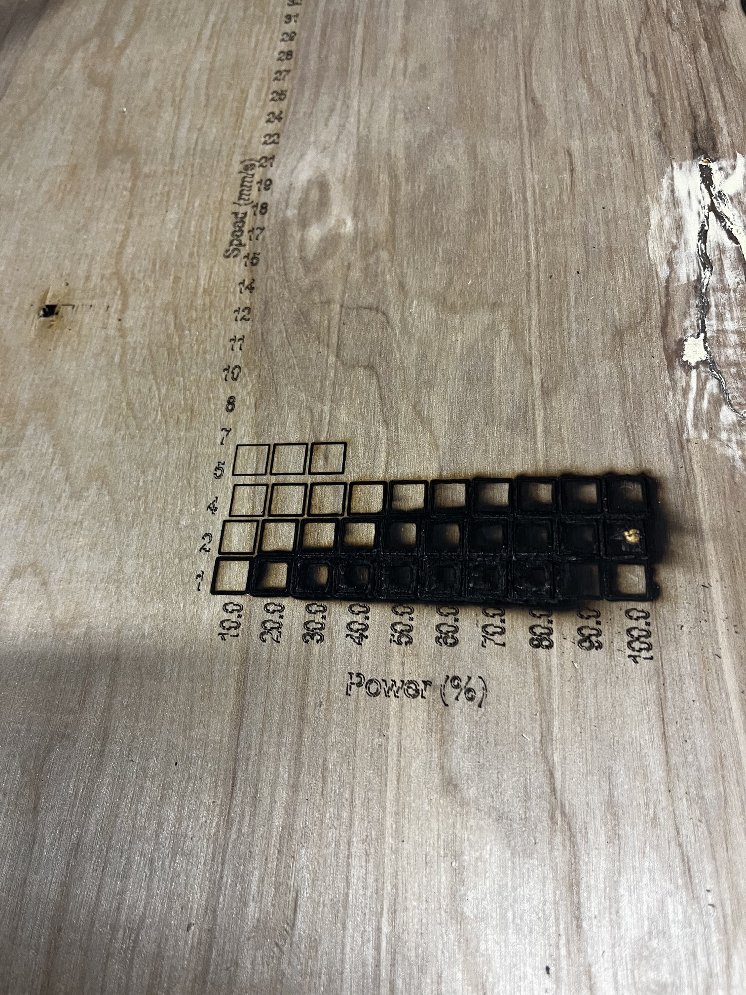

Ran a material test. This is the result, I did stop earlier because I assumed I was not going to achieve a through cut at this point
I had the LR set to its lowest point and had the bottom of the laser housing 30mm from the material. I also have the lasers focus adjustment screwed the whole way in
Should note this is 1/4” material
Air assist might make a big difference there.
In the high power/low speed.corner there is a.lot of charring which probably indicates a lot of smoke. The smoke absorbs laser power too and then deposits carbon residue precipitation, which also absorbs power. The result is as you see with a lot of black deposit around the cut area and less penitration into the material. Air assist blows away the smoke, so more laser power goes into the material and cuts it away.

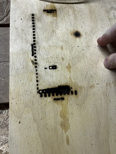

I had the air assist on, it’s an aquarium pump someone listed in a different thread but it had a pinched line.

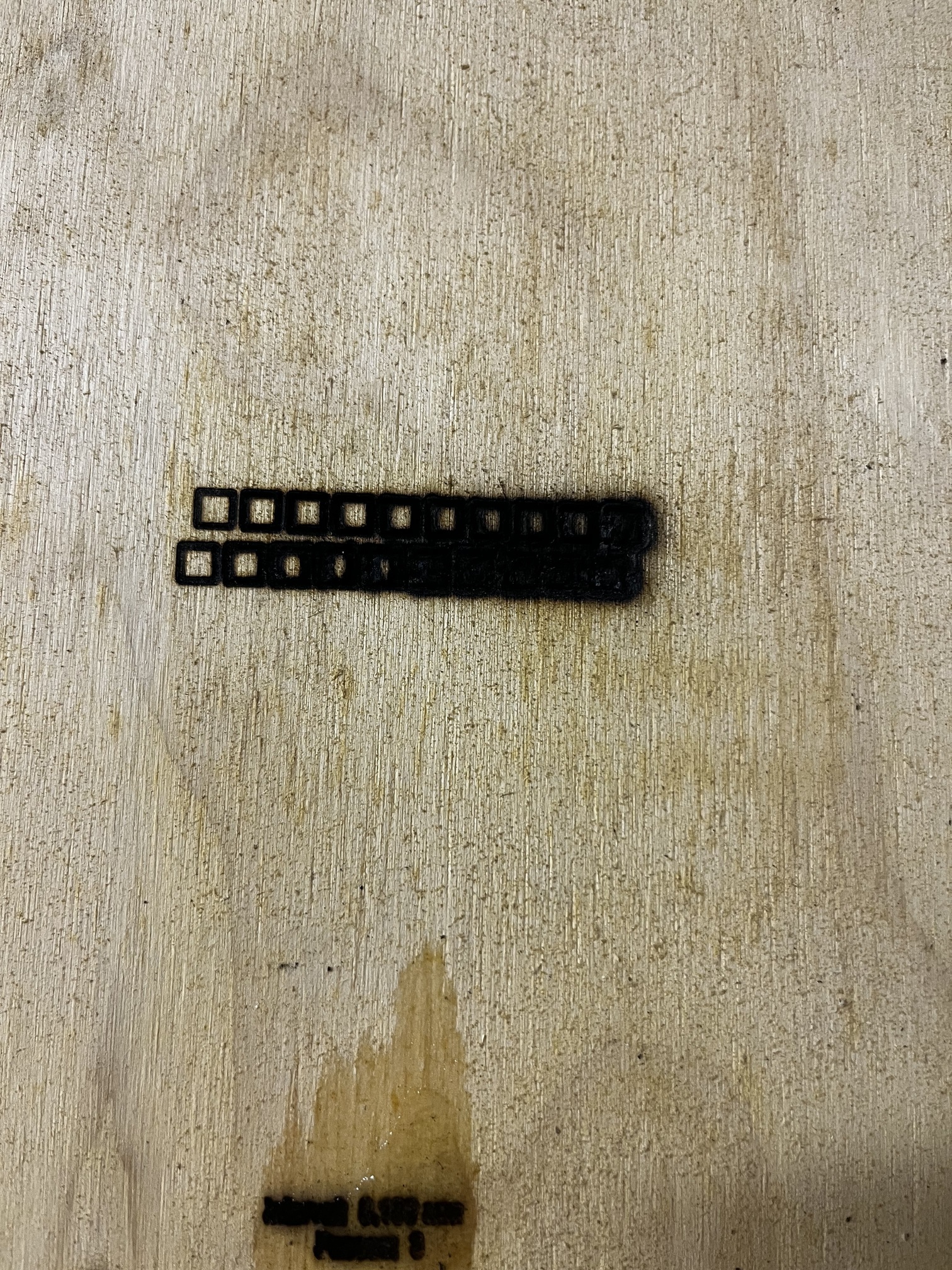

Here is the same test ran with proper air assist. Still tons of burn, not much soot. I moved the ply after 1mm/s due to the burn so the two by themselves are 4mm/s and 2mm/s from top to bottom. The bottom of the laser housing is approximately 31mm from the cnc bed
This really looks like the beam is not in focus. @dkj4linux explained his process for getting the correct focus. You really need to get that right first. I use lightburn and haven’t see any material test that looks like that.
Notice that your text is also no longer sharp. Which Controller are you using? a Jackpot?
If the intensity seems too high it may be that your config.yaml has a range that is too narrow.
One thing that helped me was to enable the “Fire” button on the movement panel. I kept tweaking the power until I could still see the point, but not do much damage to the surface it was on.

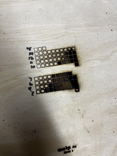

Fiddled around with it again, tried Home Depot 1/8” ply this time just because and got these results.
Definitely a step in the right direction, but I’d like to hear from you folks
