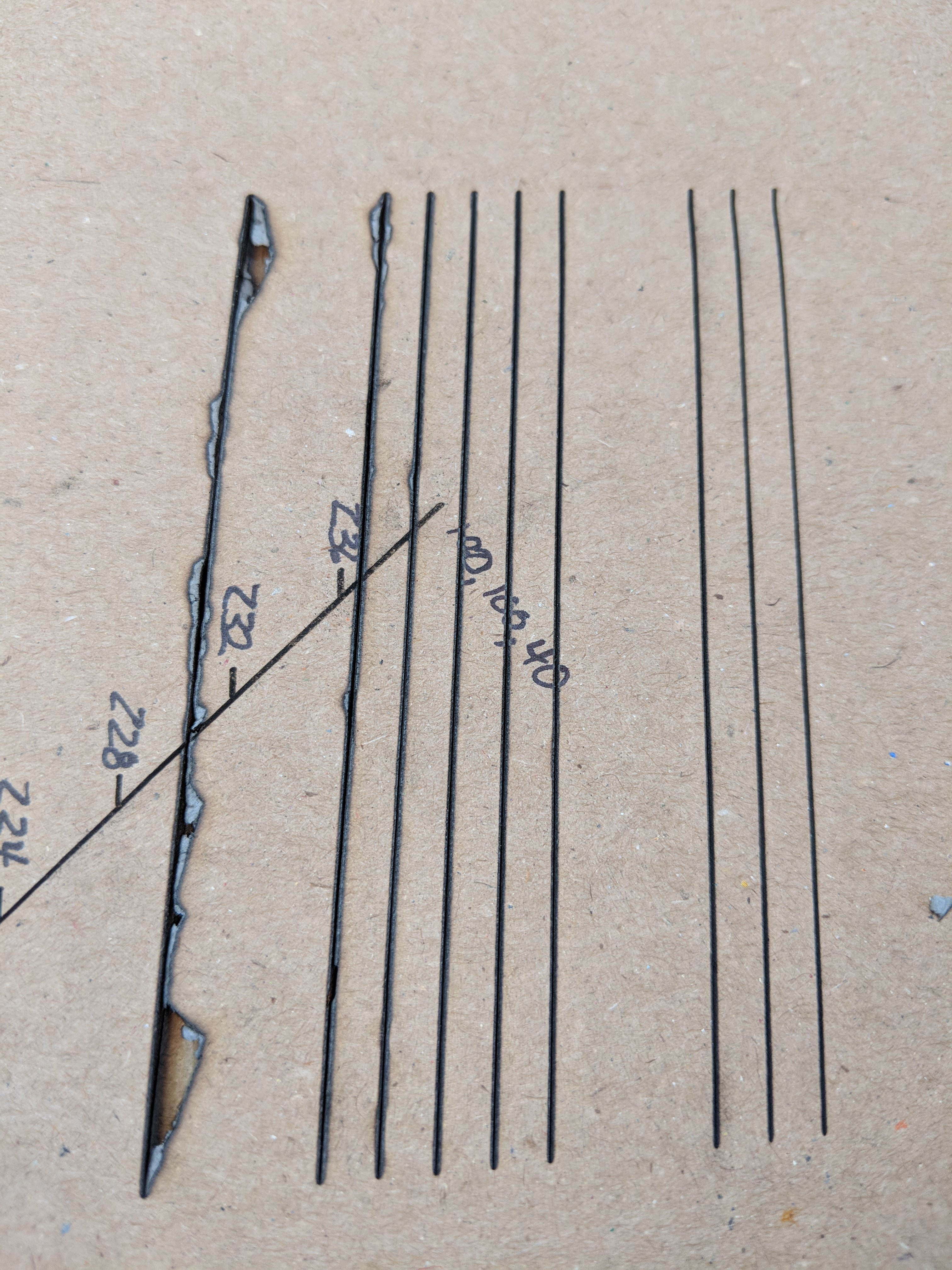

2.8W jTech laser vs. 8 months of saved Amazon boxes…
2 passes @ 200 mm / min: I almost set the top ablaze, but only got a few singe marks on the bottom. It wasn’t what I’d call a cut - just some burn marks.
[attachment file=68728]
5 passes @ 500 mm / min: The lines were a lot cleaner and I got a few very tiny cuts on the bottom, mostly around the sharp corners.

Thanks guys! I’m not quite dialed in where I want it to be, but that helps a bunch.
I have a shroud and fan assembly. The fan blows across the laser’s heat-sink and then narrows down to about a 8mm hole near the work surface. My idea was to create positive pressure inside the shroud and enough of a breeze coming out the end to clear the smoke near the work surface.

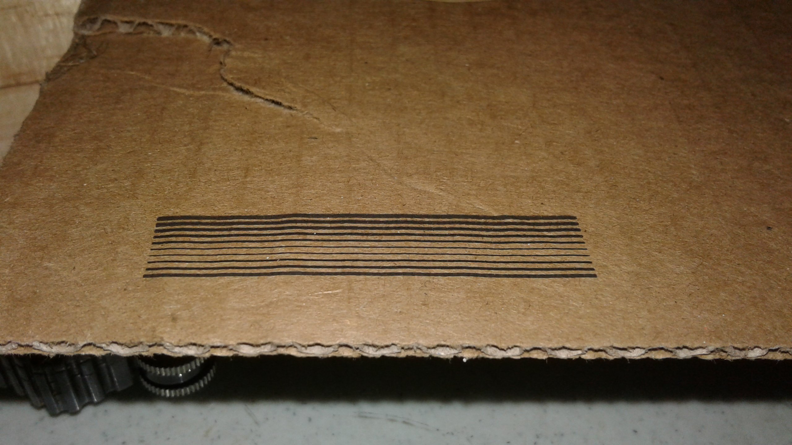

Easy to use for any material thickness… intentionally lower Z to “too close” and run the script. Ten lines are drawn 1mm apart, each 2mm higher than the one before. Count lines back to best focus, multiply by 2mm, and lower Z back down by that amount. Here, call it 6 lines back… lower Z by 12mm and you are ready to run your job
Your focus pattern doesn’t look right… you should see 10 lines and a very distinct difference near focus. Just like in my photo…
A quick way to see if you are in the 20mm of range for the script…
I send M106 S2 (you may need more depending on your laser’s threshold) from the sender program to turn on a very dim beam… barely on. Move the Z-axis down very close to the material and then use the manual Z controls to raise the laser… watching the beam closely. It should get smaller/tighter until the absolute sharpest/smallest dot is attained… that should get you close. Then, lower Z from there 10mm and rerun the script. Your pattern should look very much like the one in my photo… with the sharpest lines near the middle.
When you get a properly focused beam at the top of the material, your 2.8 watt laser should cleanly cut completely through in one pass. I’ve had at least 4 or 5 different lasers in the 2.8 - 3.5 watt range and all have successfully cut through 3mm cardboard in a single pass at 100 mm/min and full power. Sharp focus is crucial, however… it’s an energy “thing”.

You should be able to twist the lens to change the focal distance. You need a bit of room between the work and your shroud or no air will move. So lasers list the “ideal” focal length somewhere in the range of 2"-5". The laser should have no issues getting through cardboard. You seem to have way too short of a focal distance so your beam is diverging too fast and not making it through the backside. Really the longer the better, and easier to fine tune with the script.
Thanks, Ryan. I should have mentioned that I initially set up the focus for all my lasers to about 55mm or so… for smallest spot by adjusting the lens barrel. As received, they all focused much closer and there would not have been sufficient room for a shroud. I suspect that is indeed the case here…

We at least know the issue now. The first thing that really needs to be done with these lasers is to adjust the focal length… just as Ryan explained. I’m sorry I didn’t mention that up front.
The easiest, and least dangerous, way to set the focal length IMO is to raise the Z-axis so that the lens is 2-1/2" or so above the material. Turn on the laser at absolute MINIMUM power (M106 S2 does it for mine) so that you see the beam on the material and then screw the lens barrel out until you get the smallest dot you can… the laser won’t hurt/burn/cut you, at that power, as you mess with the lens barrel. Once that’s accomplished, that becomes your laser’s new focal length and you should now also have room for your existing shroud. In use, my shroud is only 5mm-10mm above the top of the material… it doesn’t need to be too much and insures good strong airflow.
