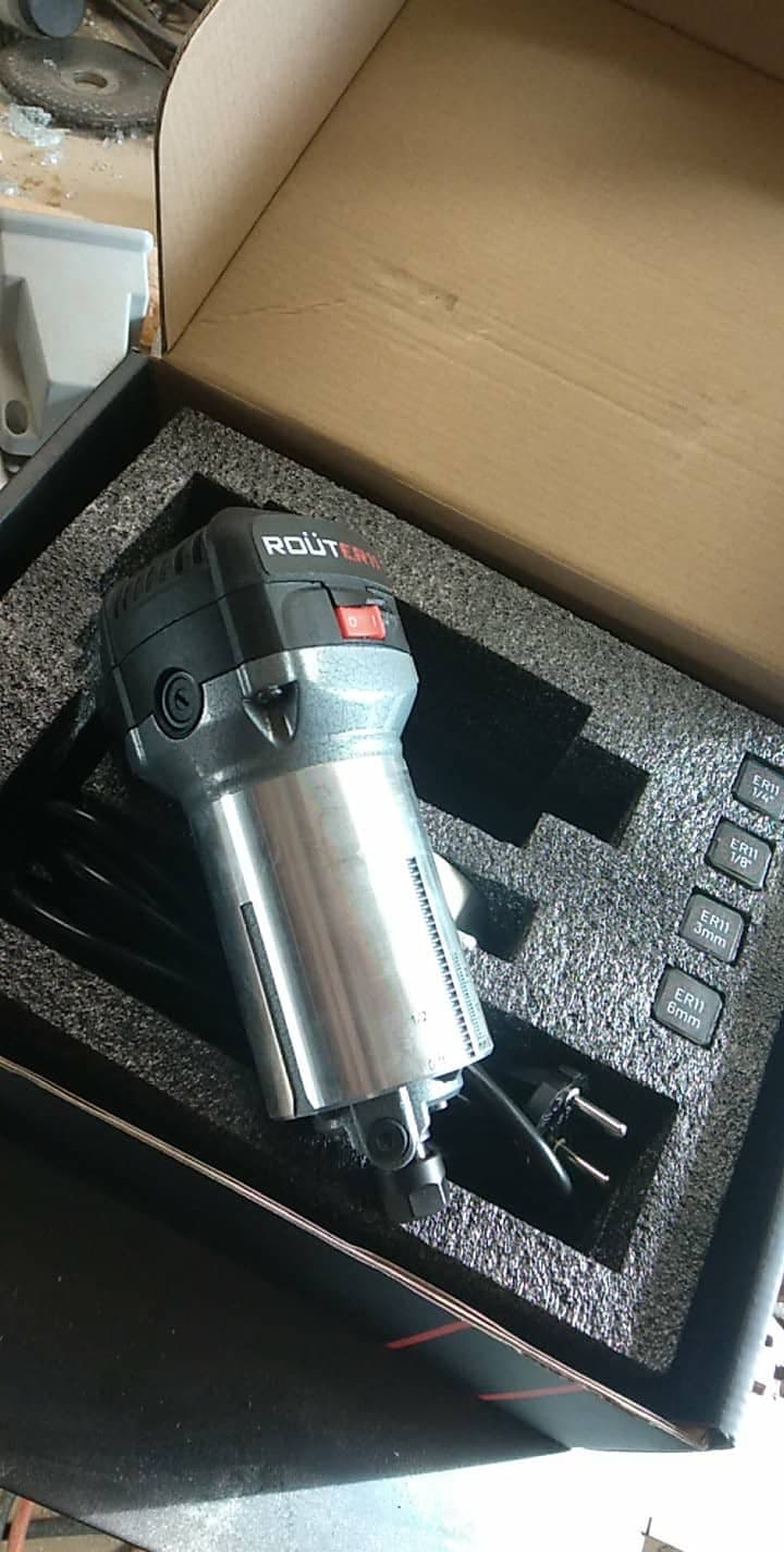

This just arrived today, it does seem to maintain a constant speed which is exciting (and a massive upgrade from the $50 routers I’m used to…)
