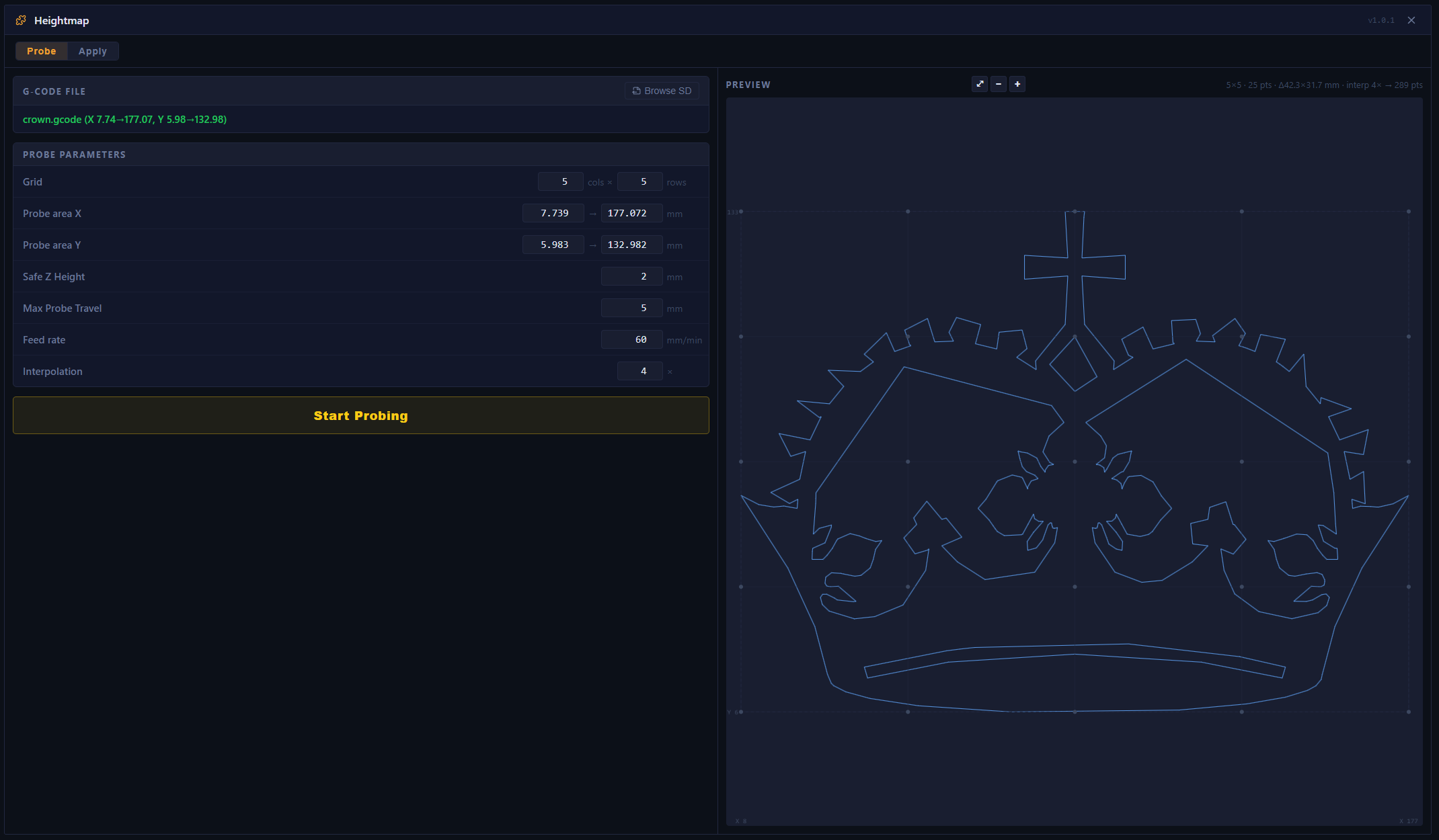

FigUI has a heightmap plugin that does this:

The general idea is that you create your gcode file like normal. Attach the workpiece to the bed. Then you probe a grid on the workpiece to create a heightmap. Then you apply that heightmap to the gcode file. That is going to take the Z values and modify them to compensate for the bed height variation. It’s going to need to split lines and curves into shorter line segments to do that properly.
I haven’t done any of this but I get the concept. In FigUI, you select a gcode file from the SD card, it determines how big it is. Determine the appropriate grid. Then it probes each point and you get a heightmap which can be applied to the gcode file.
FigUI works quite well but there is a bug in the gcode handling
if there is a rapid without a Z then the leveling code will add a corrected Z to it. It is breaking my tool change macro
i have a fix for it but havent submitted the PR yet fix: do not append Z to G0 rapids in heightmap apply · zerg32/FigUI@2acbd6f
the other important thing is that you need to zero your probe at the beginning before running the leveling procedure or the heights in the corrected gcode will be wrong
so the correct flow is to move the probe to XY 0,0 and then probe and set Z to 0 before starting the leveling
