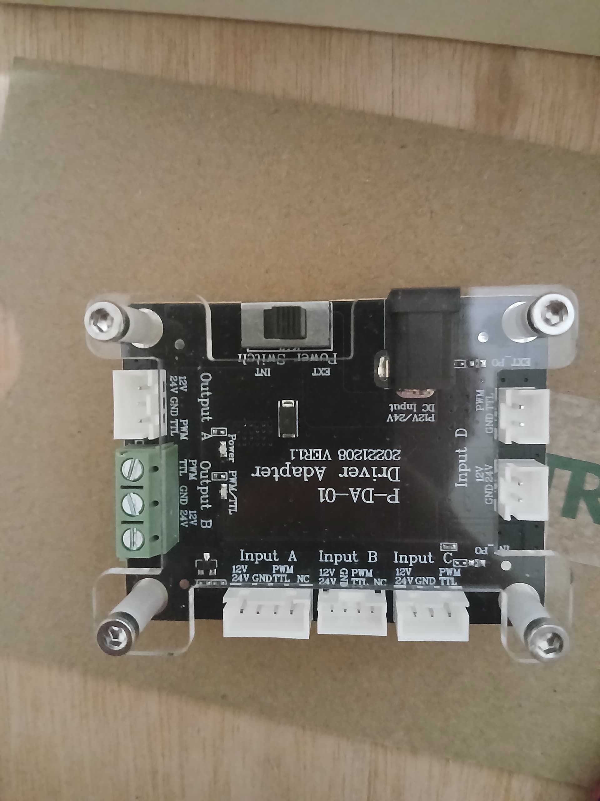

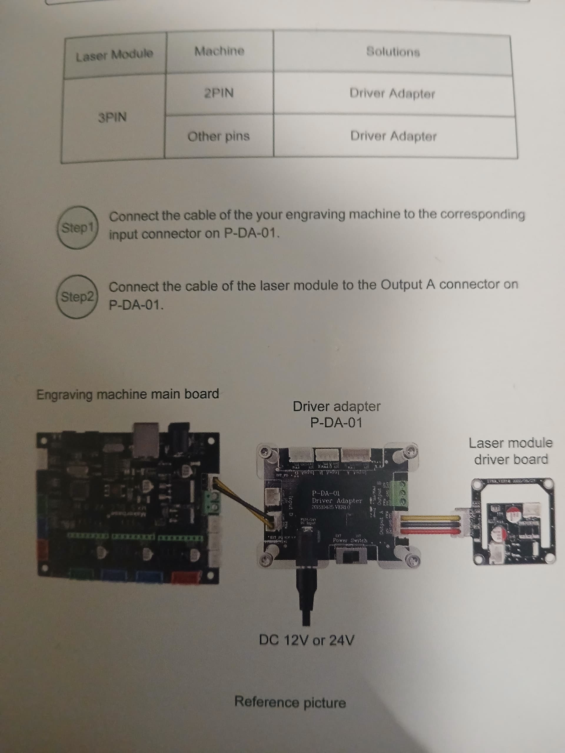

Hi Jim, So nearly all the parts have arrived (just waiting on wire then I can begin) and it did come with an adapter board however I’m still a little confused. So do I connect the cable (that came with the laser) to the laser and adapter board and then adapter board to jackpot for the PVM( it says it is 0/3 - 12v, 0-5kHz)? and obviously wire the adapter board to the power supply.
Hi Robert,
Note if you are going to be running the companion board, running larger gauge wire will require you splice it into the provided cable.
Im going to use the companion board. Would i just get a 2 pin connector and connect it from the driver adapter to the gpio27 and GND pins on the Jackpot CNC as shown in the manual for the laser? obviously subsitute the “engraving machine main Board” for the Jackpot cnc controller
Yes, the two-pin connector will connect the companion board to the Jackpot as described. If there is a ground pin adjacent to gpio27, then I’d splice some wire into the provided connector to make it as long as needed. This connection does not carry any significant current, so the wires can be small.
As for the connection between the companion board and the laser, I’d use l heavier gauge wire for the black and the red wires, or I’d mount the companion board on the core and run heavier wire to carry the voltage to the laser.
I don’t really want to mess with it but I think the wire that came with the laser is supposed to manage the connection between the driver adapter and laser ie the 3 pin cable that came with the laser as I didn’t get a cable for the connection between driver adapter and jackpot cnc controller. I got 16 AWG wire for connecting the power supply to the driver adapter?
Thanks for quickly confirming much appreciated!
The three-pin cable connects the laser to the companion board. Most people mount that board near their control board (i.e. Jackpot board). If you do it that way, the provided three-pin cable won’t reach the laser, so you will need to extend the wiring. The alternate solution is to mount the companion board on the core and run the 12V or 24V to the core.
I’m surprised your kit did not include a two-pin connector. The pins are space such that Dupont connectors can be used. I use a bit of low-temp hot glue to lock in the Dupont connections.

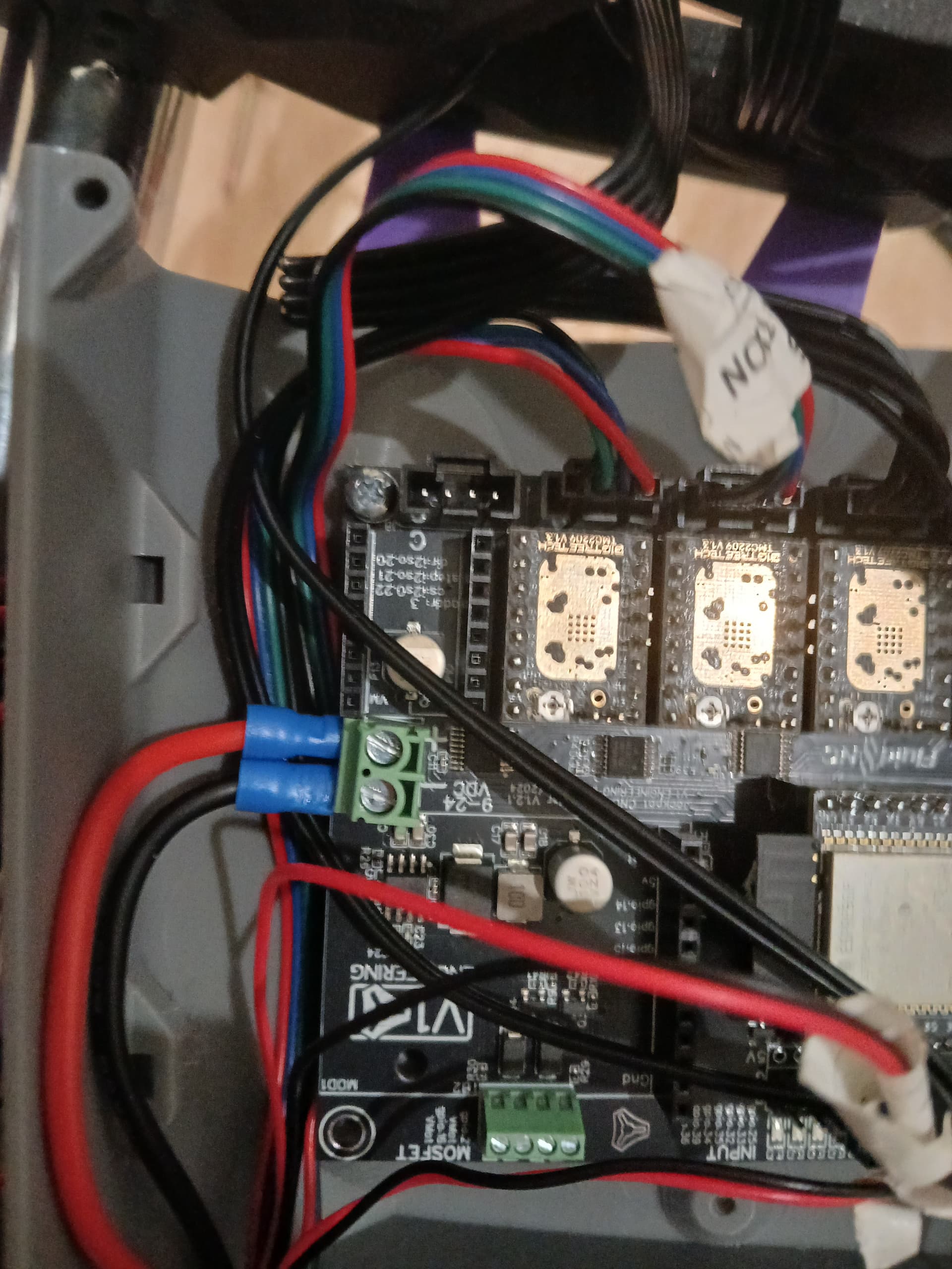

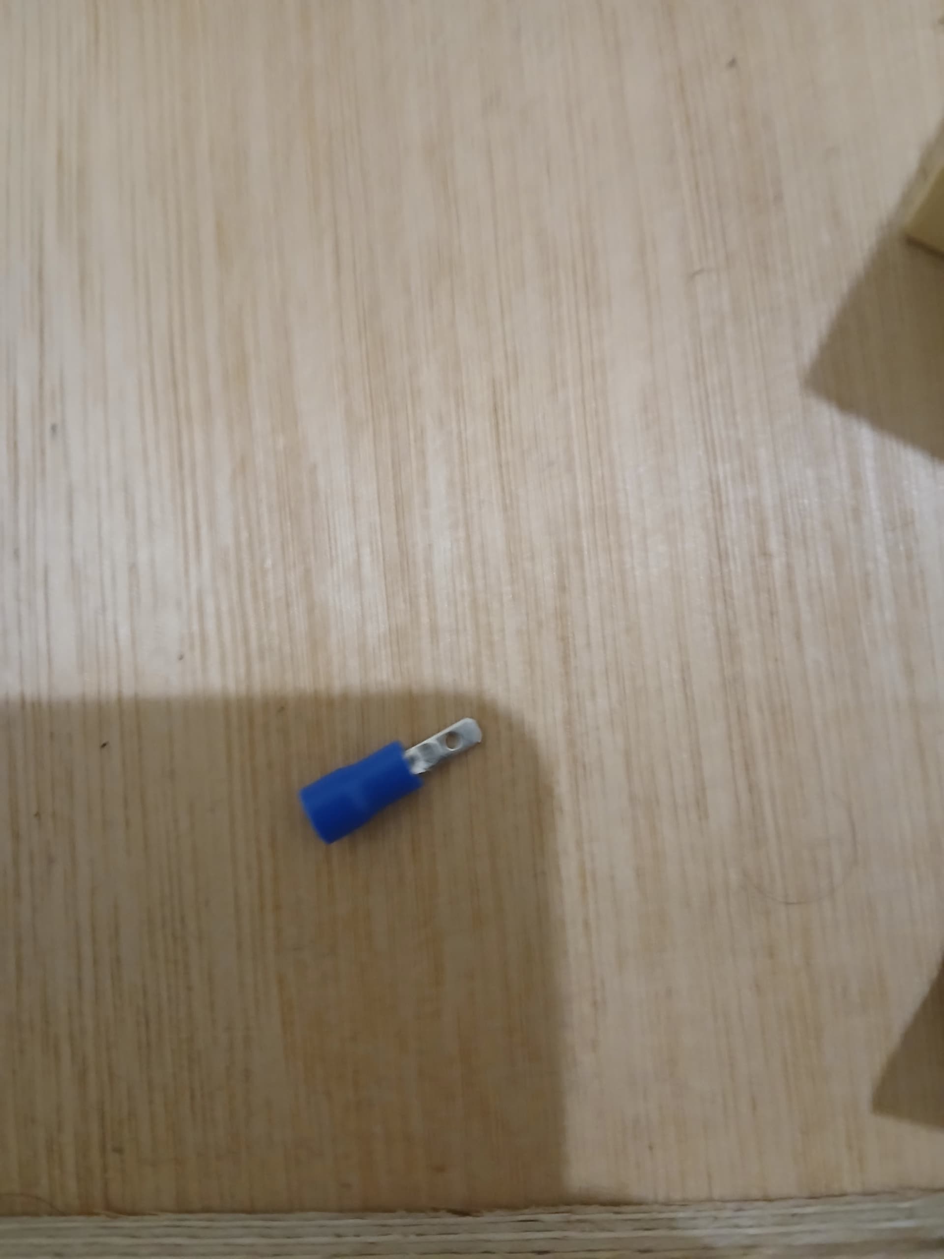

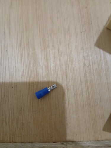

I switched the power supply so i can power the laser and the lowrider from one power supply, i crimped the power cables as a precautionary measure as not to have wires running out the socket. You think it will be alright?
Edit in the config.yaml do i only need to uncomment the laser section and not the pwm section?
Am I also going to need two config files, one for laser and one for router?
Yes, just uncomment the laser section. You only need one config with a router. If you get a spindle, you will need two.
I fully admit it may vary based on the laser and/or spindle, but I run both my laser and spindle from a single config.
It’s trickier, so not the recommended starting point, but it is possible to define both and then select them by sending T0 or T1 to tell the Jackpot which to use. I think this is something that came along with the toolchanger stuff they’re adding.
The crimped connection is great. A few years back I purchased a ferrule kit just for this kind of thing.
