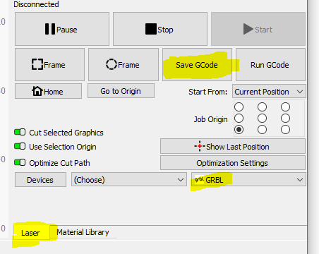

In order to save a Lightburn job to a file, under the laser tab and with the devices set to GRBL, you can click Save GCode to save the job to a file.
Note that you have to set up a GRBL device in order to have GRBL listed under Devices, and the name will be whatever you give it. I just named my device GRBL to distinguish it from my Marlin device.
Note you do gain a few features if you directly connect your computer to Lightburn. One feature is the ability to have the laser frame the work area to make sure you have the laser positioned correctly. Personally, I run all my laser jobs off an SD card using the Save GCode feature of Lightburn.

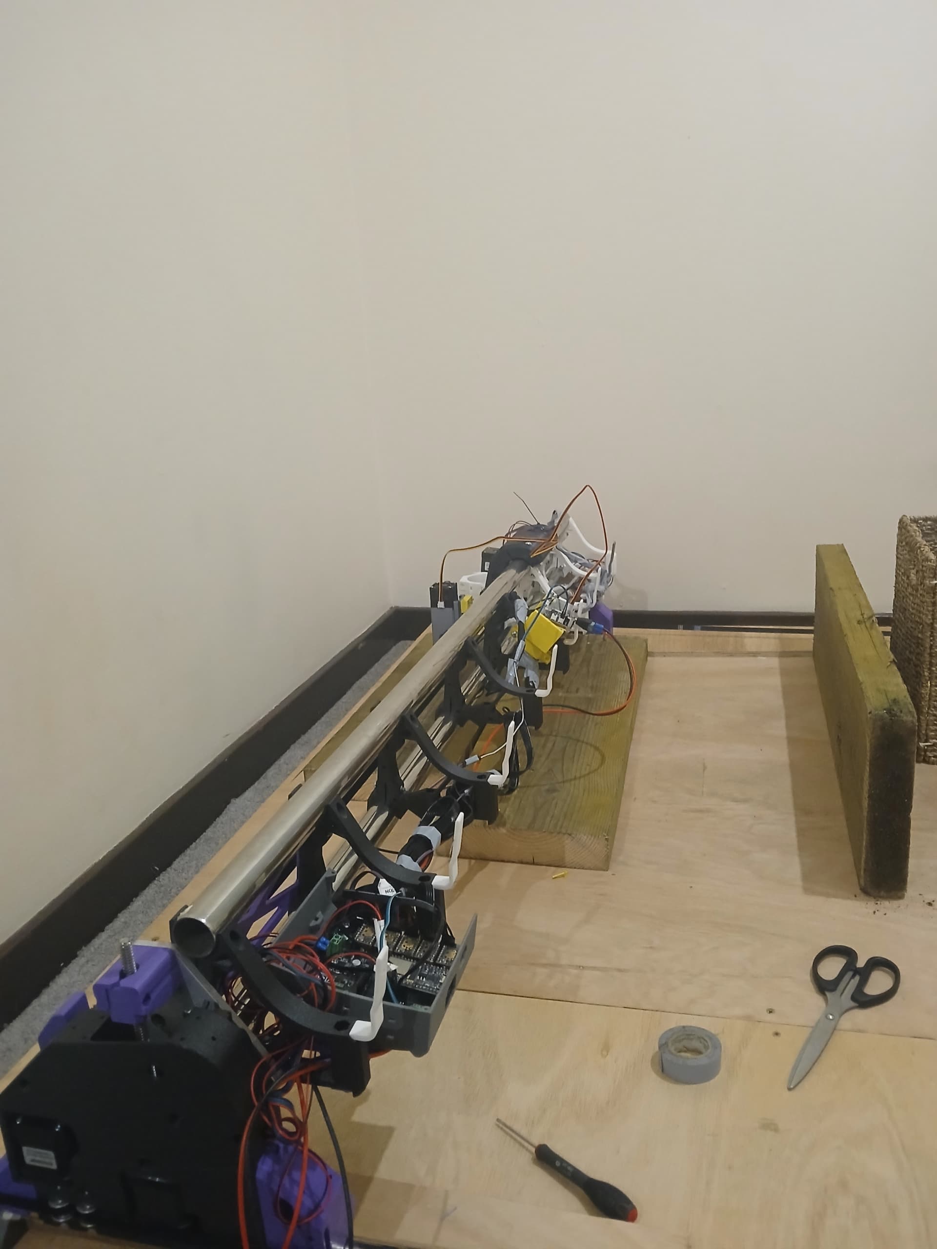

Alright, I finally wired together all the components that everyone suggested. Just a little bit nervous running the first job :grimacing: :sweat_smile: i have all my 3d printers in the same room so definitely dont want to catch fire to anything.
![17415471213591358779047181809366|375x500]
(upload://yc3tvt3sztPe9ndB1HnLgDiWWqO.jpeg)

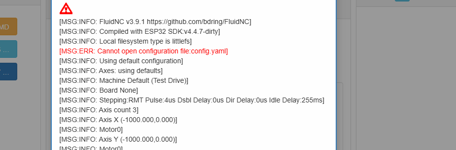

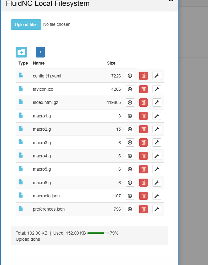

edit I just tried again and this time it said it couldn’t open the config file
is this because there a (1) at the end?
Yes. You can change the system to use a different config file name, but the default is config.yaml
You have a file named config (1).yaml, which is a completely different file name, and won’t work at all.

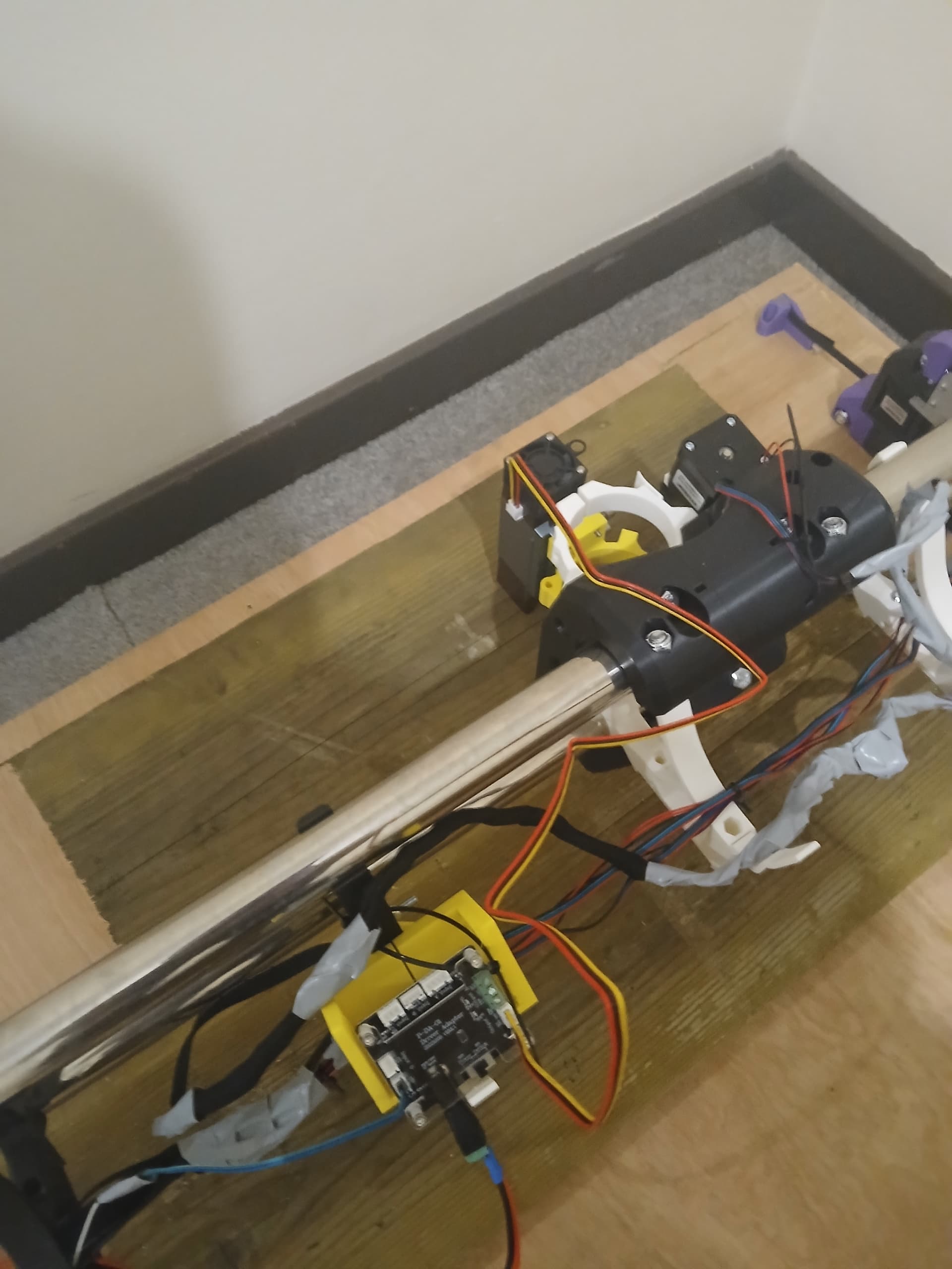

Hi yeah It worked in the end Thanks! What a great little experience :joy: I made some temporary mounts for the laser and a holding box for the driver adapter because there wasn’t any for the v4 and the v3 versions didn’t line up correctly.
