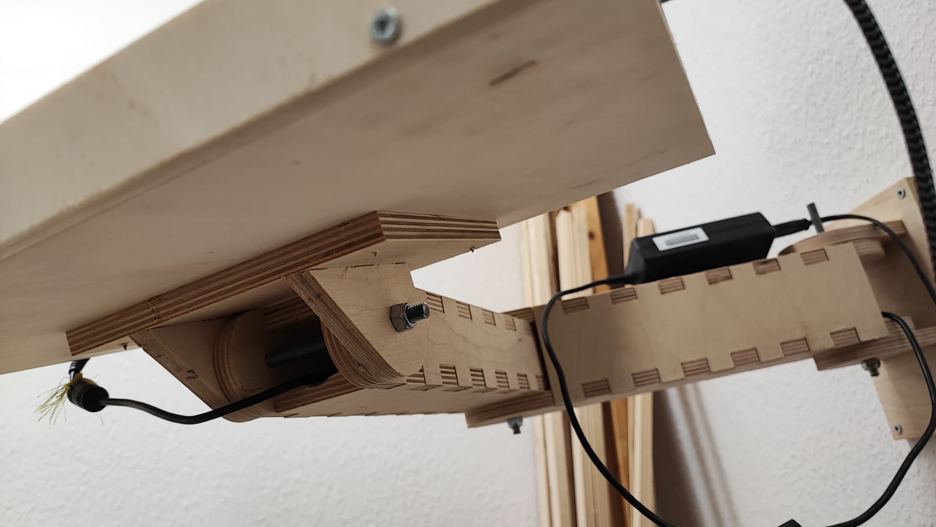

There is the newest project. Added two more pictures.
File here: Laptophalter.dxf (144.9 KB)
