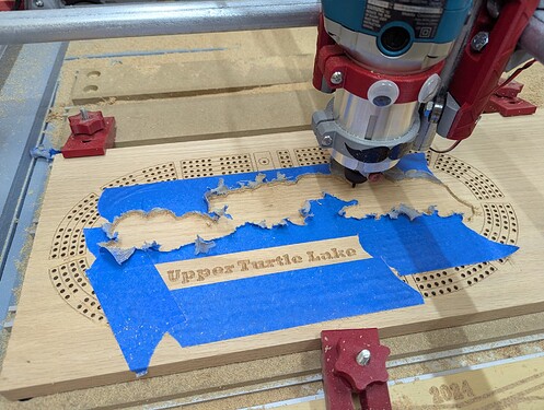

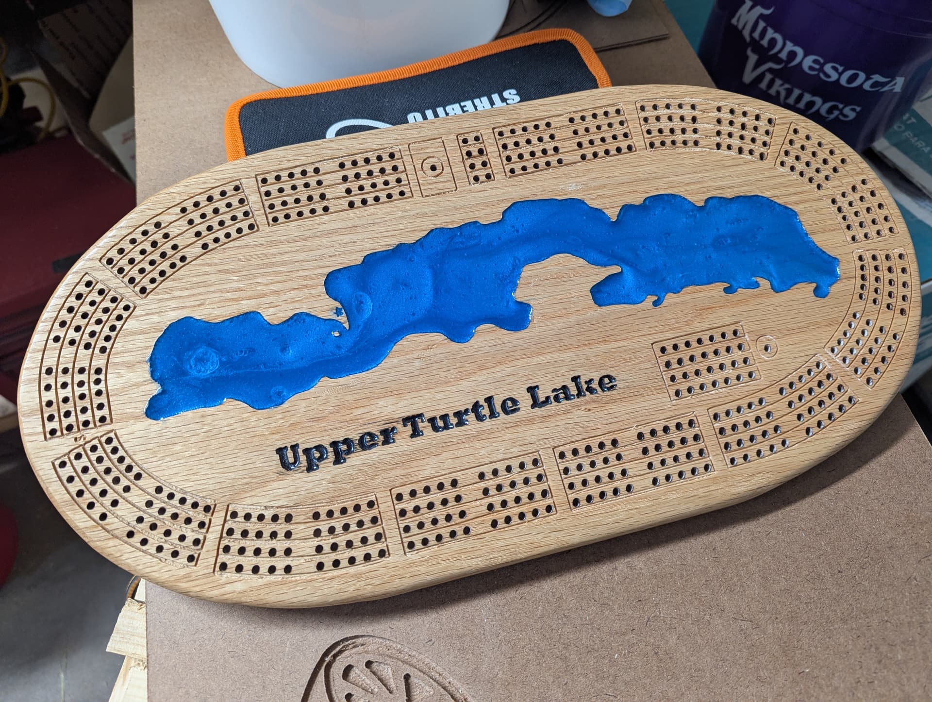

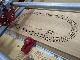

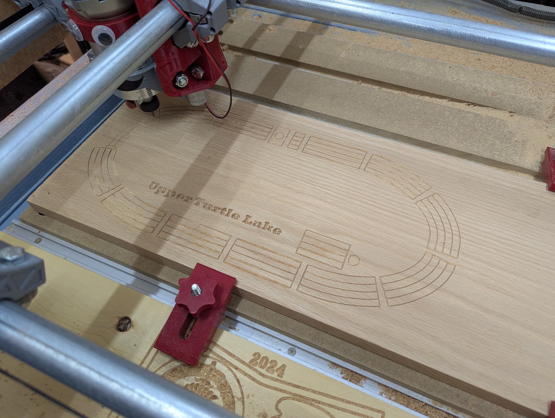

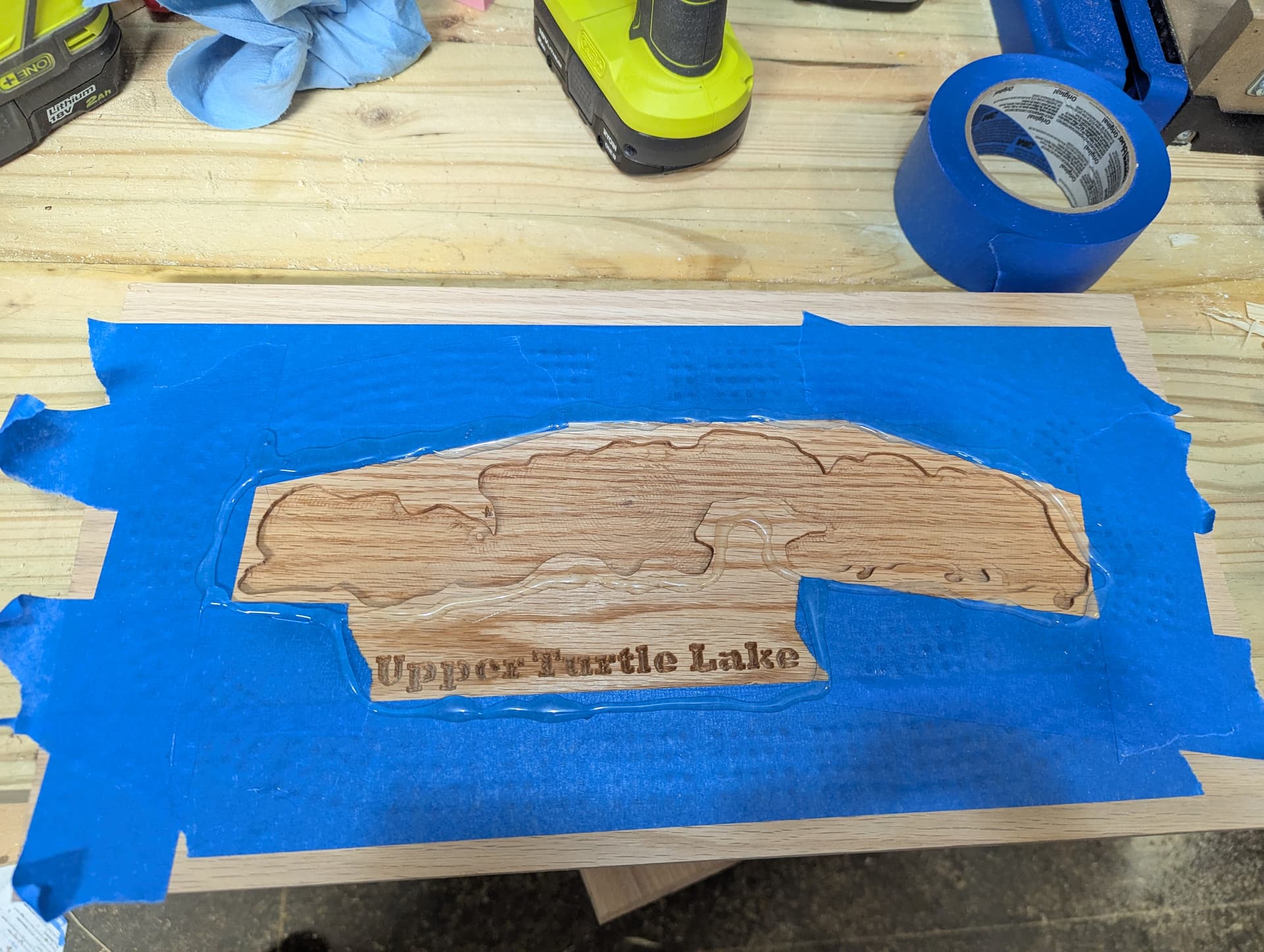

One of my main reasons for wanting to build a CNC was that I loved making cribbage boards but I was sick of drilling hundreds of holes. This is my first cribbage board on my MPCNC and it will be a gift for my dad.

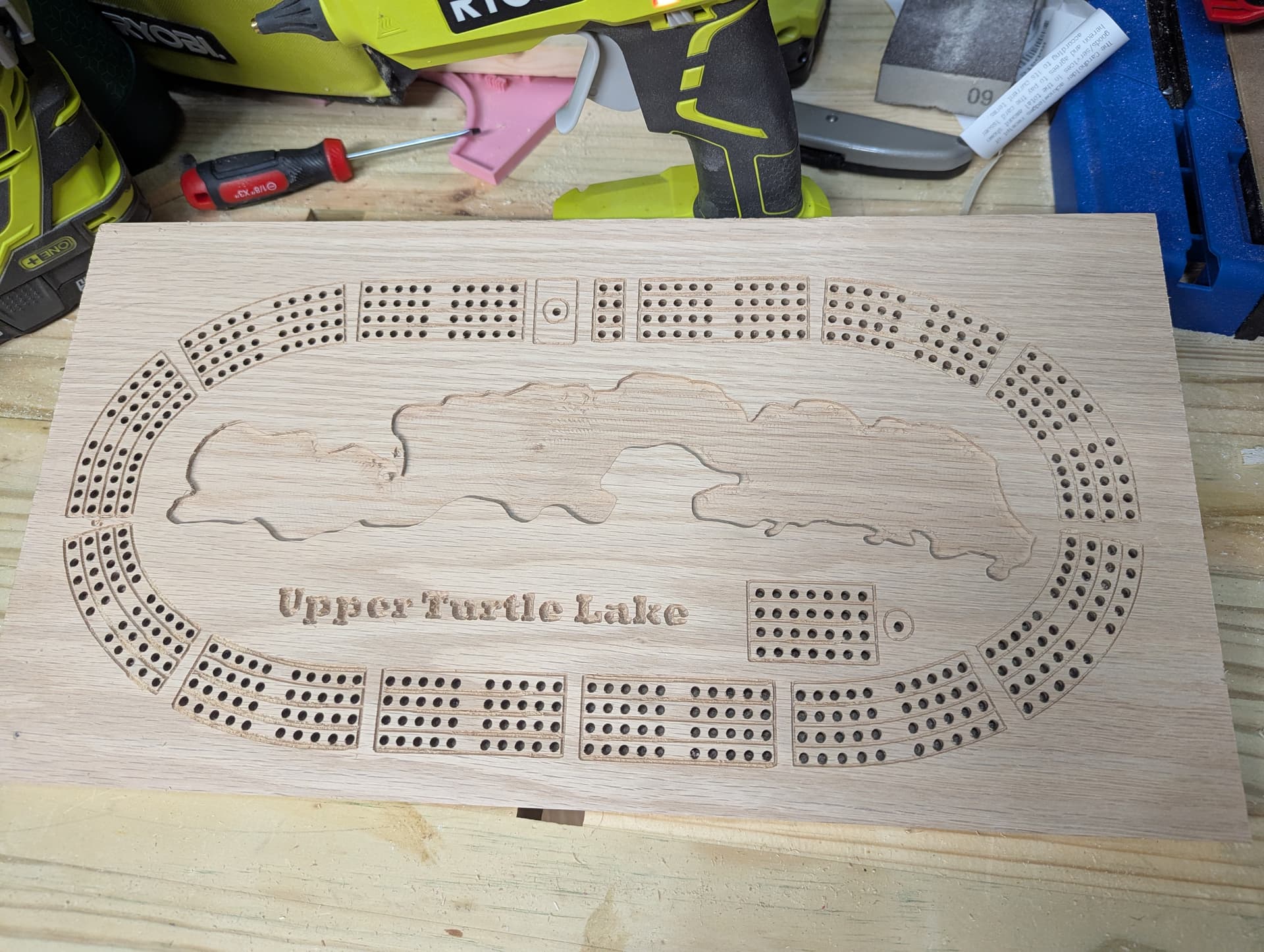

The lake carving made me very nervous as during my first run at this project, my toolpath was off and suddenly the shores of the lake were drastically changed.
This time the lake went very smooth although I was watching it like a hawk the whole time. The blue tape was an experiment that I do not think made a difference or was worth it.
That said I am happy with the result.

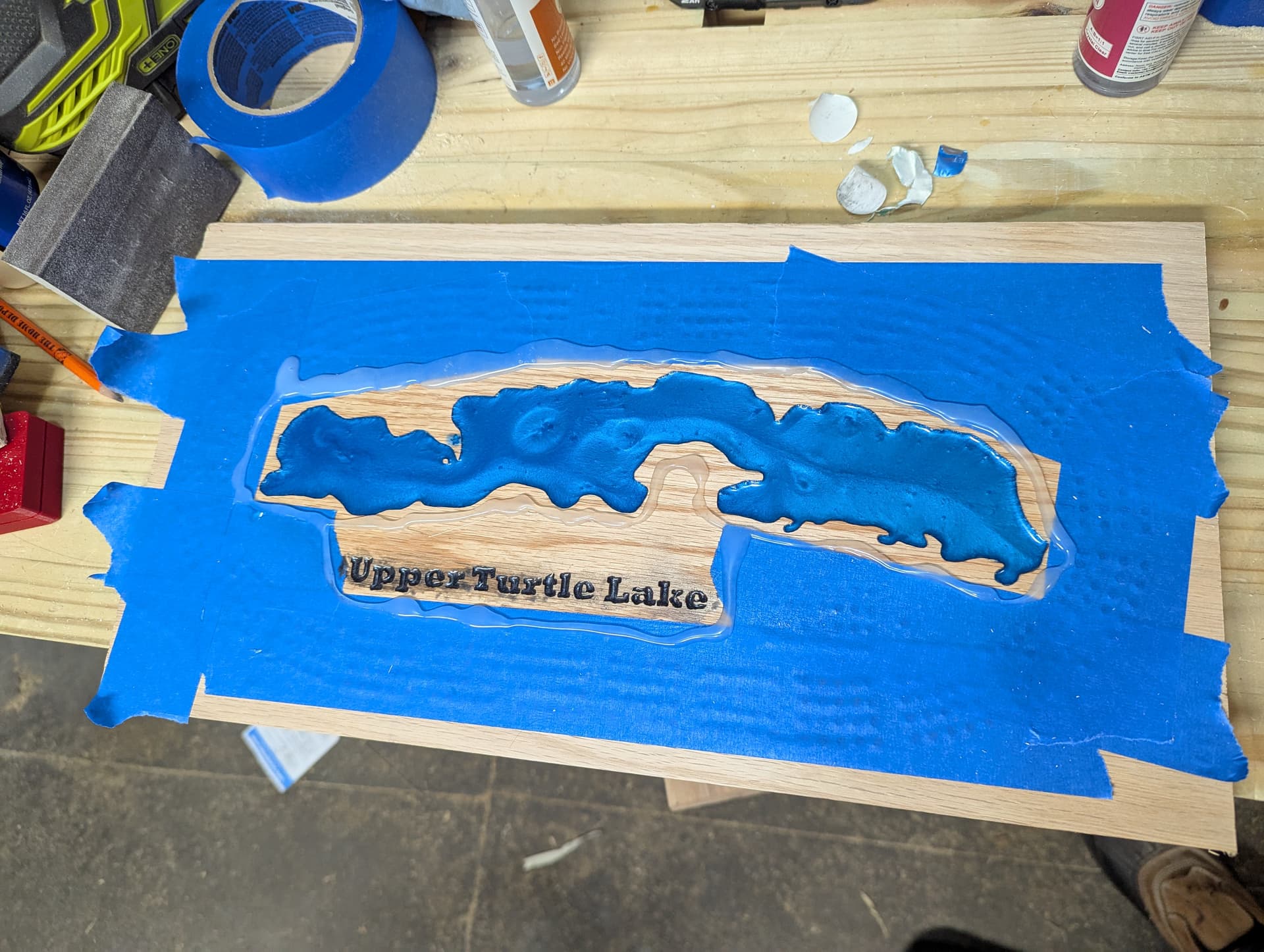

After carving, I prepped the board for resin pouring. I put down fresh blue tape to protect the holes, sprayed a quick coat of lacquer and then made a ring of hot glue to prevent running.
Now that the resin is poured, I need to patiently wait for it to cure and then I will work on cleaning up the edges of the board and putting a finally finish on.

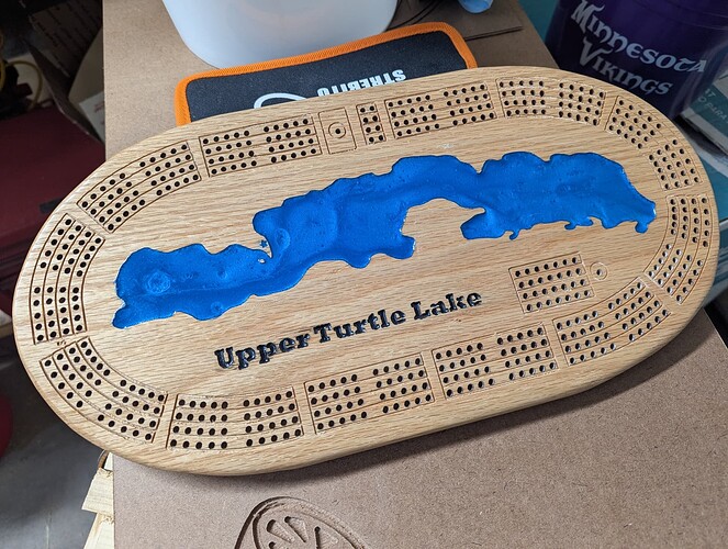

Looks good!
What I can see is that your lines are a bit wobbly, can you check whether the core is tight? It shouldn’t wobble at all on the rails.
This is such a prime example of a CNC project. Drilling all those holes is not fun by hand and getting all of them perfect is extremely difficult, and free handing the lake shape would not be easy. There are not too many one off projects that start to finish faster on a CNC (CAD/CAM time factored in), but this is definitely one of them.

If you do another one you can use the carve function and pocket with the endmill, then it will do the edges with a V bit and you will get extreme shoreline detail if that is something that interests you.
And to take it one step further, get the bathymetry data of thelake and do multiple carve depths. With some semi-translucent epoxy, the deeper cuts will appear darker and near the shore will be a light blue. Time is probably better spent playing cribbage though.
I also used UV resin for the first time. It was super nice applying light for a few minutes and then continuing on with the project. Might be worth experimenting with if you plan on doing epoxy pours more often.
It looks awesome as is, nice job!
After the carving the outlines, I did notice that there was some small movement with my tool mount. I tightened the screws up and that cleared it up for clearing the holes.
Good reminder for checking before starting a job.

This is my first real project with resin and I just used some basic 2 part mix that takes a day to cure. I will need to look into the UV stuff since I have heard good things about it.

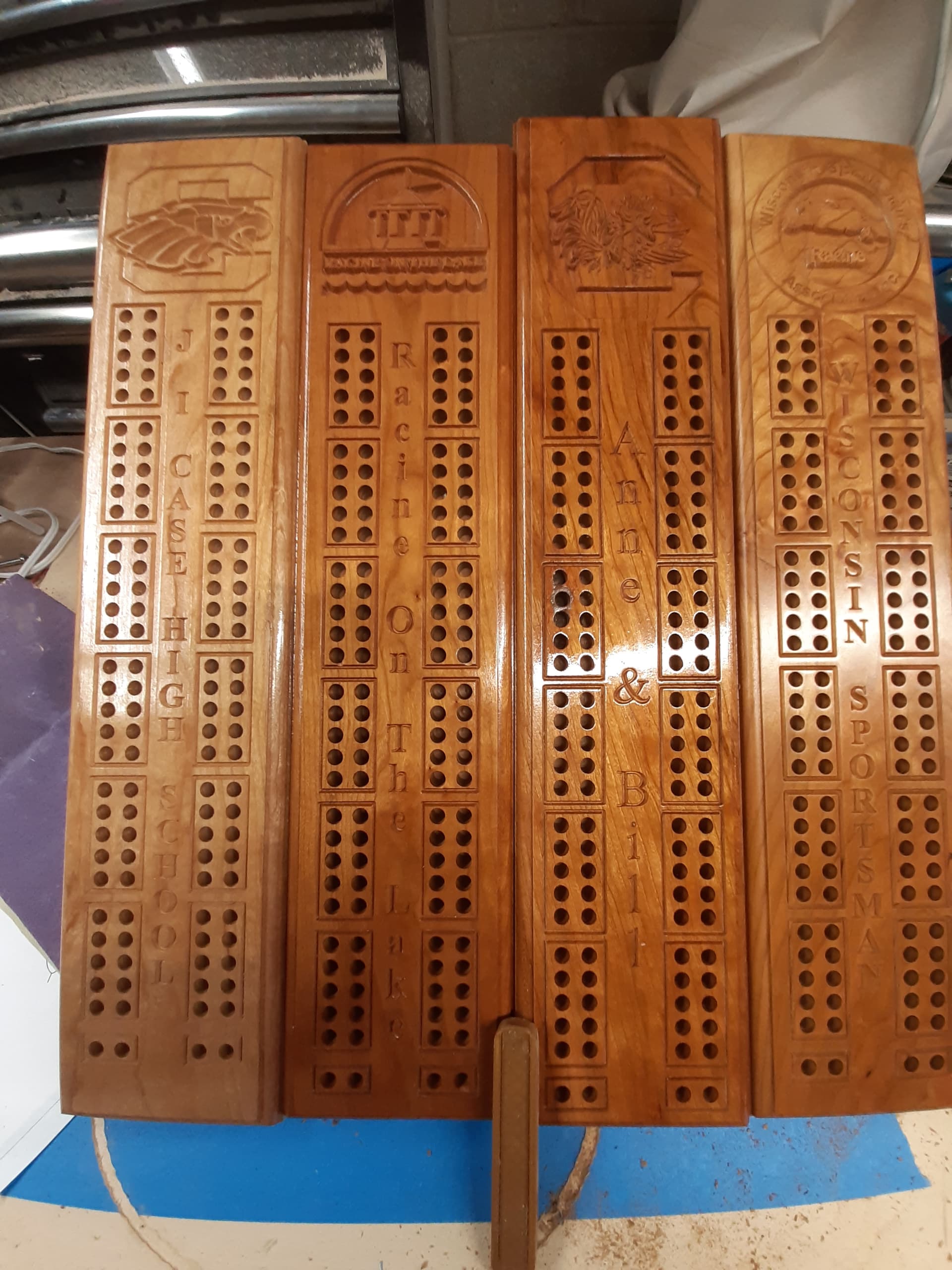

Nice job! What wood are you using? I used oak when i made one and it was challenging. The epoxy went great though and i cheated and laser etched the surface details. Drilling the holes though: Sooo much better with cnc!
It is red oak. Not the most fancy but it is one of my favorite species to work with. I like how well it takes finish. A few years back I made my bed out red oak and red oak plywood.
I would not count that as cheating in my book. Someday when I pick up a laser module, I will probably switch to that for the details too.
1/4 inch holes for pegs for the elder sighted and refex impaired. This was the reason for my getting into this chaos also. Best thing i ever did :grin:

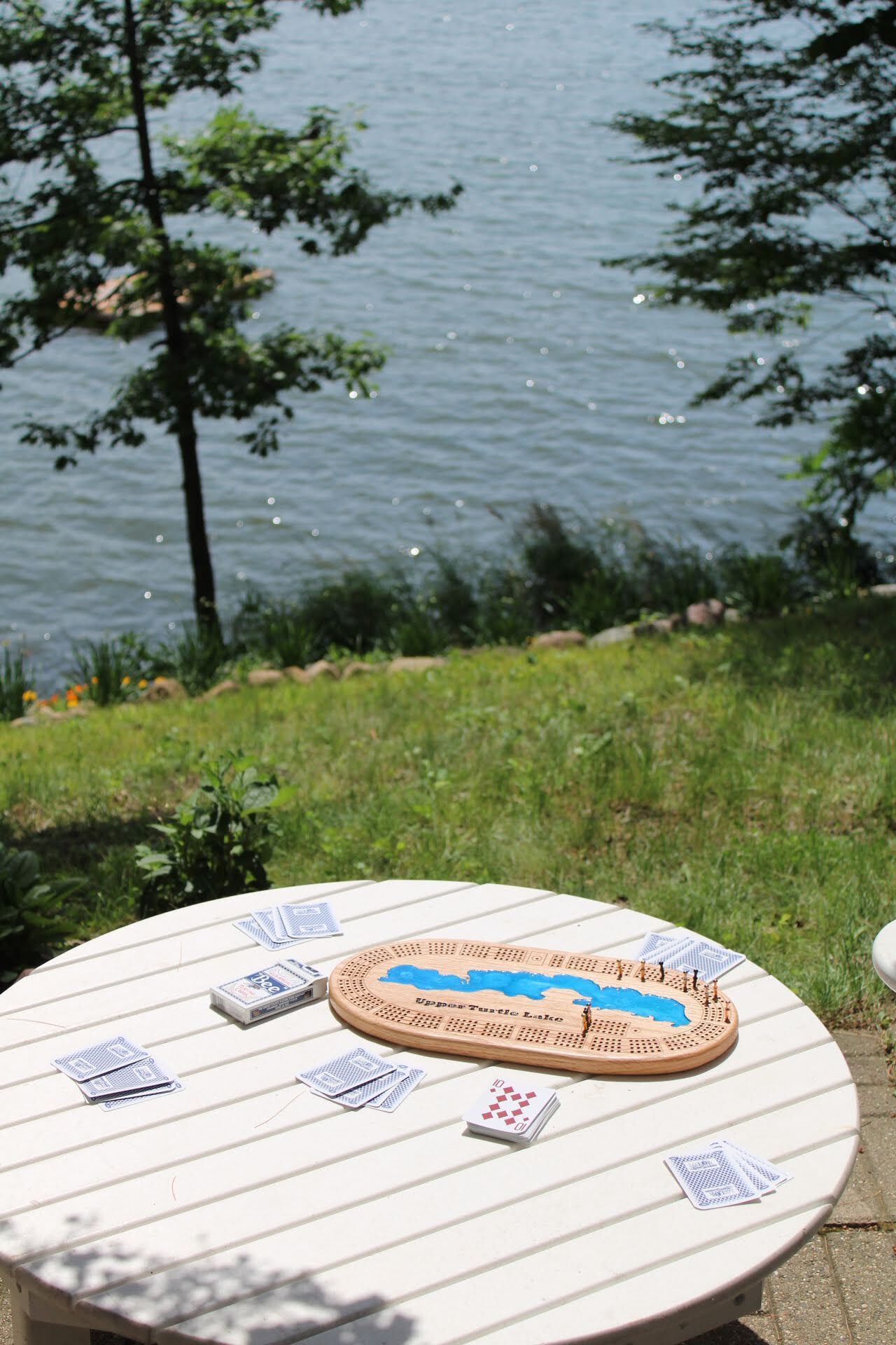

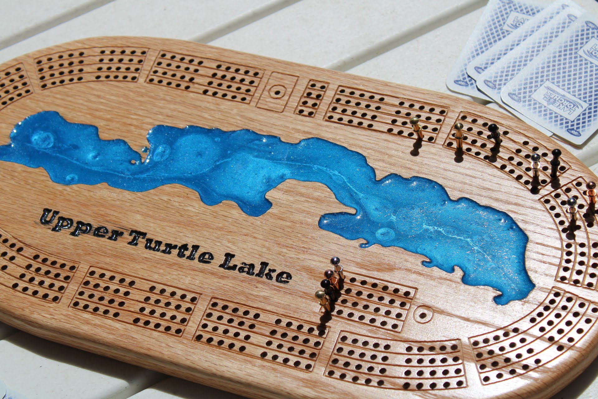

A bit of a delay but I wanted to report back with the final results.
Over the last weekend, my family traveled to the lake on the board for a weekend of fun.
Overall the epoxy turned out really well. There was a little bit of bleeding around the letters but the lake looks fantastic.
The lake surface was blended slightly to give a non-homogeneous look like a lake should have.
The mica powder that I used to dye the resin has just enough metallic in it that it really sparkled in the sun. The picture, here does not do it justice.
The board was well received by my father and I foresee making more cribbage boards in the future.
