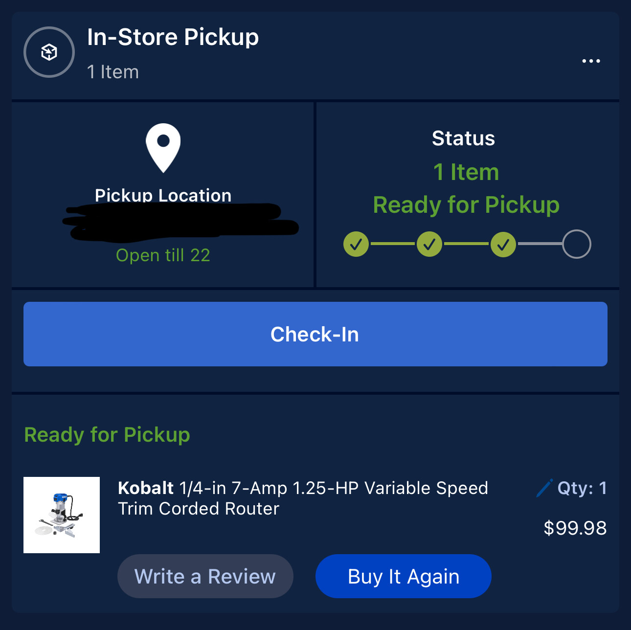

Well… I went twice over the weekend. Isle 59 bay 13 at my local big blue box store is indeed where the trim routers live. But none were present. Over the weekend no one knew where to find it.
Late this evening I headed in figuring there would be some folks with time on their hands. Indeed there was.
The first guy looked it up by item number in the little in store phone tablet thing. It told him to look in aisle 5, bay 2. (That’s where this particular Lowes has blinds.). Not there.
Then the 2nd guy looked it up in his store phone, and realized it wasn’t floor isle 5 bay 2, but rather receiving isle 5, bay two. The two headed off somewhere into the bowels of the store and returned about 10 minutes later, having gone all the way to the top of somewhere way out of the way, and extracted one for me from a box of multiple.
Here’s a picture just before I headed through the checkout.

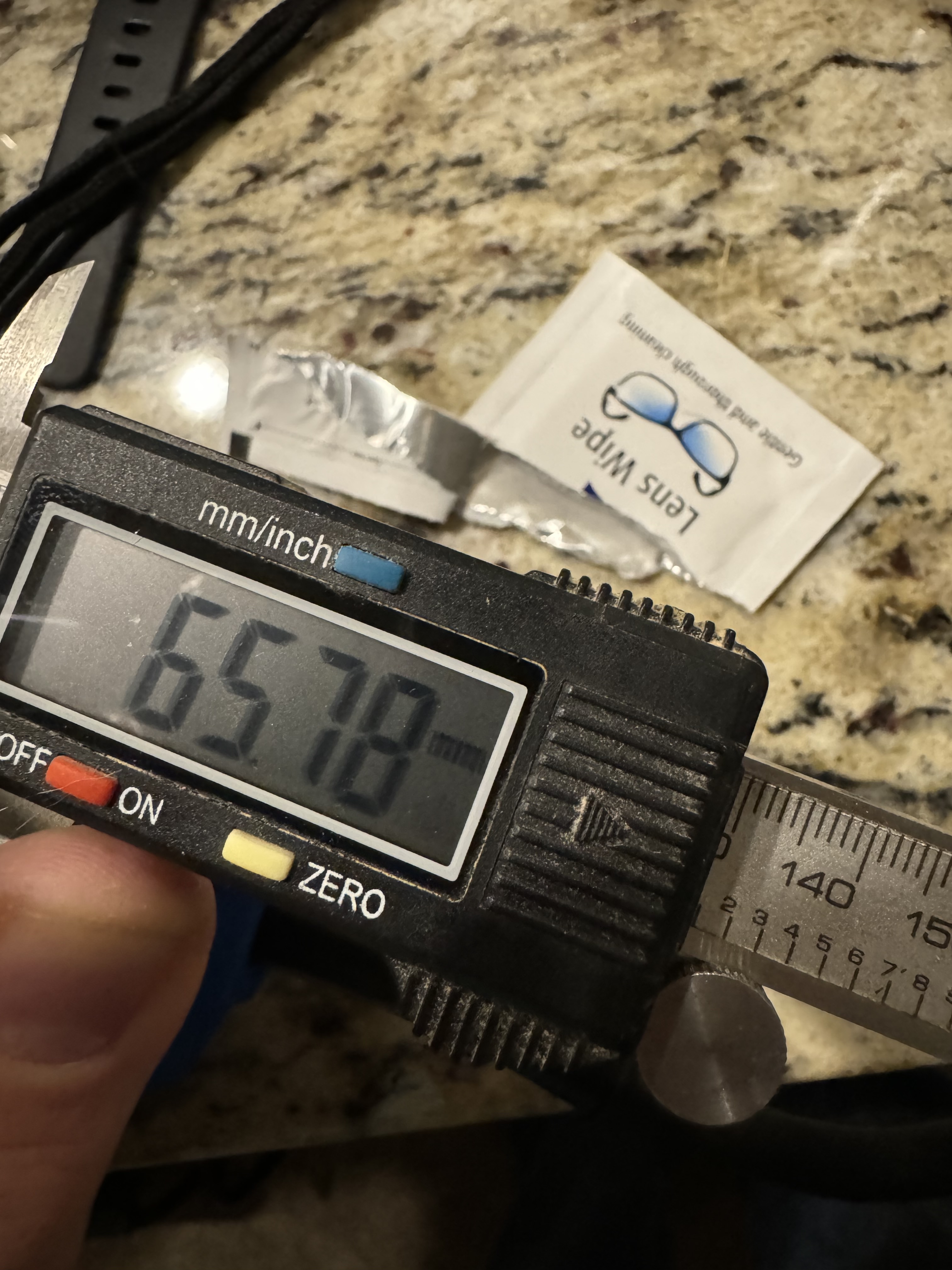

Calipers have a hard time reaching but I’ve got 65.58-65.78 depending on where I grab it. The base detached but clamped shut I’m getting 65.8 almost consistently
Correction. Tried getting the router measurement differently. Consistent 65.72-65.78 more what I expect
65.75 was what someone else reported.
I’m guessing my variance is I’m just slightly tilting it or again how my calipers barely fit around it. 65.75 is my average after rezeroing

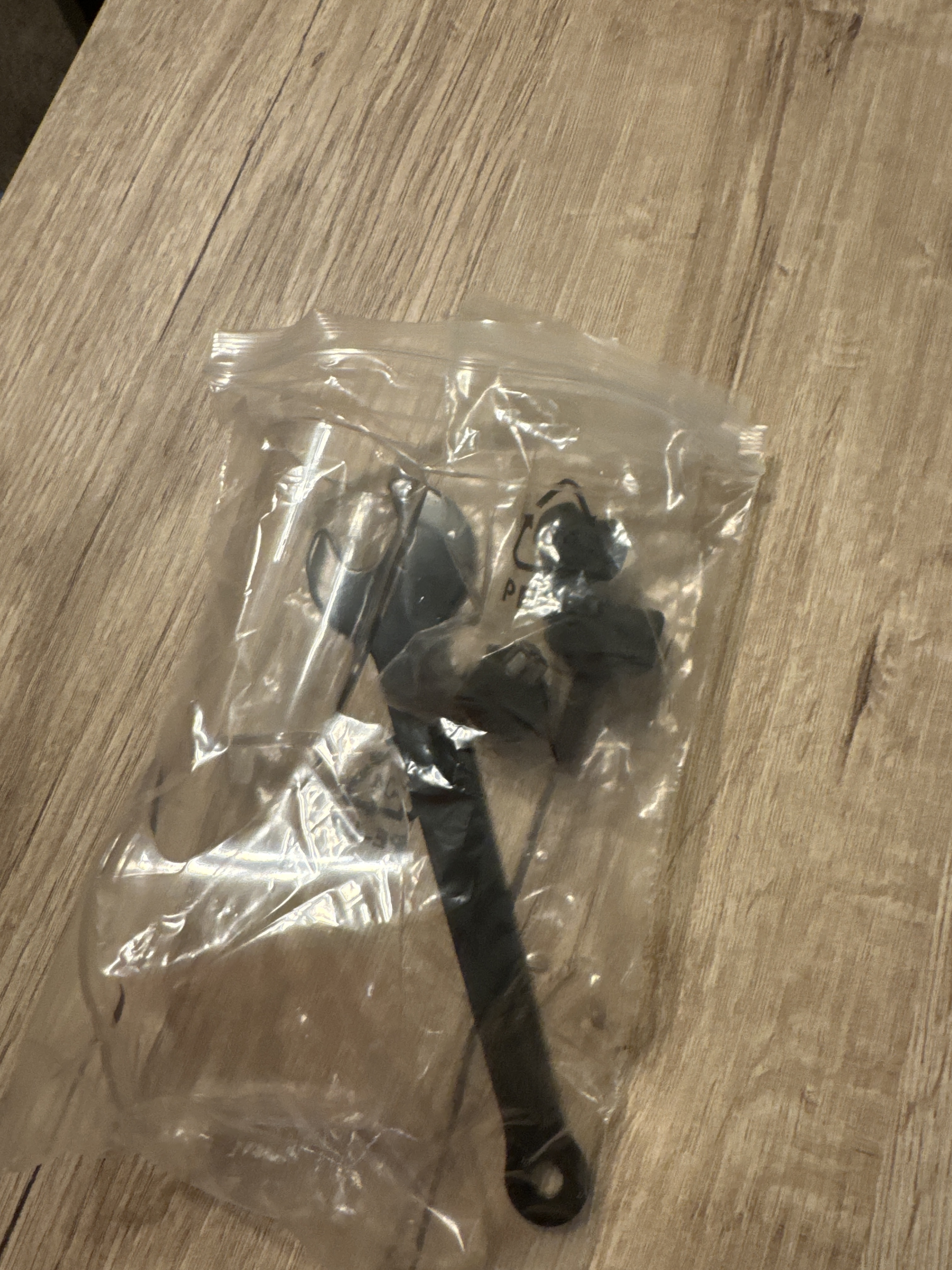

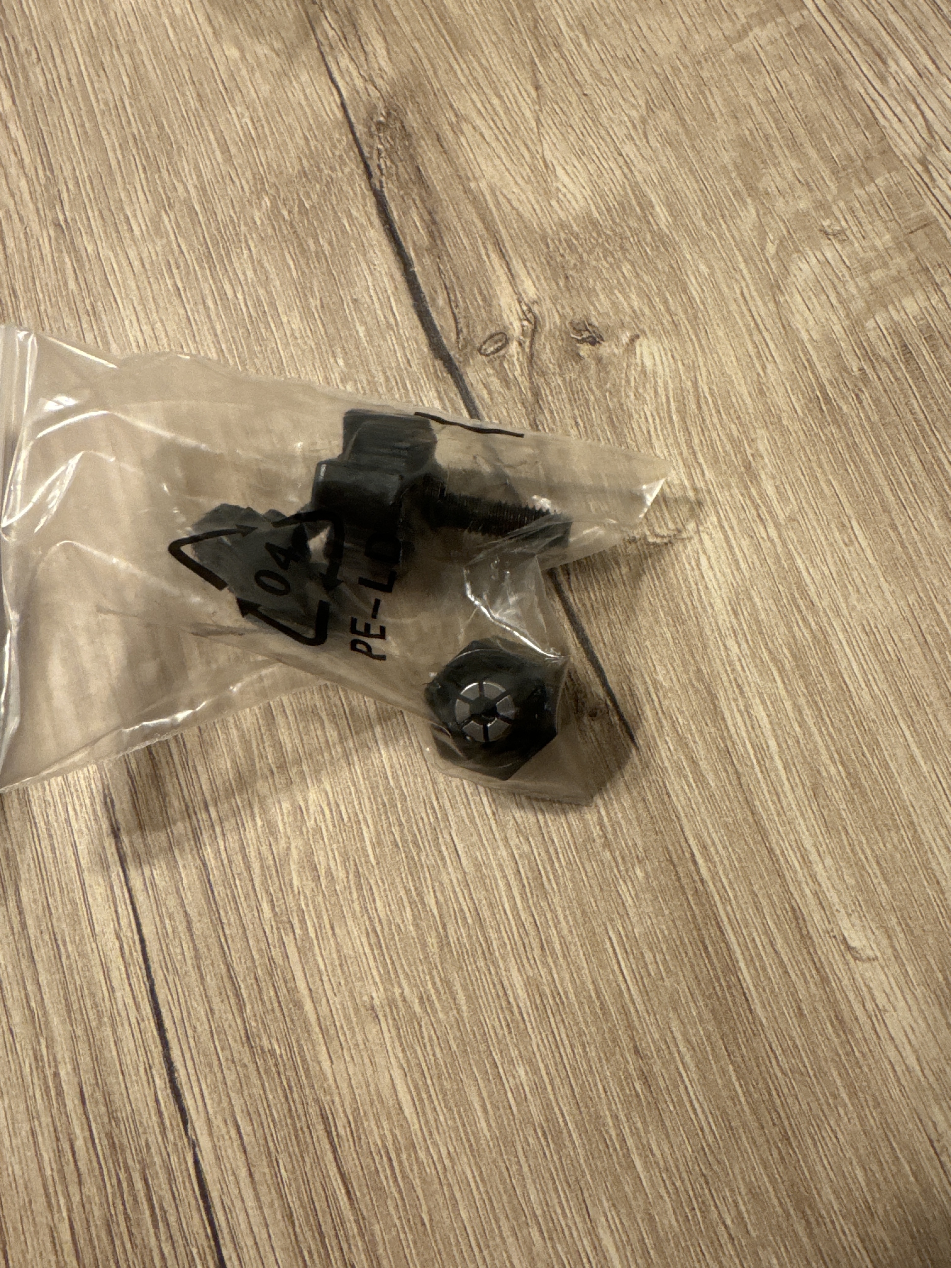

Hmmm. Mine only had a 1/4" collet. I bought some 1/8" ER11 collets and an ER11A collet nut, but it doesn’t fit. Bummer. I can’t seem to pop the 1/4" collets out of the nuts either.
Mine had the 1/8 collet in the parts bag with its own nuts. Hole on gonna grab a photo
Mine did too. Exactly like that.
And that bag of parts was carefully hidden along one side of the box!
I was just about to throw my box away when they fell out!
