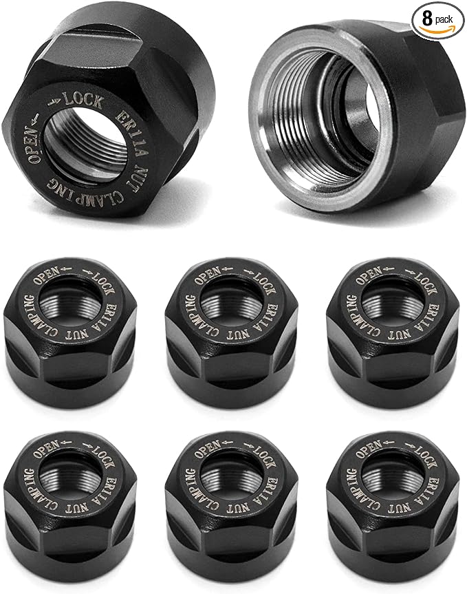

Any idea of the specific collet nut required? I got some ER-11 collets but not a nut yet. Seem to recall Doug using them so need to dig around…
Perhaps a silly question - but given the “so near and yet so far” nature of the Kobalt exercise - is it time to pursue a manufacturer for a “branded” spindle?
Here are some pics of the one off my Rocky. Threads and seats perfectly on the Kobalt.
I’m by no means an authoritative source, but my take is that if it’s labeled as an ER11 nut, it should fit.
I see! Tons of them (ER-11A collet nuts) on amazon etc. for cheap.Thanks for the heads up, I’ll order one now!
Was nice being able to dust off and use a 15pc set of metric ER11 compatible collets I’d originally purchased and used on my 1st CNC (Genmitsu ProVer 3040). Bought the 15pc set for not much more than I paid for one Makita collet.
I ordered these ER11 collets and these ER11-A collet nuts and they work together with the Kobalt!
https://amzn.to/49mN52f
https://amzn.to/487P9tR
