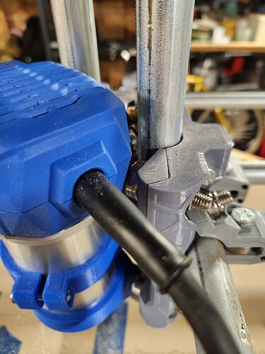

just mounted in my mpcnc, it is hitting on the bearings for my z pipes. Anyone have any pics of how they mounted theirs? Mine is sideways, but hits the bearings, tried turning so switch was towards z pipes, but still hits.
P.s. check out the color match on those brackets :slight_smile:
did it work? my mpcnc is hitting the bearings
Actually Yours looks different. I am going to try yours. i thought the ones above were the same, but maybe not.
Is that mine (I can’t see the distinguishing marks I added)? Mine fits sideways or the way you show it. I think I had to move it out 7-8mm to get it right.
No they were dans. I thought he had yours.

I had to get a new mount printed to move the router out so the electronics clear the bearings on the MPCNC. While the makita could be opened up wide enough to fit the body, it didn’t have the back side clearance against the core to clear when plunging.
This is the new mount Ryan drew for the Kobalt to move it out so it won’t hit the bearings. Is that the one you printed?
Weird. Mine fits, but it isn’t the retail version of the router. Maybe something in the head shape changed?
Best use Ryan’s parts.
Nope, i printed Dans above. I am printing ryans now. And then I need to update my pic on the make i posted :wink:
