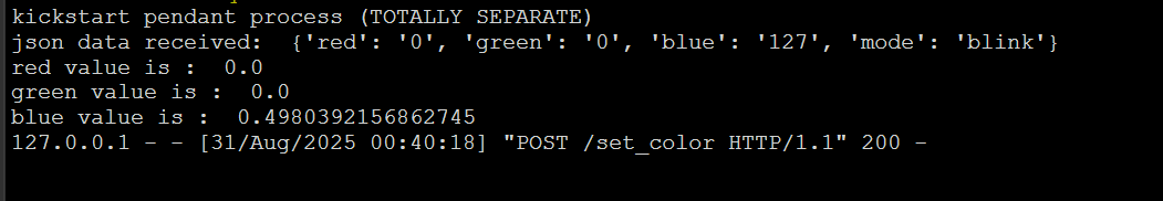

To start the connect process, the macro in klipper does a curl http post command to the nearby raspberry pi zero. The raspberry pi zero is running a python flask server on port 5000 that accepts the post and indicates its status with a tricolor LED.
what you are seeing is the crowsnest camera mounted over my LR4 which I filmed from another room - but before you go all fireman on my post, I’m not running the spindle from the other room, just testing colors from the couch. the LED program and wii pairing were done manually from 2 ssh terminals. one for LED and one for sending the curl command:
curl -X POST -H “Content-Type: application/json” -d ‘{“red”: 0, “green”: 1, “blue”: 0}’ http://localhost:5000/enable_pendant

  2. when certain commands are sent from the pendant, the led will change color or pulse or blink. This works partially, but all of the commands are not yet input and colors have not yet been assigned.

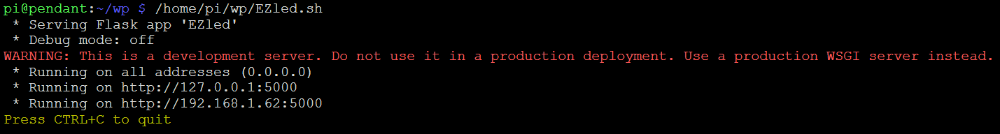

The issues: it has been challenging to get the right program structure to make this all work in a seamless simple way. On the zero, I’m using the python cwiid library and it connects to bluetooth when you instantiate the controller object, so I have that run as a subprocess from the led code that I’m trying to run as a service on the zero. If I manually start the led code, it works.
When I can send the curl command from the zero locally or from the klipper macro button and it will start the wii subprocess and pair with the remote. Whenever I try to run the same code from a service at boot, it fails.
Aug 30 23:46:34 pendant (EZled.sh)[630]: EZled.service: Failed at step EXEC spawning /home/pi/wp/EZled.sh: Exec format error
Aug 30 23:46:34 pendant systemd[1]: Started EZled.service - EZ LED daemon.
Aug 30 23:46:34 pendant systemd[1]: EZled.service: Main process exited, code=exited, status=203/EXEC
Aug 30 23:46:34 pendant systemd[1]: EZled.service: Failed with result 'exit-code'.

Edited service file with suggestions from below
This should be #!/bin/bash. It doesn’t know to run this .sh in bash. When you run from the terminal, you are running it in a shell, which is bash.
Threading is a complex question. Ideally, yes, thing that are orthogonal should be running asynchronously. As for what to do when the BT controller isn’t there, is there a way to ask cwiid if the controller is there and just poll (in a thread) for the controller?
+1 for the shebang. That was part of it. The other part was the restart specified in the .service file. has to be “no” or “always” or one of the allowed states, but “never” doesn’t work. the journal and status now say running, but the curl connection is rejected, so closer, but not quite there.
after some iteration, I got the code all put in one program.
The base code is a flask server starts a thread that idles (rather than a subprocess) until a pair command is given and then it instantiates the wii object and can connect with the remote and communicate with klipper. Was simpler than I anticipated… just moved the subprocess code to the thread code. This solves the klipper or post pairing delay. Still need to figure out the auto pairing.

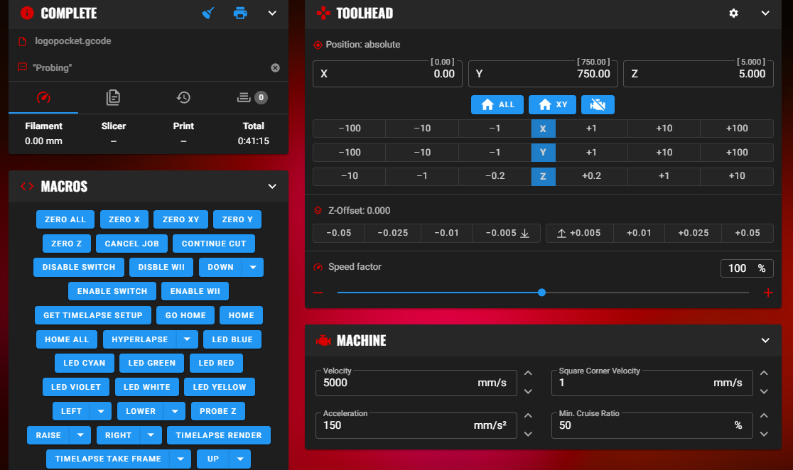

LR4 runs klipper firmware
Pendant connection is raspberry pi zero bluetooth to either or both:
  • Wii remote
  • Switch Pro Controller
The raspberry pi zero runs a python script to read the connect button input, gather x,y,z position from klipper to display on the small oled screen, set the indication led, and communicate with the controller.

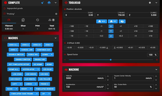

klipper is the firmware engine that moves motors, runs heaters, from reading gcode. I told klipper in the printer.cfg file to move my CNC and didn’t give it a heated bed or an extruder, so klipper thinks it is a printer and still shows some printer indications in the mainsail interface, but it can run motors for a CNC. Since the mainsail front end on the web talks to moonraker (communication interface) that then tells klipper what to do, I had the bluetooth device send commands to moonraker over the network connection. That command interface is all documented to connect and control via HTTP POST commands. I just figured out how to get the switch controller via bluetooth at the same time I’m asking moonraker for position. It took a while and isn’t perfect yet. Still some unexplained disconnections, but it works for the most part. the controller buttons are read by a python script that then interprets various button combinations that call macros in the klipper config file that I defined. They show up as buttons on the web page (see below buttons on the left) so you can test them before you have the controller run them:
