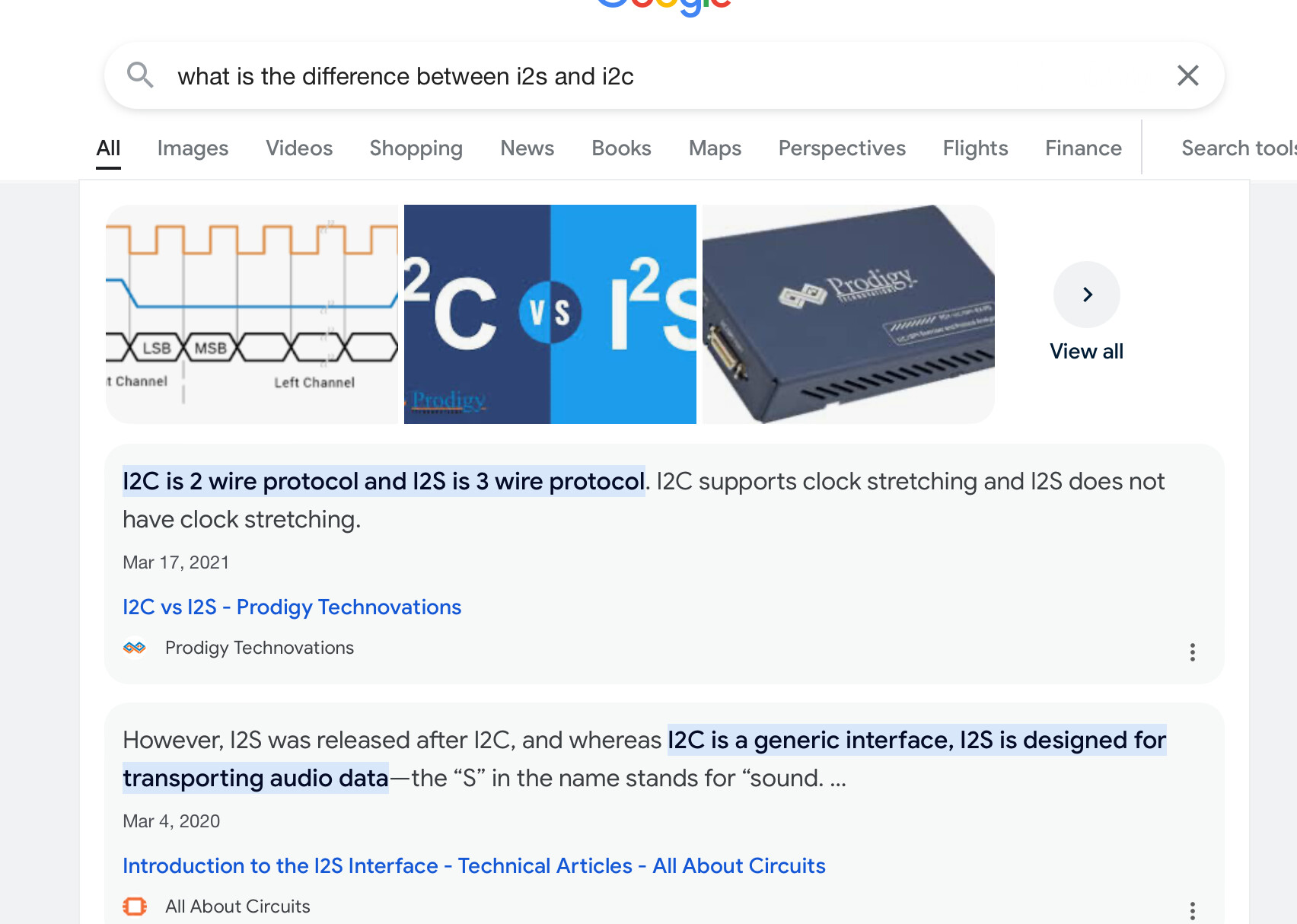

I’m worried about the next part. I figured out what the ws pin is, that’s an i2s communication not i2c. I2s is 3 wire, i2c is 2…. Off to research more
stumbled on this…I2C/SPI GPIO expander support? - Features - Klipper
Yeah it seems i2c expanders are good to go. But from looking at the jackpot it uses an i2s expander. That’s where the 3rd pin comes in and I haven’t found a way to make that work in kipper yet. Now I know nothing about i2s so can it run without the 3rd pin? Something says I doubt it but I really don’t know. Trying to read as fast as I can lol

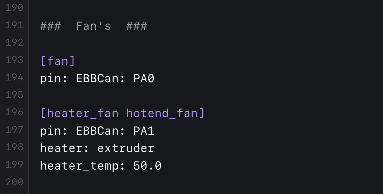

I can’t figure out what to use as a section header. maybe 2 will do it?
[fan] doesn’t work :rofl:
https://www.klipper3d.org/Config_Reference.html
This page lists them all from top to bottom lol
But don’t add any heaters or thermistors yet. Once you do it will trip error till it sees the thermistor
That should work. That’s how I have my part cooling fan…

Don’t disagree. And it’s all well above my pay grade lol. I was just looking for anything that could be helpful to Ryan trying to get it setup. I knew klipper had support for i2c but I kept seeing i2s in the jackpot info. That was throwing me off so I went searching. That 3rd needed pin is where the issue with klipper is going to be I think. It might be something simple as just adding it in there but I doubt it. The hardware can run it fine. But getting klipper to control it is going to be the hard part. I searched around the klipper forum last night and couldn’t find much about i2s and what I did find was all for screens and stuff. Hopefully it’s something simple that I just don’t know about or how to search for
