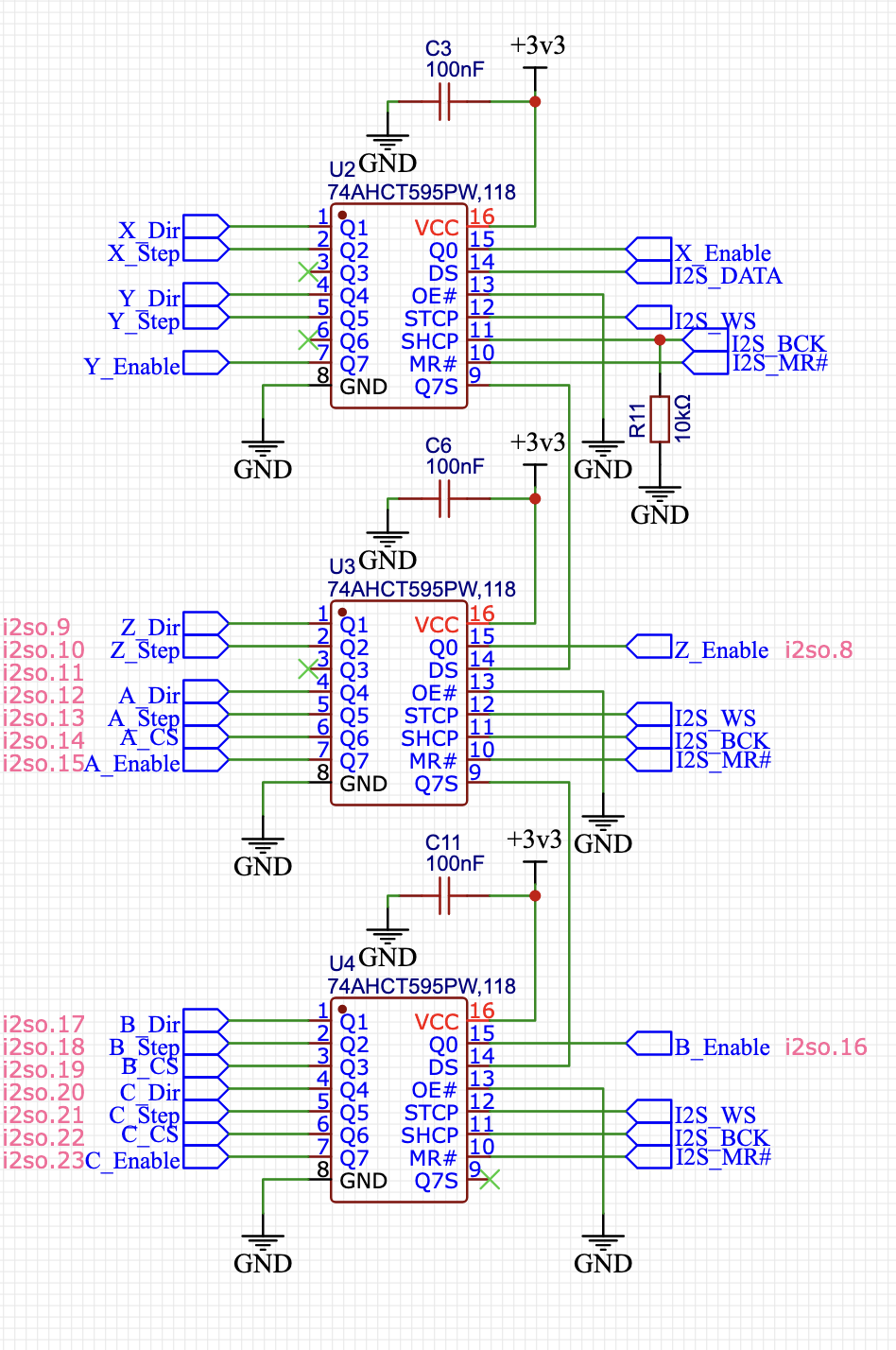

No, all 6 use the same UART interface. Three are direct, three use a gate to switch the UART to the TMC.
But ALL of the enable/step/direction IO goes through a shift register based GPIO expander.
The uniqe parts are the shfit register expander, and then the gate control for the three stepper drivers that use it.
Without the expansion, NONE of the TMCs will be usable for motion.

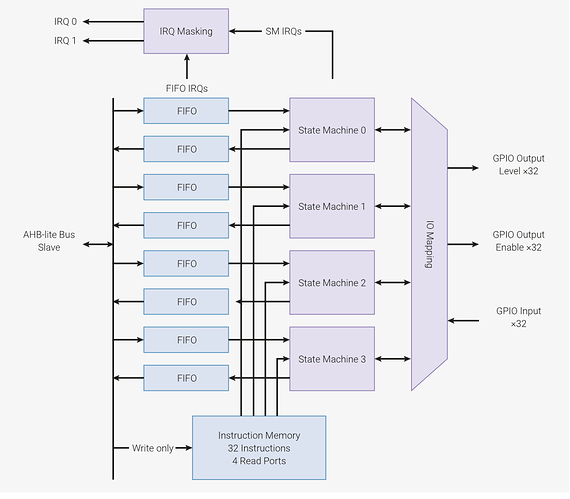

PIO implementation of the GPIO expander. It should be possible, note the following from the RPi documentation
The programmable input/output block (PIO) is a versatile hardware interface. It can support a variety of IO standards,
including:
• 8080 and 6800 parallel bus
• I2C
• 3-pin I2S
• SDIO
• SPI, DSPI, QSPI
• UART
• DVI or VGA (via resistor DAC)

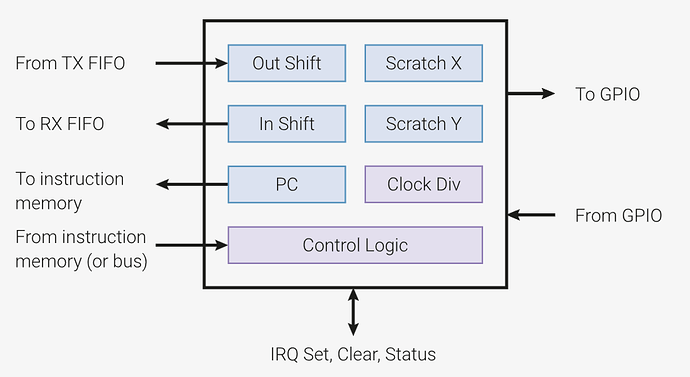

PIO is programmable in the same sense as a processor. There are two PIO blocks with four state machines each, that
can independently execute sequential programs to manipulate GPIOs and transfer data. Unlike a general purpose
processor, PIO state machines are highly specialised for IO, with a focus on determinism, precise timing, and close
integration with fixed-function hardware. Each state machine is equipped with:
• Two 32-bit shift registers – either direction, any shift count
• Two 32-bit scratch registers
• 4×32-bit bus FIFO in each direction (TX/RX), reconfigurable as 8×32 in a single direction
• Fractional clock divider (16 integer, 8 fractional bits)

The implementation of the GPIO expander on the Jackpot has to use the native interface of the shift register ICs. Those use I2S WS and BCK signals (MR# is just pulled high on the Jackpot, so you only need those two signals.)
None of that looks like SPI to me.
Looking at the chips it doesn’t mention any protocol, just that it needs 3 pins. Nexperia 74AHCT595PW,118 Datasheet
So we can’t use just spi to the chips instead of having the pico convert spi to i2s first?
I guess, It sounds like you are saying the pico can’t run spi and usb at the same time? So it doesn’t matter if the chips can’t off SPI?
At the most basic level I am just seeing spi and i2s only differ by how they use the clock signal.

That implementation would need to manage the bit-banging of the 6 stepper drivers’ EN/DIR/STEP signals which are interleaved in the 3x 8bit shift registers.
