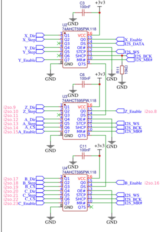

Looking at the Jackpot Schematic, there are three 8 bit shift registers 74AHCT595PW,118 datasheet. They control step, dir, enable for X, Y, Z, A, B, and a few things related to the TMC UARTs. The inputs (DS on U2) are labelled I2S, but these are regular shift registers. You set DS to the value to want to add in, toggle the SHCP (clock) and the shift register saves that. The Serial Output (Q7S) from U2 is the Serial Input (DS) on U3, etc. So to set all three registers, you need 8x3=24 clock cycles. Once they are set, you output all of them at once using STCP. That is some of reading the datasheet, and some memory, so I may have some of it wrong. I don’t know I2S well, but I don’t think that is how I2S works, so I assume those are just the wrong labels.
In the klipper firmware, any time any of the stepper GPIO (en, dir, or especially step) need to toggle, all 24 registers need to be written out.
The klipper firmware is trying to be very tight in stepping (understandably). I think this is one place we could inject our own step gpio command:
gpio_out_toggle_noirq certainly sounds like it is toggling that output right-freakin-now and won’t wait for some interrupt. If we replaced that with the shift register routine, we could step there and we would get motion.
We would have to have a copy of what all the outputs should be in our own 24bits of memory, and when gpio_out was called, update our little memory and then flush the 24 bits to the shift registers.
The trouble is, there is other code in these stepper_event_blah routines that are trying to guess on timing. I don’t know what these are doing and they are a bit scary (goto is a name I haven’t heard in a long time). The likely and unlikely look like they are trying to decide if the next step is going to happen before the next stepper_event.
The dir, en pins also need to be configured to run through the shift register. They need a similar little routine to toggle a pin and flush the shift registers.
The good news (w.r.t. timing) is that this is a fast processor and toggling 24 bits may seem like it would take a lot longer than toggling one (and it does, in mcu time), but it will still be really fast, because it is a computer.

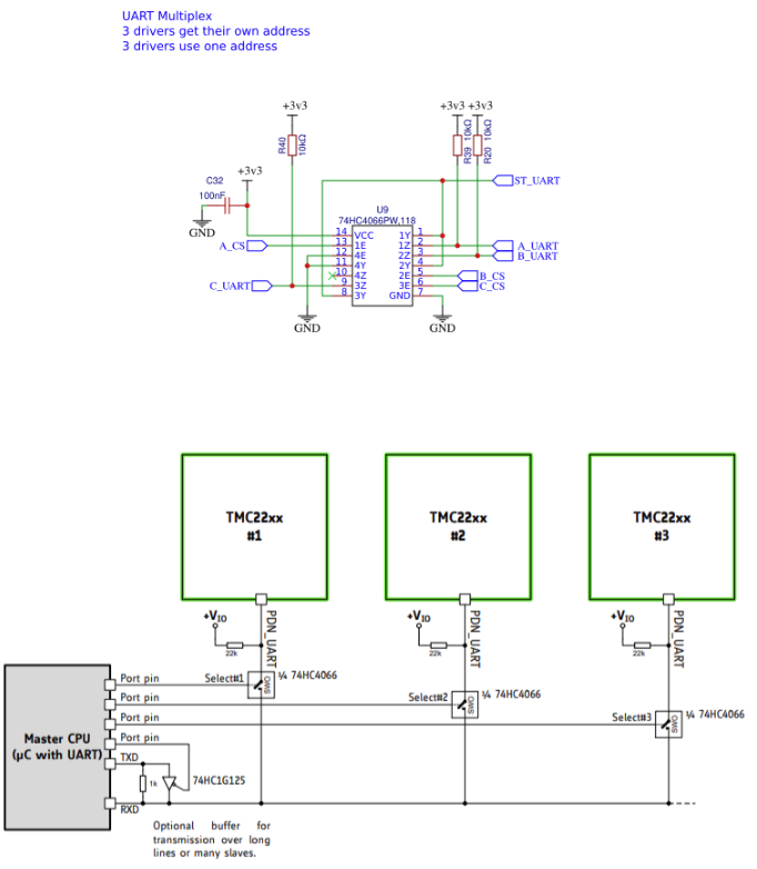

UART (TMC Configuration)

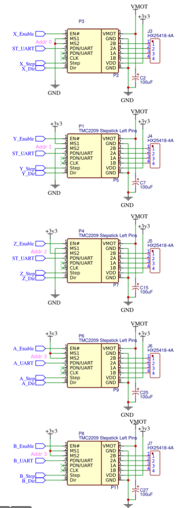

If we managed to just get the above working, could we plop in some drv8825s and just step without messing with the UART? Probably not. The MS pins on those driver ports control the microstepping selection in drv8825s. They are hard wired to different values for different drivers, to allow for different driver addresses on the shared UART:
We can change the state of ST_UART, but we can’t change the 3.3V or 0V connections on the jackpot (easily).
It looks like Klipper can send UART over the same wire. I’m not 100% sure of that, but I see signs like config variables named TU_SINGLE_WIRE. But FluidNC has gone a step further and made drivers A,B,C on one address, and multiplexes them:
So, before Klipper configures ports A, B, and C, we have to set the shift register for A_CS, B_CS, or C_CS correctly, flush the shift register, and then the Klipper UART routine should work. I think that code might be here:
I don’t see any way to block multiple drivers configuring at once. I hope that is handled in the linux/python side and they only send/receive for one driver at a time.
Once we have it working, there is a lot of code between the tmcuart.c and the yaml file. All of that would have to be updated to allow a user to configure the jackpot with these extra UART/shift register steps. There may be sanity checks to avoid having multiple drivers on one address. Or there may be support for multiplexing multiple UARTs on one wire using the configuration already.

The gpio_out struct currently only contains a “bit”. Which is actually a uint32…
Maybe that is a mask for which pins to toggle? Maybe we could make that also have a flag to indicate if this bit is part of the regular gpio, or part of the shift register.
The other functions in gpio.c can probably also be updated for the shift register code. gpio_out_toggle just references gpio_out_toggle_noirq, so that doesn’t have to change. gpio_out_write and gpio_in_blah need to be fixed updated for the shift register. If we did that, I bet en and dir functions would work immediately.
Yeah, likely to be really fast. I’ll reassert that if it isn’t fast enough, the PIOs in the RP2040 could provide a memory mapped space for the bits, and the PIOs could handle clocking out the data, offloading the rest of the RP2040. You’ve previously pointed out this may not be required from a performance standpoint- which I agree with.
If passing the shift register output is accelerated by a different part of the hardware, the underlying premise that things are essentially instantaneous would still hold, right?
I suppose the question in all of this is just how long it actually takes to clock out those 24 bits of state to the shift registers and assert them, compared to toggling a GPIO in a ‘normal’ implementation.

I’m thinking this may not be needed. There is a select_pins config value in klipper:
And that looks like it enables MCU_analog_mux, which gets activated before every send/receive in python:
and:
So again, I think if we had the gpio calls able to set the shift register, the TMC stuff might just work out of the box…
