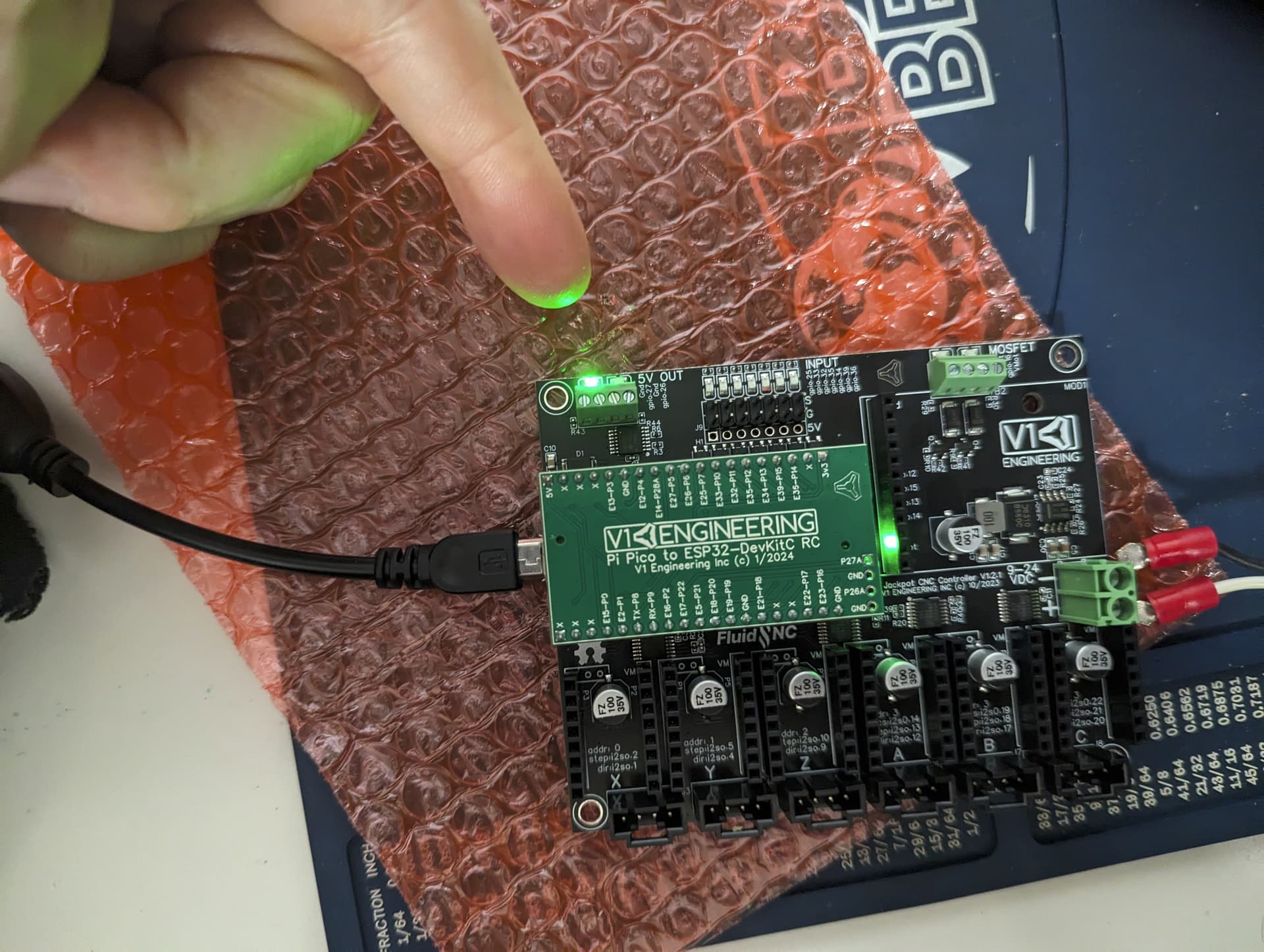

Klipper + Jackpot?
Found an id, saved the config…and they are talking!!!
Finally, I get to do some config. This is not going to be easy, at least making changes is easy!!!

What about this?
I know it’s says skr but it also said pico lol
I think you’re going to be on your own with the printer.cfg since your custom pinouts are going to be different than anything else. I wish I was more help
I made it do that!!!
Oh cool I saw that but did not realize it actually used a pico. I will see if i can get a couple of the non-multiplexed steppers moving.
Thanks!!
That seems to be easy now that I know it wants them as “gpio” not the pi’s “GP”
Awesome!! I think if you can get everything that’s not multiplexed working that will be a huge step. Then just have to figure out the tougher part lol. Doesn’t the multiplex deal just add on gpio pins? If you have a way of knowing which numbers those are you should be able to address them like any other pin.
If the multiplex is i2c based this might help as well…
https://www.klipper3d.org/Config_Reference.html?h=i2c#common-i2c-settings
Well…shoot.
fluid stuff, looks like all the steppers use i2so, cross your fingers this is all new to me. Your link should help.

Yeah kipper doesn’t usually need this much in the config. But in this use case I’m not sure.
I think I just need to define these two?
i2c_software_scl_pin:
i2c_software_sda_pin:
I got that
That’s the way it looked from what I read. There is another section linked there to speed up the connection on the pico as well
Ahhh I have three in the esp fluid yaml
i2so:
bck_pin: gpio.22
data_pin: gpio.21
ws_pin: gpio.17
So there is your clock and data pins. I’m not sure what the ws pin is
It may make you give it the address and other stuff too but you can easily try it without first and see
What does the exclamation point mean?
dir_pin: !gpio5
Inverted
and endstop_pin: ^gpio10?
Hi vs low?
