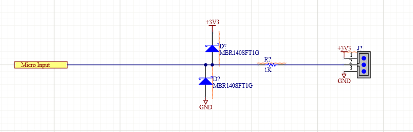

I was reading the schematic backwards which is the source of my confusion. Yes, this will result in the input being 5V tolerant because it’s effectively presenting either 0V at low impedance or a high impedance that is then pulled to rail.
I’m back to thinking that this would work having the thermistor wired to ground but that what you’re measuring also has a diode drop in-line with it, which isn’t ideal. On the other hand, with the correct thermistor it also wouldn’t be a huge issue. The current through the diode will be low enough that the forward voltage should be relatively stable.
I still wouldn’t personally want to do it that way deliberately, but it’d work for testing or if you only need something coarse like over-temp. For bed or hot-end, I’d go with something more accurate.
The best way to protect input pins is to limit the input impedance. If you add the bypass diodes to GND/+V like in the schematic above, that means that the input signal will be clamped to +V and GND. The problem there is that a 5V signal from something like a power supply will drive a heap of current into the +V rail and pull it up to 5V, frying things. The easiest approach is adding some resistance inline to limit that current. If you’re only trying to protect to 5V, adding 1kR in series will mean that a 5V signal will conduct ~1.7mA into the rail. As long as everything else on the board is drawing more than 1.7mA, all that means is your power supply on the board will work a little less hard.
The downside to adding that impedance inline is that ADCs take a big gulp of current when they prepare to measure, so you need a low enough impedance there that the voltage doesn’t drop as the ADC takes its sample. To combat that I’d typically put a big capacitor there, say 1nF to 10nF, depending on the ADC. The series impedance from the protection circuit and that capacitor then create a filter that can limit your frequency response. In this case it would be a 16kHz corner frequency, so realistically you’d want to make sure any signals were below 10kHz. For a thermistor, you’re talking seconds of response time so any filter 10Hz or above is going to make zero difference, so no drama there.
If you do need the higher frequencies, these issues can be mitigated by lowering the capacitor and living with a bit of ADC inaccuracy, lowering the series resistor value and allowing a little more current through in a worst case scenario or by adding an op-amp as a buffer so that the input signal can be connected to a low capacitance input (which keeps the frequency high) and then the op-amp can drive the ADC and sample capacitor directly without needing a heap of extra series impedance.
So:
This is ‘ok’, but it relies on not connecting anything that can supply a ton of current.
This is better because it has a 1K resistor to limit that current, so likely anything up to 10V is probably fine. On the other hand, the ADC won’t real accurately anymore because it’s trying to draw pulses of sample current through a 10K resistor.

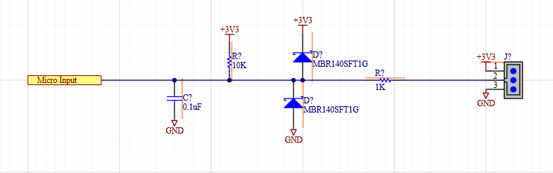

This is better because it has the 1K to limit current into the diodes and a capacitor to act as a filter/ADC buffer. The downside being this implements a 16kHz filter.
If you want to add a pull-up, adding it here will mean that you’ve created a voltage divider. 0V on the input will actually look like 330mV to the chip, because it’s a 10K and 1K voltage divider.
So this is a better way to add a pull-up. It will let a little more current flow to the 3.3V rail if a 5V signal is connected, but not enough to be concerning. It will pull up fully to 3.3V and allow the signal to go all the way down to 0V.
And this is how I’d do it in practice. There’s no difference in the schematic, but I’d put the resistors and capacitor as close to the connector as possible. That way any high frequency currents that are being directed to GND through that capacitor can exit back out the connector as directly as possible without crossing other parts of the board, etc.
That last one is what I’d use for measuring a thermistor, just with the pull-up changed to being a suitable value for the thermistor, based on the range of temperatures I’d be measuring. Usually your highest resolution measurement for the thermistor is when the pull-up matches the thermistor value. That’s when the smallest change in thermistor value leads to the highest change in voltage/ADC counts. That may make other extremes less accurate, though, so I normally calculate both the expected voltage and the expected dV/dTemp at the extremes.
That would only work if there were something else added to act as a resistor to ground, too. Otherwise all the thermistor is doing is being a variable value pull-up, but it would always still pull up to 3.3V.
The easiest thing to do would be to add a bit of wire or a blob of solder across 2 of the pins of D4. Or remove D4 completely and blob some solder on.
Easy enough to test once this is wired up. If you think there is a chance it works, as long as we are within 2-3C that is plenty good. If not we go the other way. The downside is I have to choose where to put those 3 analog pins on the pico.

I wouldn’t think so, no. Even then, those signals are digital which means you can reduce the capacitance. The capacitance only needs to be that big because the ADC needs pulses of current when it samples because of how it works. The digital inputs just look at the voltage constantly and don’t have the same issue.
I wouldn’t add the LED if it’s going to be used as a thermistor/analog input. The current through the LED will act like you’re taking the value of the pull-up and changing it. Usually I like to separate analog inputs and digital inputs because it’s a bit challenging to make circuitry that does the job well for both of them. Then again, I’m usually designing stuff that’s way more ‘single purpose’ so I typically know what is getting connected where at design time and can design accordingly. If you were dead set on keeping the input able to digital/analog input with an LED for state, I’d switch to using something like a FET to drive the LED and then all you’re hooking up to the analog input is the gate of the FET which won’t use much current or upset the circuit at all.
