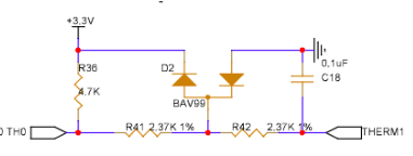

Here’s what I see from your schematic (I’d love to learn this better):
3.3V to 10K is a pullup resistor (right next to your green line). A pullup is more often to hold a line high like for a button when you short it to ground when you press it. This is considered digital IO, not an analog input. I could be misunderstanding.
This is how they do it on the octopus board:
those are std diodes, not zeners because the lines by the arrows are flat not curved. Power is 3.3.V, Resistor (R36), sensor (TH0 is the board pin attachment point) , and the other end connects to ground. THERM1 is the board connection pin. I would use R36 of 50 kΩ (like the 49.9 kΩ in your example), but I don’t know the purpose of the rest of this circuit with the matched 2.37 kΩ resistors and the diodes.
I am not sure the significance of that? I am like 3rd grade level EE, not even high school.

I’m not entirely sure what you mean here, but to read a thermistor you’ll only need a pull-up that’s a similar value to the thermistor and then route that to an ADC. Adding/keeping the diode arrays for high/negative voltage bypassing and a capacitor for filtering is always a good idea too, of course.
Never mind, I see the schematic in the next comment. This won’t work particularly well with the LED in place because the current through the thermistor will vary a lot with voltage, which is what you’re measuring. You could still do this and characterize it so it was right-ish, but it’s a lot more work than is necessary. Edit: Actually no, I don’t think you could. You’d be relying on all sorts of weird stuff like the leakage/bias current into the analog pin. Not a good idea at all…
What design is that from? It’s a little weird having that diode in-line like that. That looks like something is miswired, to me, or that it’s a very odd way of doing a 5V to 3.3V level conversion on the output, perhaps.
The diagram that @orob has there is much more like how it would normally be drawn, with the diode array bypassing to +/gnd as a form of protection. Basically clamping the signal when it exceeds 3.3V+Vf or 0V-Vf… Otherwise not affecting it.

Thanks @jono035 ! that is what I was unclear on. Clamping makes it so I can’t overshoot the limits of the input in either direction. Wish I had that on the endstop pins…
Yeah, that’s the one. It’s extremely common as a method for protecting against incorrect connections (reverse voltage or over-voltage applied) but also ESD. Because an ESD strike has a lot of voltage but not much energy, if you can direct it into the voltage rail then a small ESD strike doesn’t usually cause any issues.
The alternative is to use a zener diode or a TVS, which is basically just big zener diode anyway. The downside with those is that they start to ‘leak’ current before they start conducting fully so you need to choose one with a much higher reverse voltage than you’re using or it will start to affect the circuit. They also have a lot of capacitance so can slow down high speed signals or cause other unwanted effects. Their capacitance also changes with applied voltage so for analog signals you can end up with a filter that changes frequency response as the voltage on the pin changes, which isn’t ideal.
this information is gold. I had a design with a TVS on it and I had to pick a new one and other than a simple reference circuit, could not find how to best use it with my limited exposure to that component. It ended up working and protected against reverse power connection. I was not aware of the leak tradeoff or the increased capacitance. The circuit in question was a low tech DC setup, so no issue with signal attenuation. Your explanations are very helpful.
That was always there. I think he pulled it off of one of his expansion modules. Just trying to protect the input pins. (Honesty it is not all that important because I do not place the 5V rail). Usually I think it is to protect feeding 5V into the gpio.
Any input on “protecting” the input pins? If we can do it another way and get the functionality back of all those IO that would be awesome!
Yeah, that’s a nice easy scenario for a TVS. Most of them are specified with a specific reverse working voltage which is where they’re guaranteed to leak less than a certain current (I think 1uA or 10uA from memory, depending on voltage range). The trade-off is that the clamping voltage will then be much higher, something like 30-35V for a TVS intended for 24V use.
Using a Zener in the same scenario can be a bit fraught because they really work best when they’re constantly conducting in reverse. A 3.3V Zener might start conducting slightly as low as 2V and by the time it’s at 3V it might be conducting 1mA or more. That makes them really awkward to use for protection, specifically.
