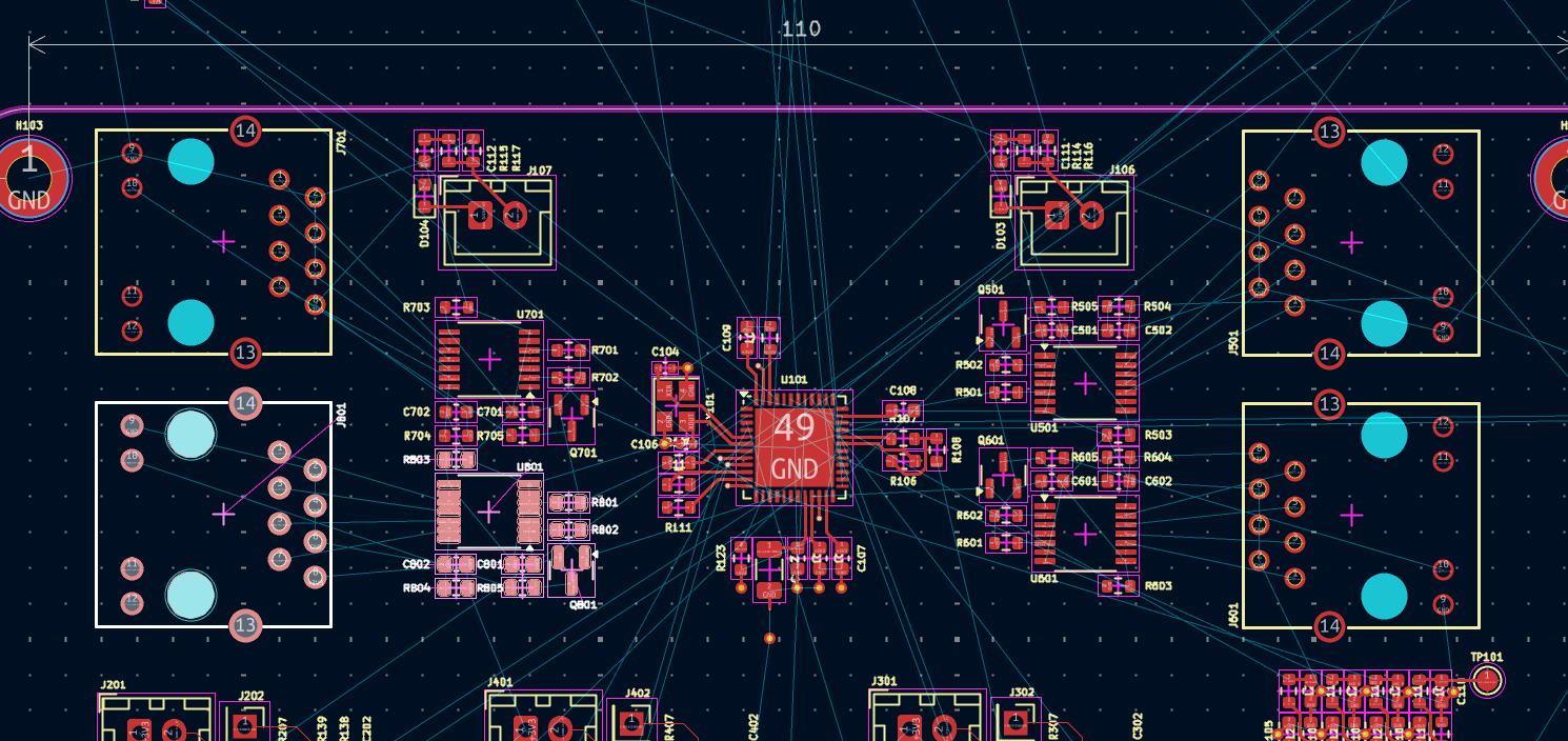

After Camchaney uploaded the original PCB design (thanks a lot!), I made several modifications and converted it to KiCAD. While the design is still a bit rough and requires further refinement, I hope it can be useful to someone. Please note that I can’t guarantee its functionality, so it would be great if someone could double-check it.
A few key points to consider:
  • This version is not compatible with Camchaney’s sensor board. I changed one ground connection to 1.8V to allow for centralized power distribution to the sensors. I plan to use PAW3395DM sensors in my design.
Here are the changes I made:
  • Removed the 5V line
  • Eliminated the buck converter and created a separate PCB for voltage conversion using off-the-shelf buck converters from AliExpress/Amazon (please check the links; there are more affordable sellers on AliExpress).
  • Switched the resistors and capacitors to 0805 packages for easier hand soldering.
  • Replaced SMD electrolytic capacitors with through-hole capacitors for manual soldering.
  • Changed the sensor connectors to Molex JST XH and modified the power connections to Phoenix MC 3.5mm.
  • Adjusted the sensor connectors to supply 1.8V from the main PCB (this involved removing one ground pin). If you use Camchaney’s sensor boards, please be cautious it will short the sensor boards and the main board!!!
  • The encoder still needs to be positioned correctly, as it may not fit the control panel. There were some issues with converting the Eagle files.
  • I rearranged the pins on the stepper motor connectors to ensure compatibility with my stepper motors.
    I hope this KiCAD version serves as a useful starting point, but please keep in mind that it still needs additional work and cleanup.
teensy-jst_01.4_v9.zip (589.8 KB)

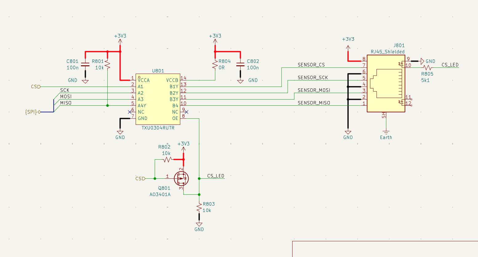

With large amount of EMI from stepper motors, it’s very possible that supply voltage could be swinging around outside of valid threshold… especially with these very low voltage I think local regulation with an LDO like on original boards is a more robust method for powering the remote sensor boards.
The sensors are also using separate Vccio (3.3V) for serial bus, if you only are bringing 1.8V over are you also doing level shifting on main PCBA? Or can teensy support 1v8 logic level IO on arbitrary pins?

I’m also a little concerned about this 1.8V line. The GND wires through the sensor connectors provide extra current paths to help minimize EMI. I would be partial towards doing the power drop on the sensor PCB side, just to make sure that voltage is as precise as possible. It goes directly towards powering the sensor’s illumination. There is some room to use a slightly different VDD for that line (such as 1.9 or 2V), but the LED resistor should be modified accordingly.
Thank you for your feedback. I was contemplating the use of shielded wires for the sensor connections, as they would also help with the SPI connection. However, you raise a good point regarding the VDD’s direct impact on the illumination of the sensor, which I hadn’t considered before.
The sensors support a maximum of 3.3V for VDDIO, so that should work well with the Teensy.

I think probably the best thing we could do without drastically changing the hardware is to isolate each sensor to it’s own parallel segment of bus using something like the TXU0304, so that there is not effectively several huge (300-500mm) antennas hanging off of the signal source at the Teensy. They are all tri-stated by the chip select pins so that multiple chips are not re-driving the same lines. I’m still putzing around with the design but here’s a bit of a sketch: (note: this is for an idea i had to try and run the compass off an STM32 part rather than a Teensy, so very WIP)

A lot of this goes over my head, but it sounds super cool hahah. Is this effectively reducing the capacitance of the SPI lines? I’m still a little confused what those chips are doing…
It’s splitting the lines into individual sections, each driven by their own buffer.
So rather than having say 300pF of capacitance on 3x paralleled SPI lines, you’ve now got 3x separate lines with 100pF each. The key there is that each buffer is now driving 1/3 the capacitance. How much this benefit this provides can vary quite significantly depending on the issues you’re trying to address.
If the buffers have negligible output impedance then it would have no benefit, the outcome would be the same. A 0V to 3.3V transition would have a nice fast edge rate because the buffer has enough output current to quickly charge the 300pF of capacitance. The cross-talk would be the same because the current impulse from the high speed edge on the neighbouring line through the capacitance would propagate down the line and into the driver without much voltage change due to the impedance, etc.
If the buffers were high impedance the improvement could be up to a factor of 3. Each buffer is now driving 100pF instead of 300pF so that’s 3x the high frequency impedance so 1/3 the current output requirement for the same edge rate, which means a faster transition from 0V to 3.3V with the same output impedance. Same thing with cross-talk, 1/3 as much cross-talk current means 1/3 the voltage disturbance as the driver sinks/sources that current. That’s a fair bit of an over-simplification, but hopefully it gets the idea across.
In reality it’ll likely be somewhere between those two situations. It won’t be a perfect threefold improvement in edge rates and cross-talk, but it’ll definitely be better. The downside, of course, being extra complexity, cost, board space, power consumption etc. as well as sometimes simply being not really possible without kludges that may make other things worse. That’s common with buses like SPI where you have to be able to have things like the slave device drivers go into high-Z output so that other devices are able to communicate. The network then needs a way to either know that the end device is in high-Z state and to do the same to the master-end buffer, or it needs a defined ‘idle’ state that can overridden by other devices, etc. It’s even worse again with stuff like I2C where you’ve got something multidrop with a high-Z idle state and low-Z active state. Then each buffer needs to be able to replicate that high-Z/low-Z state across it which can cause all sorts of issues. There are chips that do it but in my experience they haven a strong chance of introducing other problems/variabilities that can be remarkably difficult to diagnose.

Oh sweet! Lots of cool stuff in there. @jono035 helped me implement a few of those things into the circuit earlier on when I was debugging SPI connectivity. Series resistors for the data lines and RC filters being a couple of them that really helped with robustness.
RS-422 seems pretty awesome, but also it might be overkill at the moment. I haven’t really been seeing any issues with the current setup once the series resistors were added. I think the 400mm run (compared to the 100m runs they’re referring to in the article) won’t really have any noticeable issues in terms of synchronicity. The PMW3360 also runs at pretty slow clock speed
