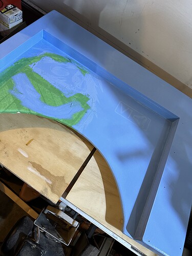

I used Dan’s tall YZ plates and then gave the table a 1.5" drop as well. The drop is to compensate for the thickness of the ice sheets (2") this particular machine will be working and the tall YZ plates will allow me to slip an even thicker piece in under there if I ever needed to. The thickest slab I’d ever use the CNC for would be around 6". I should measure this up though and see what the actual thickest I could get in there would be. Maybe I could use a similar tall YZ plate based machine to help “draw in” carvings that I do on a regular basis to speed up the carving and improve the accuracy on the human part of the carving. That would be 10" max though so this setup might fall a bit short. In any case, that’s why I’m going to be building a second LR3 (or 3.X…or 4…) - to handle the larger and thicker jobs - and to use for non-food-grade related work like playing with aluminum milling

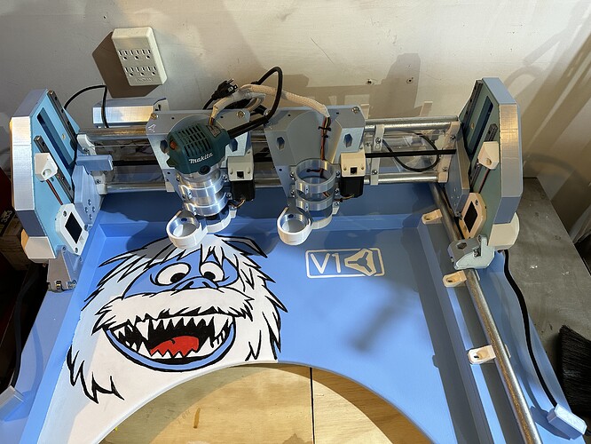

Speaking of paint drying. How’s this for a tease?
I’m always one for a good tease but when it comes time for “keeping it under wraps until it’s really really ready” I’m the worst. Can’t keep the stoke from bursting out.
This all started as I was catching up on the V1 happenings after being away so long. I came across the Googley eyes threads and thought “how fun!”. But then another idea hit me and it all seemed so very appropriate for this build…

Ha, ha. That looks great! So, is the half circle cutout there to make it easier for you to transport it or does it have another use?
This particular machine is made to handle sheets of ice that are 20" long x 10". 10" is right around the bottom teeth. The machine needed the excess y rail length but my needs do not require the excess y on the bed. So, to save a little bit of weight and then to make it easier for me to reach under the ice sheet when loading and unloading the curve was cut. I didn’t just cut straight because I’ll still need to pop a couple holes in either side to hold some concentric dog levers to hold the workpiece.
