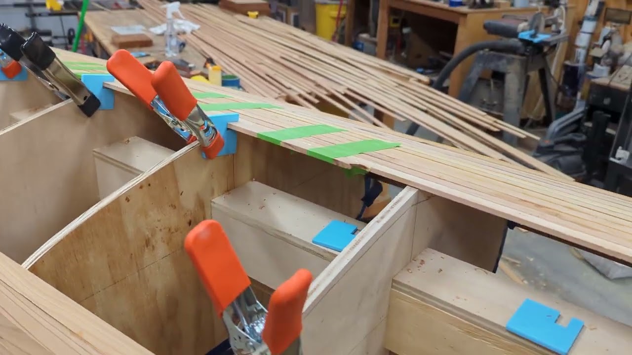

I started off with tape on the forms but couldn’t get the hot glue to stick. I’m trying to build this without staples and my hot glue wasn’t sticking to the forms.
I’m not having an issue with wood glue sticking to the forms. Once the strip dries, I go down the strip and pull it away from the form to pop any wood glue that stuck. Then I put a little hot glue in it and glue it back down. If I wasn’t going through and popping the strip loose each time, then I could see where little bits of wood glue would cause an issue on the forms.

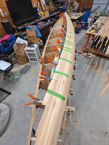

Got 3 strips done today. One before work. One on lunch break. One after dinner.
It looks really nice without the staples.

The only two I’m using are the scarfing jig and the square clamping jigs.
If I was using a full sized glue bottle, I would have printed one of the glue nozzles.
Oh… and I use the little jig I printed for copying lines on the forms to the other side of the strips. It’s just a rectangle with a circle cut out.
Half of the bottom is done.
I got the keel line cut during lunch today. Now I have a few hours of planing to get it straight.
These strips that have to be fitted on both ends are taking a little longer. If I counted correctly, I have 10 more to go to finish the bottom.
You are moving right along! That seems like a ton of work so far, impressive.
Thank-you.
It looks like a lot of work, but it’s surprising not. It’s just the same few steps over and over and over. I’m spending way way more time waiting for glue to dry than I am actually doing anything. Each strip is probably only taking 10-15 minutes to fit and install.
If I was willing to use staples, I’d probably be done with the strips by now on both the top and bottom.
The longest two tasks so far was probably cutting out all the forms and then processing the 2x8’s down into the strips.

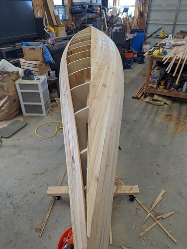

The bottom is done.
