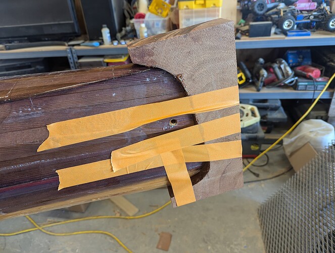

The inner and outer seams have been completed. Later this week I’ll start chopping off the bow and stern for the outer stems that need to be fitted and installed.
Outer stems are cut and installed. Have to wait for the epoxy to cure so I can shape them.
The bow is shaped. This took forever. The chunks of Mahogany I started with were way too large. I ended up using a few different hand saws to remove large chunks off of the bow. Then went in with the hand plane and spokeshave to whittle it down. Finished it off with the RO and hand sanding.
Lol, when I first saw those photos I was wondering why they were so big. I thought you were going to carve a mermaid or something into the ends. :rofl: Looking good so far.
I would rather start with too much, than start with too little.
I do wish I had cut the width down to 1".
The stern is going faster. I grabbed my circ saw to knock a lot of big chunks off.
This only took about an hour to get this far. About half as long as the bow took.

I was thinking dragon’s head.

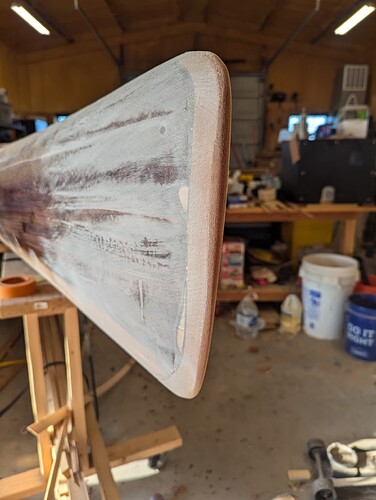

Getting closer.
Epoxy fill coat on the hull yesterday.
Today I’m adding fill coats to the deck.
Then just final finish sanding and spraying protective clear.

I have a RO with a soft pad that works really well for this. Just have to keep it moving so it does not cut deep.
I ended up sick last week, which set back my progress.
I’m almost done with the final sanding. I may be spraying clear on Saturday.
