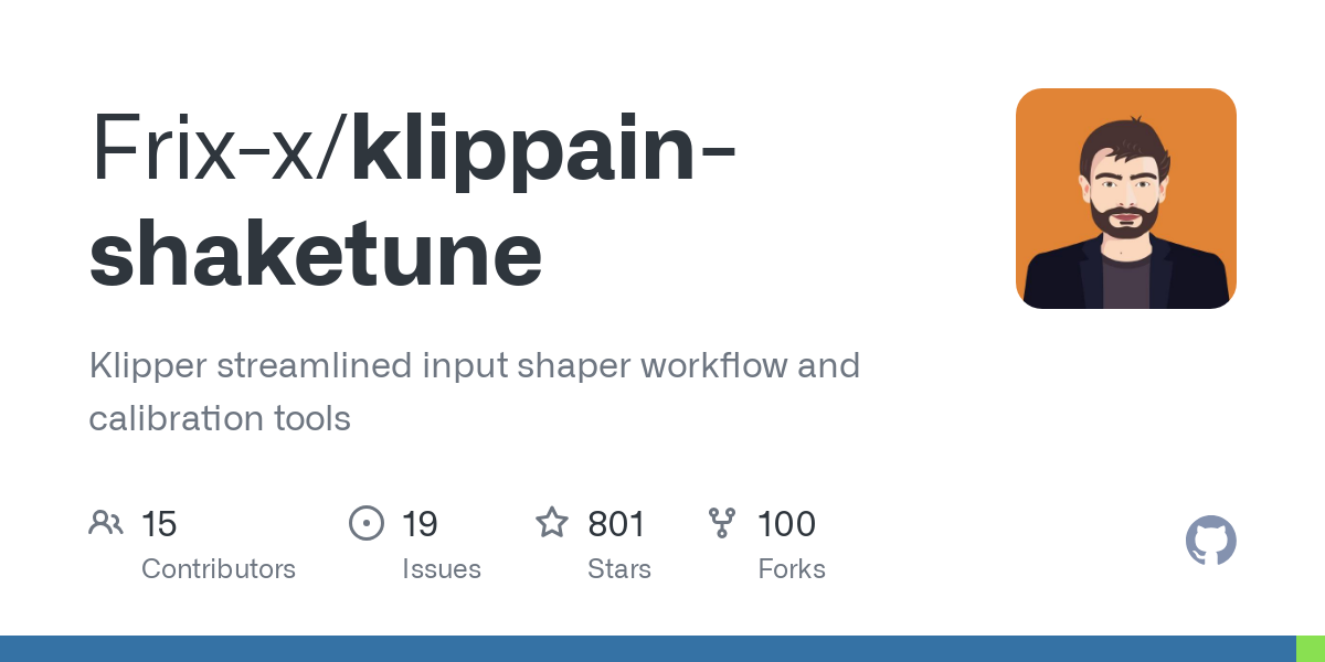

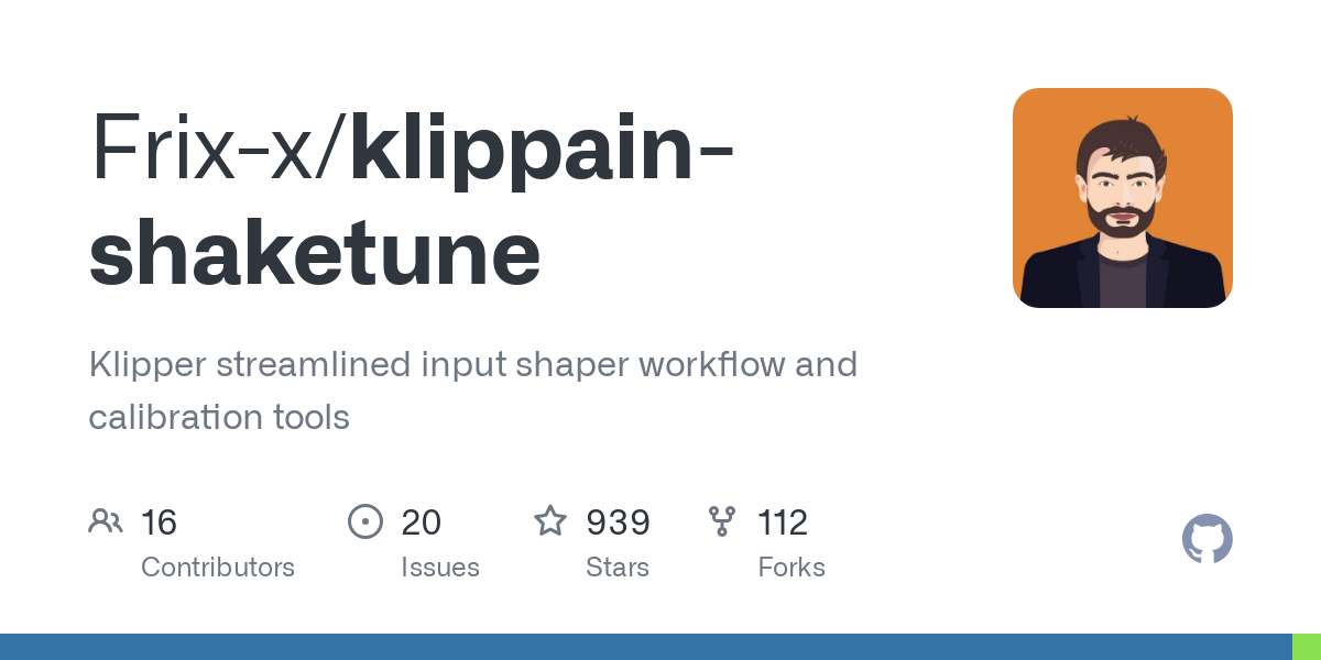

How do you track down vibration source(s) without access to slow mo guys’ cameras?
Mine are smooth sailing.
Run the accelerometer test, find the odd peaks, run the shake tool and touch or listen to parts until you figure out what is moving.
Same
Yep. That test tool is a wonderful thing!
