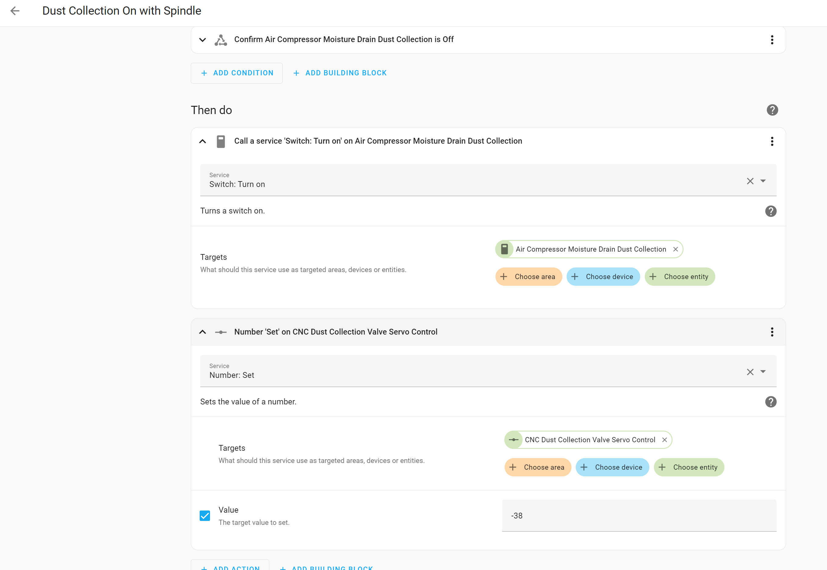

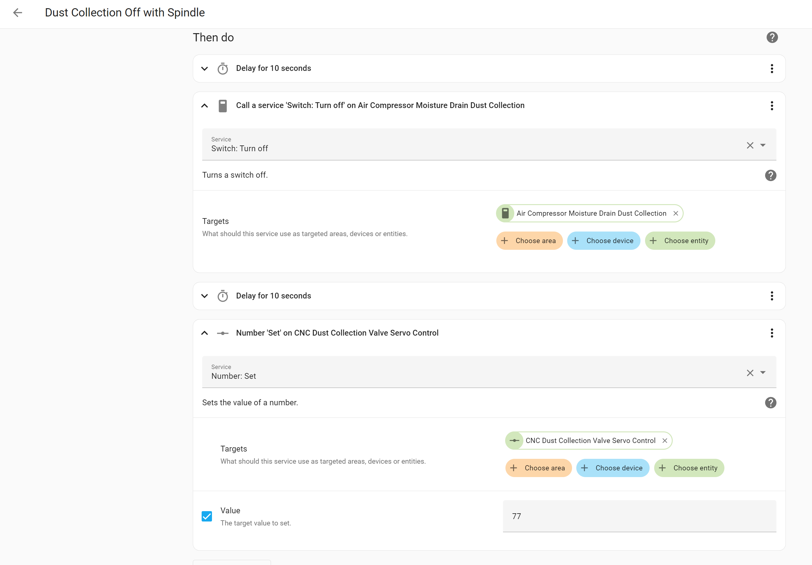

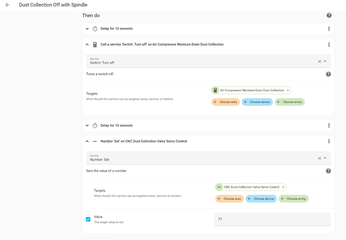

Made an upgrade to the dust collection on the full sheet LR3 today. Thanks to an unbelievable amount of help from @Michael_Melancon I now have a functioning valve on the dust collection!!! The old style blast gate I used would always get jammed up and never sealed. These 3d printed ones seal GREAT!!! And the addition of the servo just makes it super cool!!! I have plans to add several more of these as I finally get around to finishing up the dust collection runs to everything else! Don’t judge the mess lol. Too many things going on.
And using home assistant to automate it as well…
Looks good….Now come finish mine for me lol….
I’ll get to it one day I think
Also, that’s probably a bit too much credit given to me. But, glad you got it working. I’m still manually spinning my levers :grin:
WOW! Those work great, and the servo action is cool to see function.
They wouldn’t be working at all if it weren’t for your help so I disagree with this statement
They seal better than any other valve I’ve tried. And yes the servo is awesome!! So nice that I don’t even have to think about it. Just hit go on the jackpot and the rest happens automatically lol
