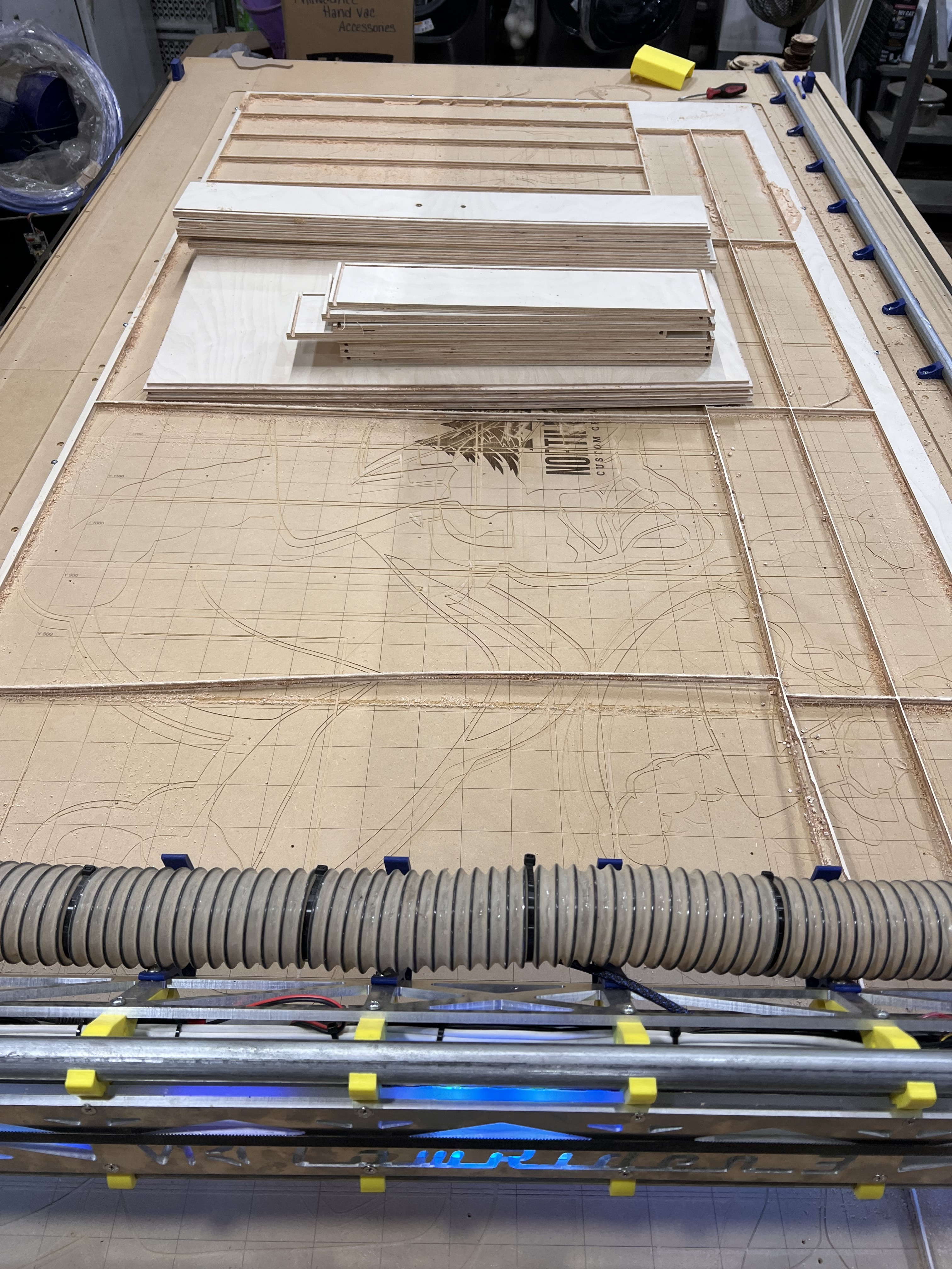

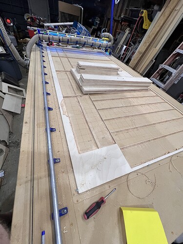

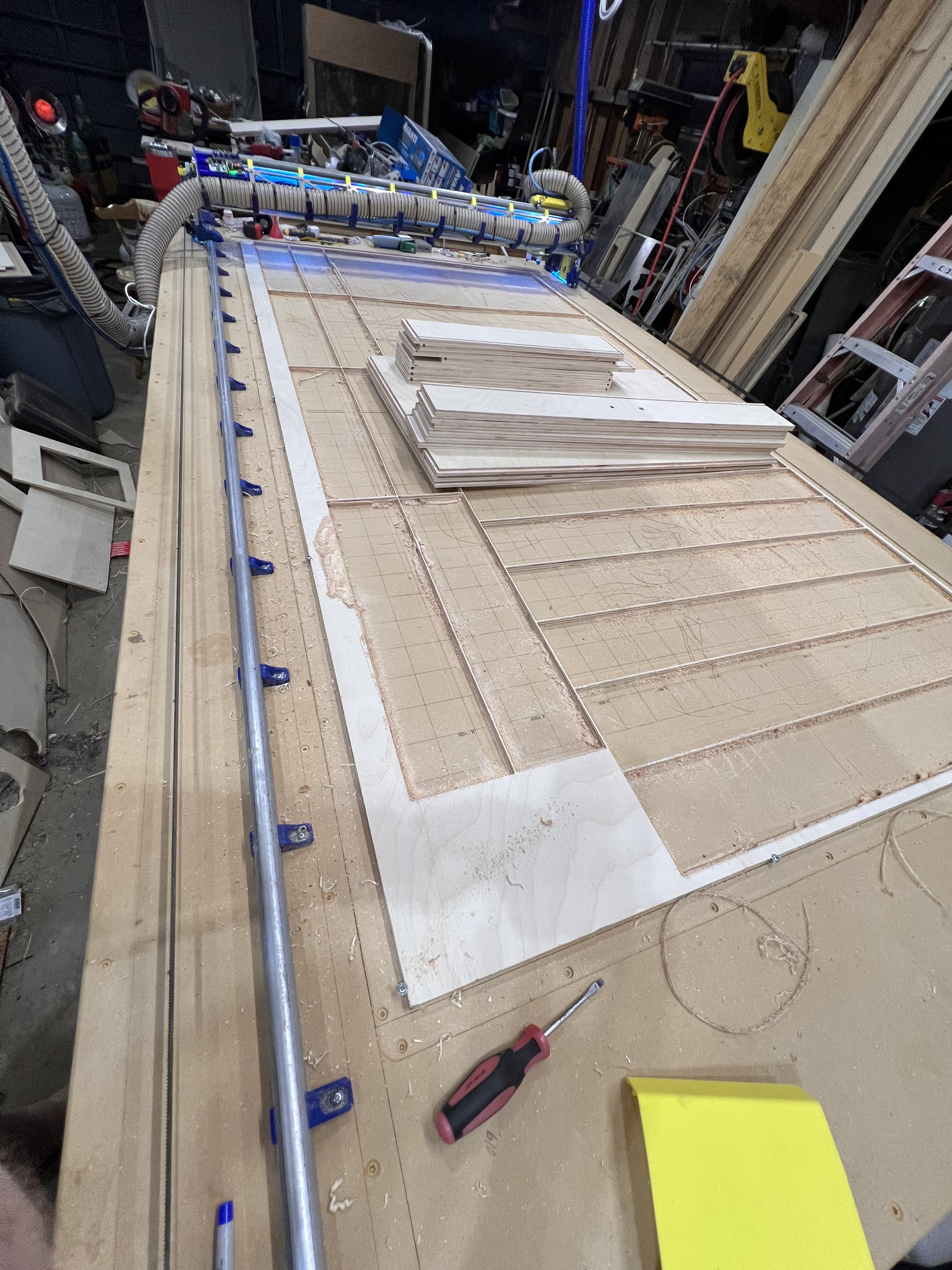

This is how your supposed to us a full sheet machine right???

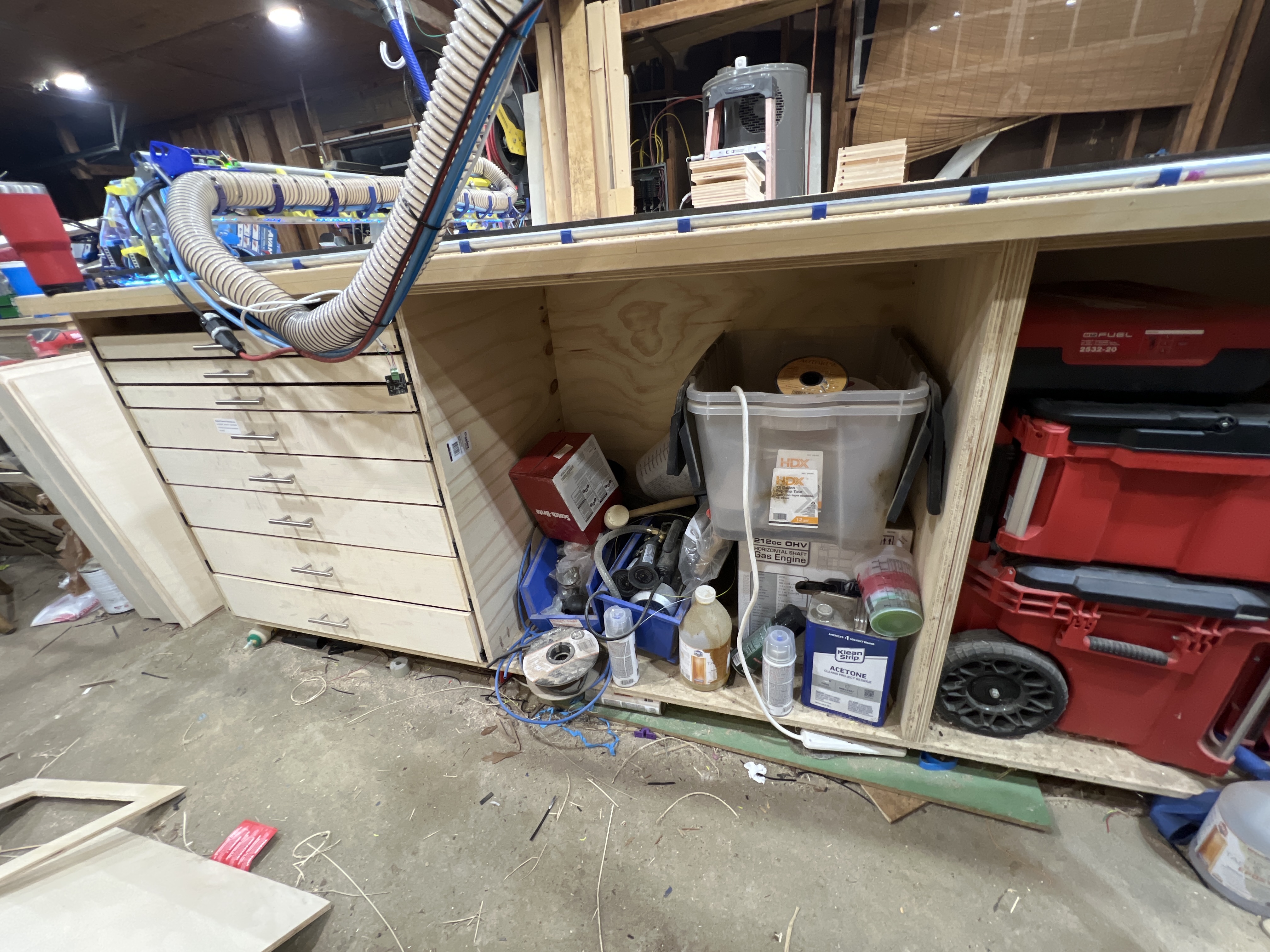

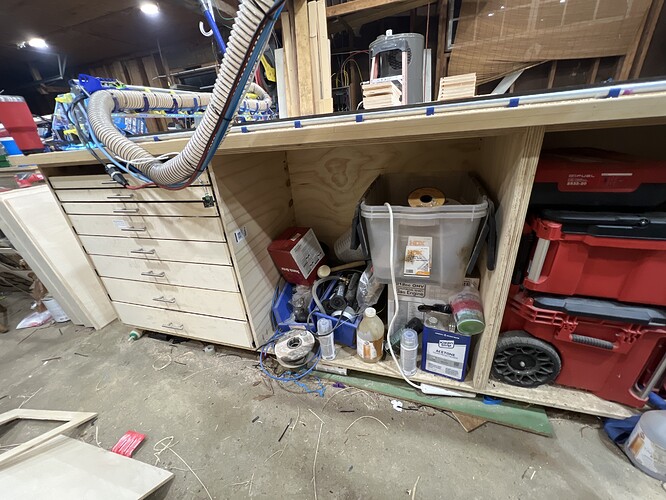

3 drawers cut out and an additional 2 sides to complete the ones I cut yesterday. Slowly adding to my storage in my “LowRider on top of cabinets” lol. It’s amazing how much stuff you can put away in a nice row of drawers. Already have the first of 3 planned rows done. This will be the middle row. 3rd to come at an undetermined future date lol. Will post more pics when they are installed but here is one of the completed row and the messy hole these are going into
Nice!!!
People spend a whole lot more money to get that cutting capability… Heck yes, that’s a super capable setup.
Did it all at 23mm/s and 6.25mm DOC with this bit
I think it ran very well. Only issue I had was the plywood getting stringy and wrapping up around the bit. Other than that not a single skipped step, nothing else screwed up, it just went how it was supposed to. Now I get the fun of sanding all the upcut fibers and putting them all together tomorrow LOL
Is that 1/2" ply?
Well 12mm actually. Its what the cabinet shop calls “China Birch”
Is it still 80 bucks a sheet?
So wasteful… left all that scrap left over! Lol
That’s awesome!!
Thankfully no. Paid $35 a sheet, Cheaper than I could get Sandi plywood at home depot and this is much nicer 5 ply. I think they wanted $40-45 for the 3 ply. Plus I would rather do business with the locally owned cabinet supply house than either box store
Edit. I lied… Its 4 ply not 5
LOL I tried to get the most I could. And that little full length strip has a use as well. Put up a shelf in the computer room last time I was home and I’m going to use it across the front of it and hide some LEDS behind it LOL
