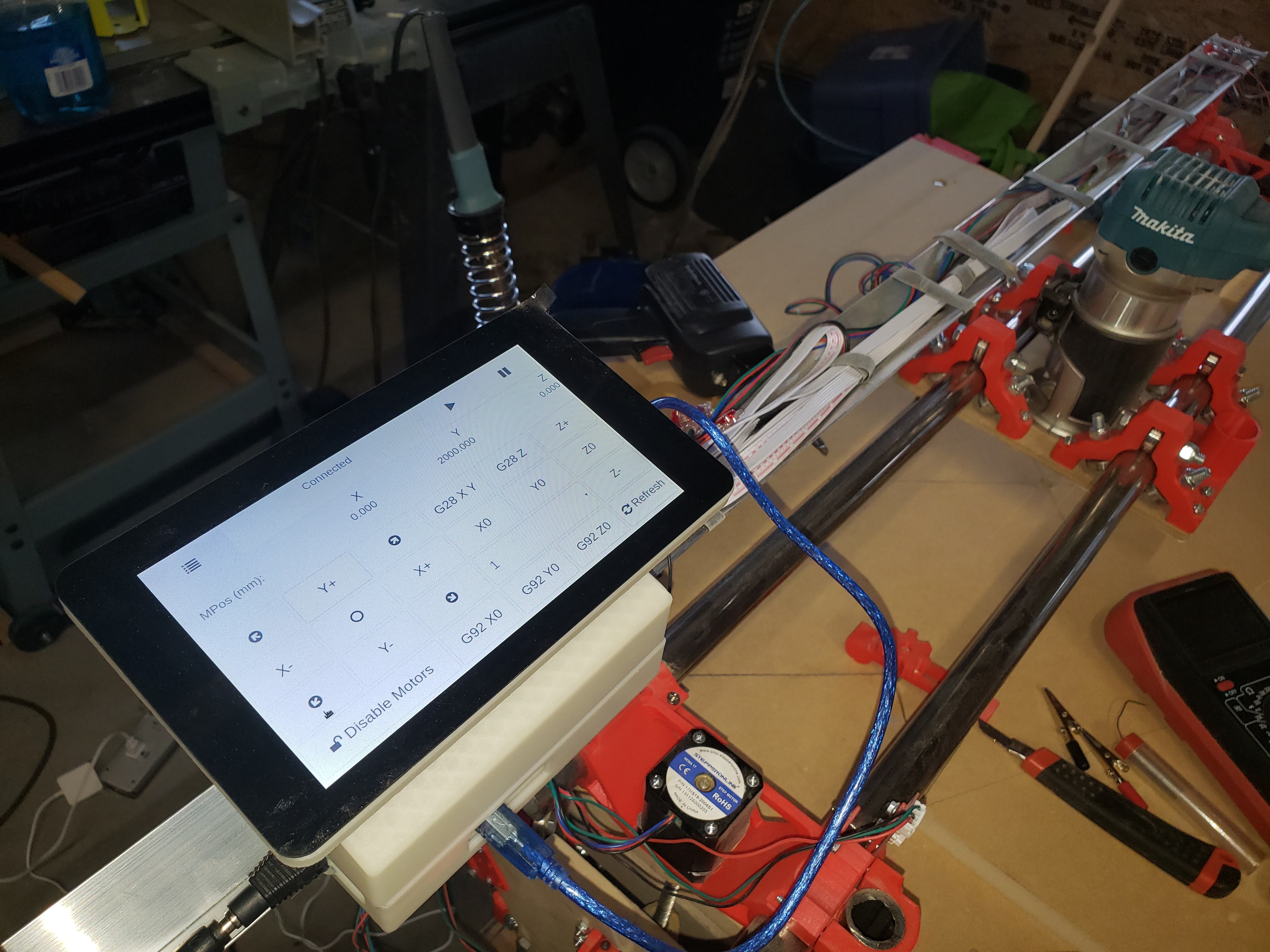

Love the cnc.js and octoprint image that Jeff created. I am wondering if anyone out there has added the 7 inch pi lcd to it? I thought about running the touch ui in octo like i do for my ender 3 but the interface for tinyweb looks more cnc friendly.

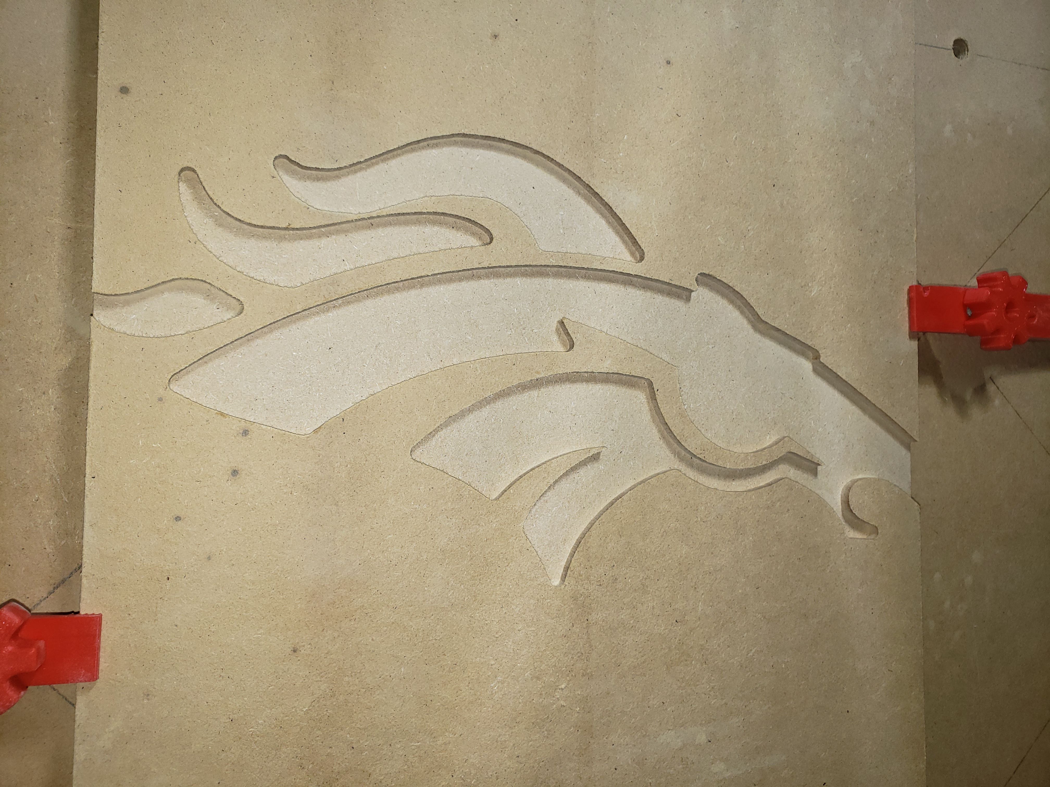

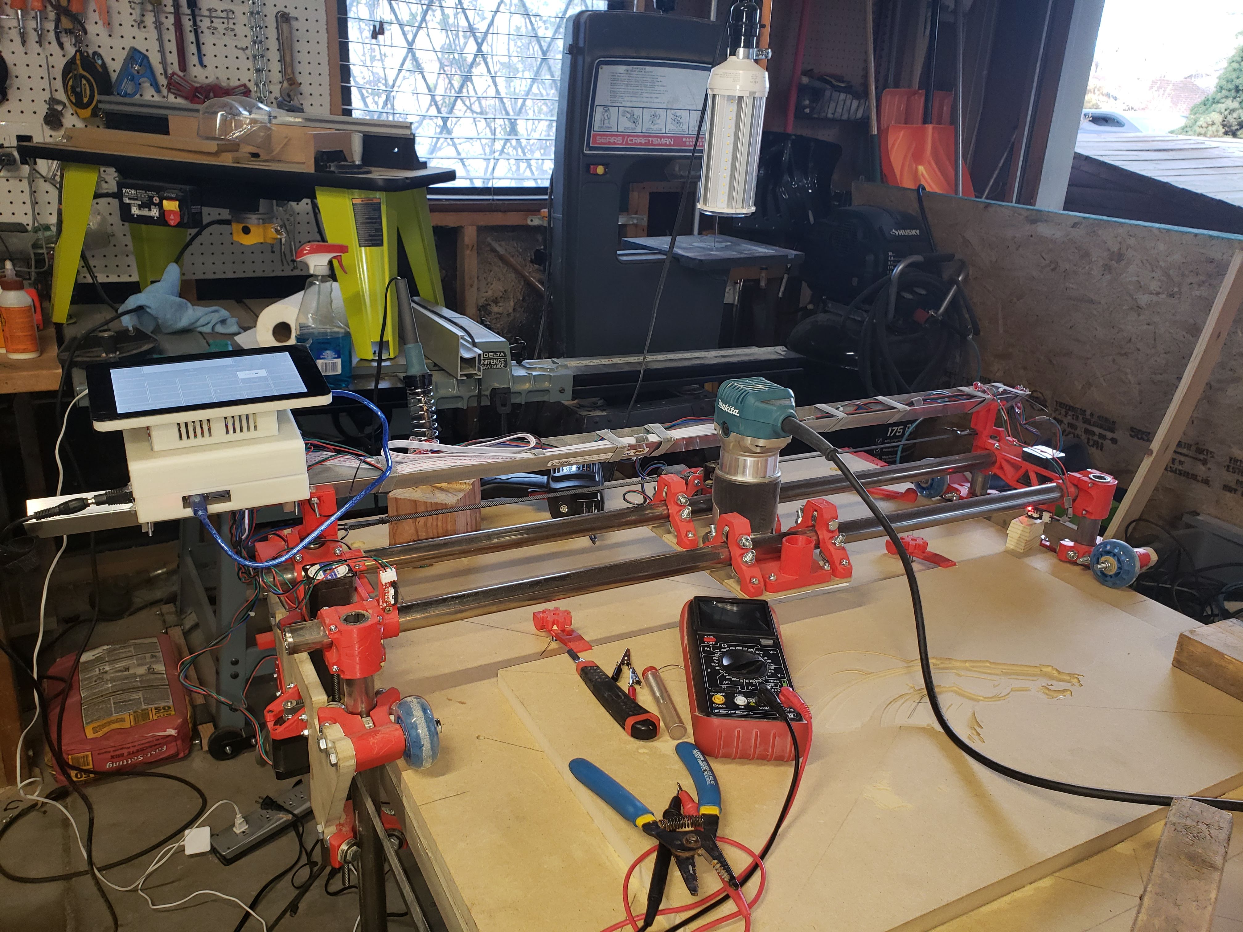

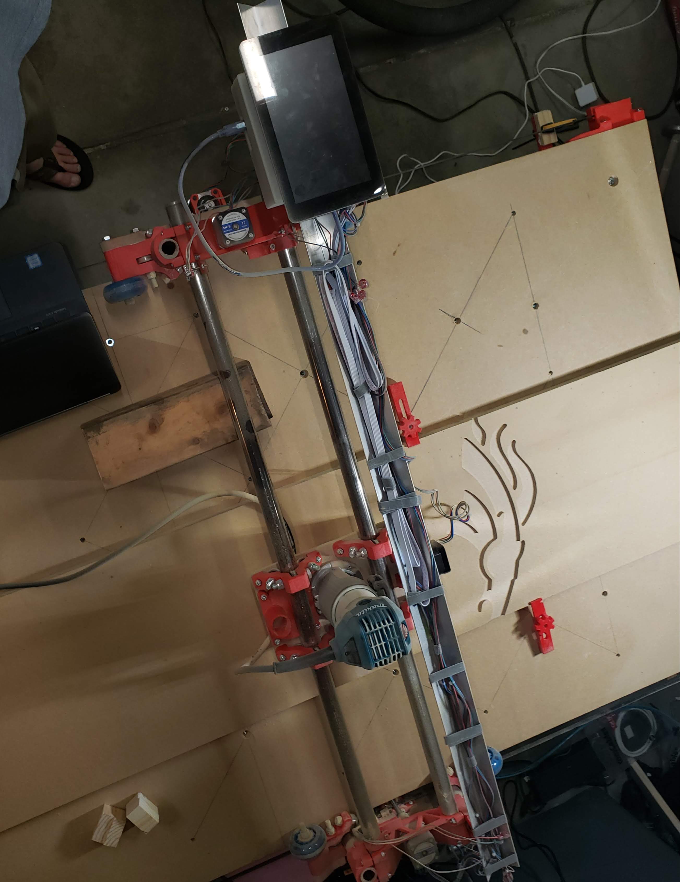

Jeff, you were correct. cncjs -m /tinyweb:/home/tinyweb/src needed to be run once you killed cncjs, which natively runs on 8000. my physical setup is a bit bulky but seemed to cut with no problem. I used a single power source and a buck converter for the pi+lcd.

good to know. is used the defaults and added the “service” to pm2 for cnc.js tinyweb
i then added the “application” (next is all by memory) chromium full screen http://127.0.0.1:8000/tinyweb to the startup location. i told you windows weenie! all i know it works.
