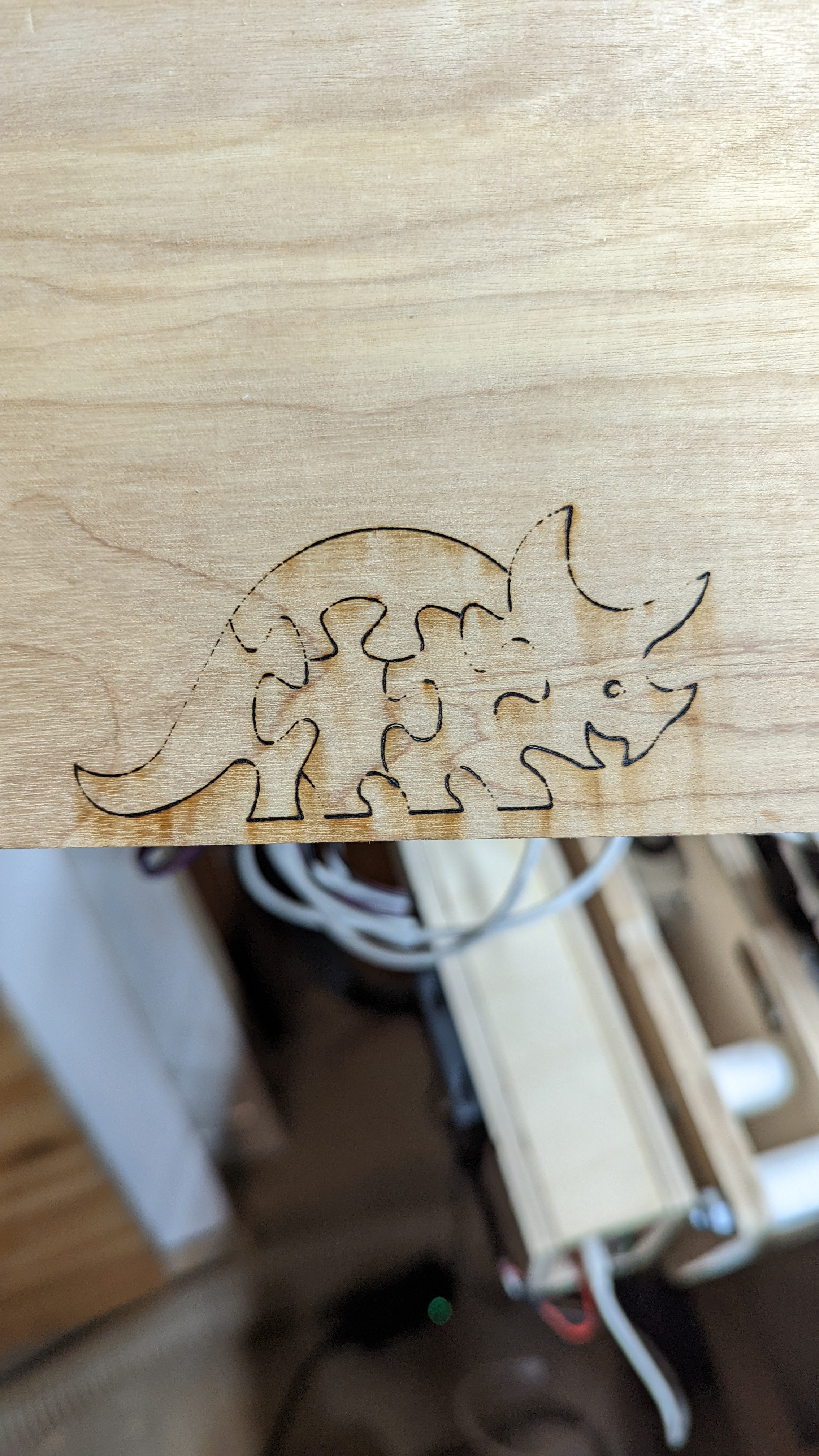

It was surprisingly fast. It was 2 passes at 4mm/s, 80% power. It is 1/4" plywood. This neje Laser is no joke. Less than 5 mins, but I didn’t time it.
I still have some testing to go though. The cuts aren’t as clean as I’d like and not consistent enough yet. I think I need a better air assist. This “regular” aquarium pump is pretty small.
4mm/s is to much for 4mm plywood, before i get air assist i used to cut 5mm birtch plywood in 1 pass at 120mm/min 100% so half the speed you use.

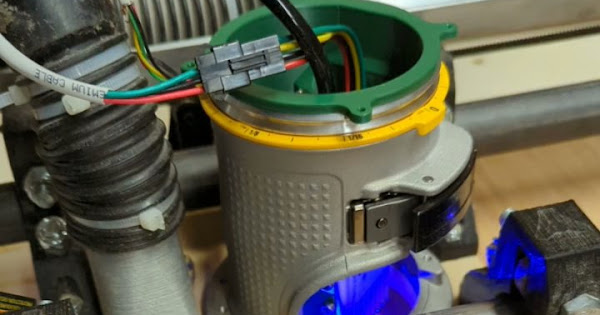

Hey Jeff. Have you made a mount for the LR3 and your laser yet?
The one I made works with the DeWalt mount. I just had to clip the fan mounts, they were interfering.
It just barely clears the bottom.
If you have the Makita, here is mount I designed for my Primo that may work on the LR3 since the laser mounts inside a 65mm tube.

The bottom of the neje needs to be all the way down at the bottom. That’s the only thing. I think Dan used the Makita version. I can’t remember if he got it all the way down or not.
Is there any reason it can’t go in the vac port there? Maybe not high enough for support?
That is a possibility. I wanted to still use the vac with the laser though, just for extra smoke removal.

The Makita version is just a little too tall, and I can’t get the Neje to focus below the core bottom, so I had to remix the DC piece to have a removeable plate. I did get it working after that with the removeable bottom though. There must be some difference with the LR3 DC between the two versions, or else my laser just doesn’t have a long enough focal length lens.
