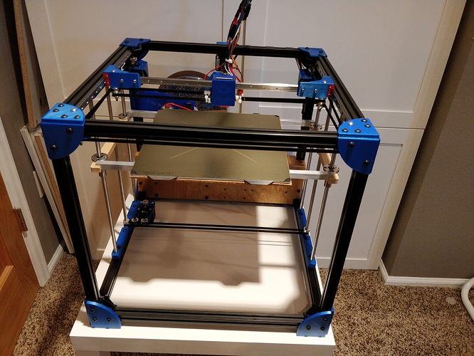

I owe an update. I am not going to get to print something today. I am real close, just the heaters and thermistors to wire up. I’ll hopefully get that done tomorrow.

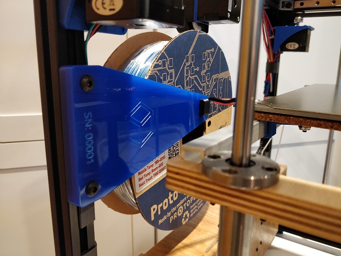

Look what came in the mail yesterday! Serial number 1. I love it.

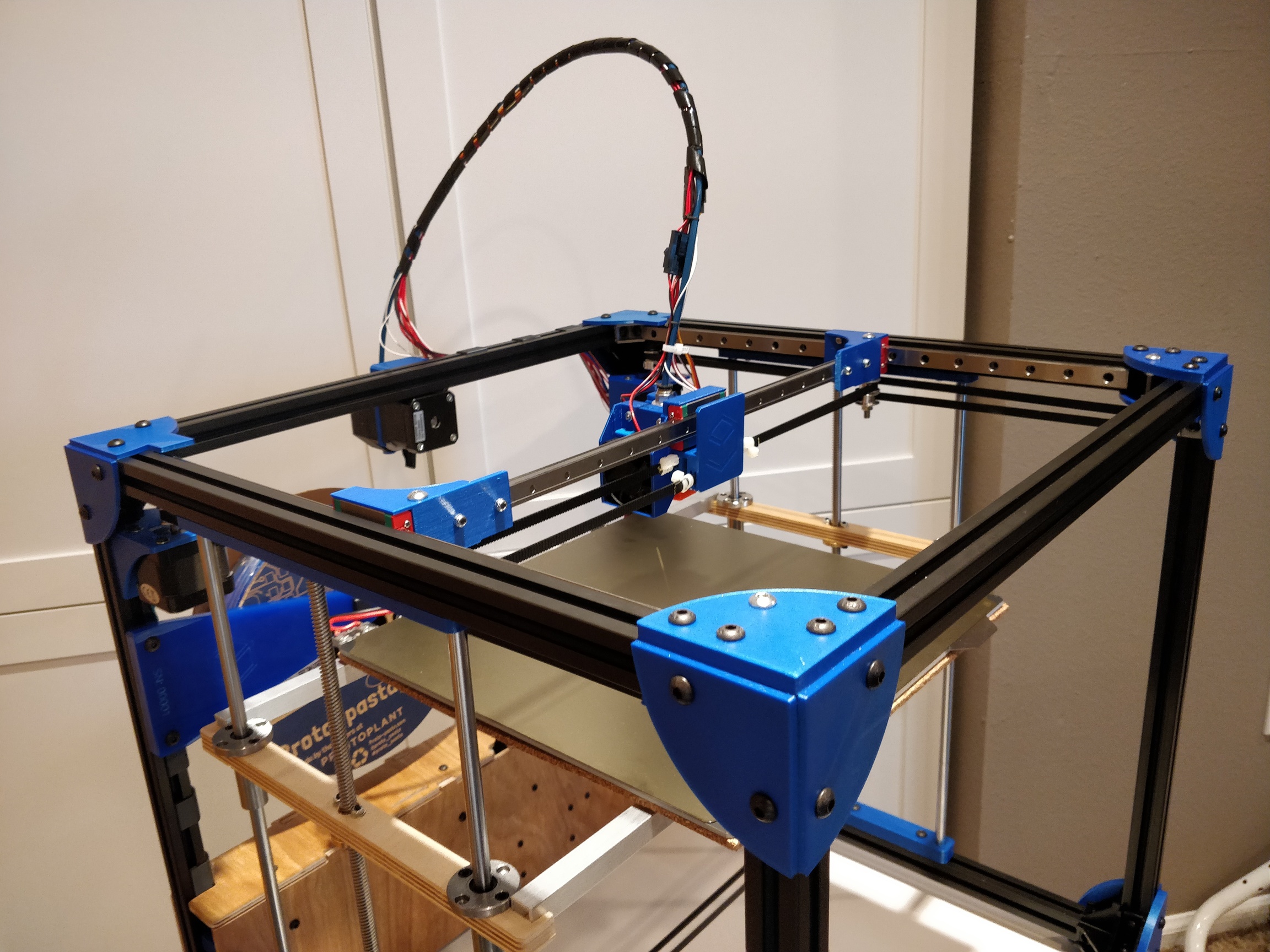

I have been working on the wiring. I reversed again and put the bed mosfet back in. It just fits.
I got the whambam pei build plate too. Looks great.
I’m a but worried about this, otherwise, this bed seems awesome. I may put some kapton down, and then also print something to cover that, although it might not last long on the bed.

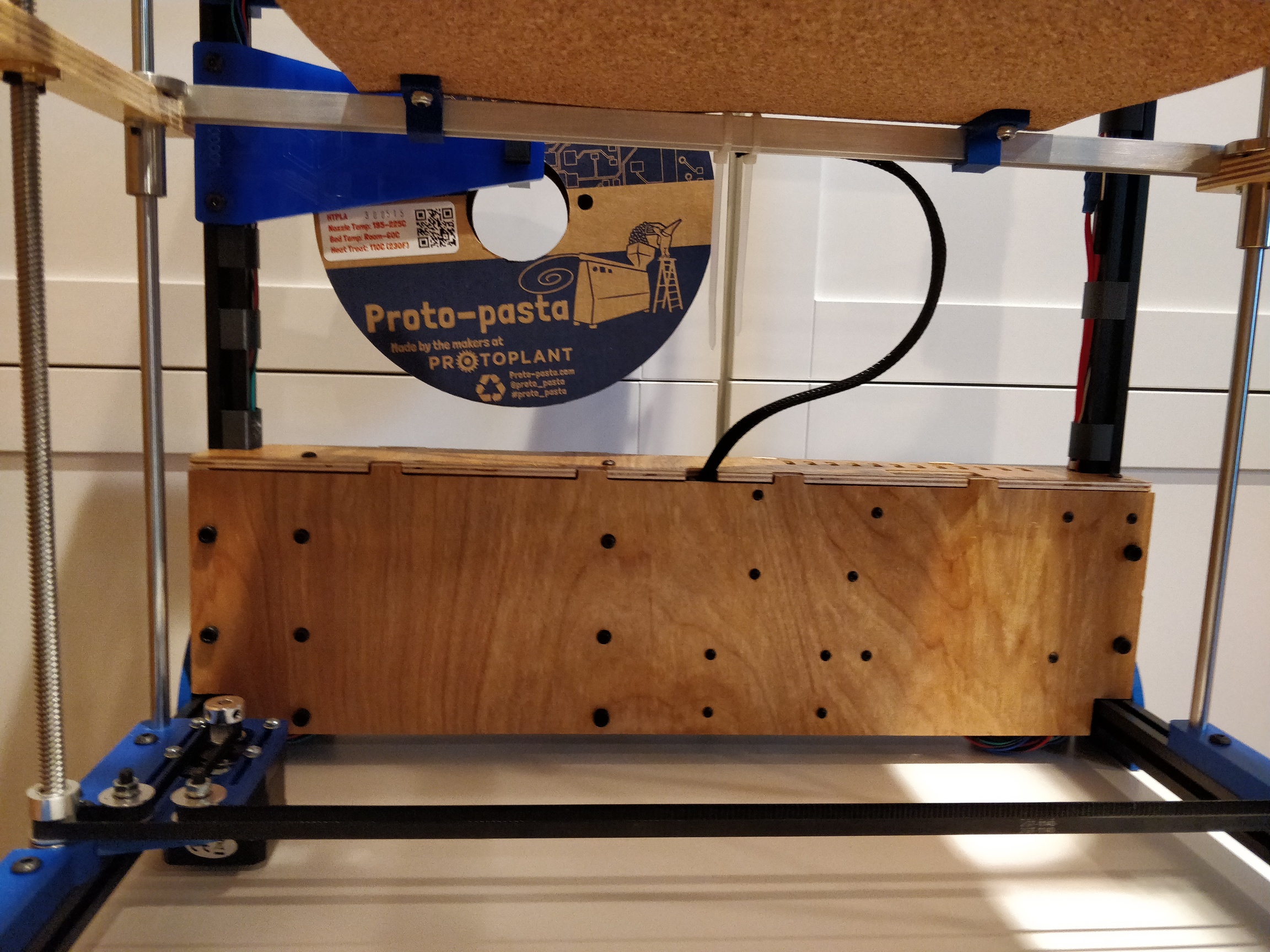

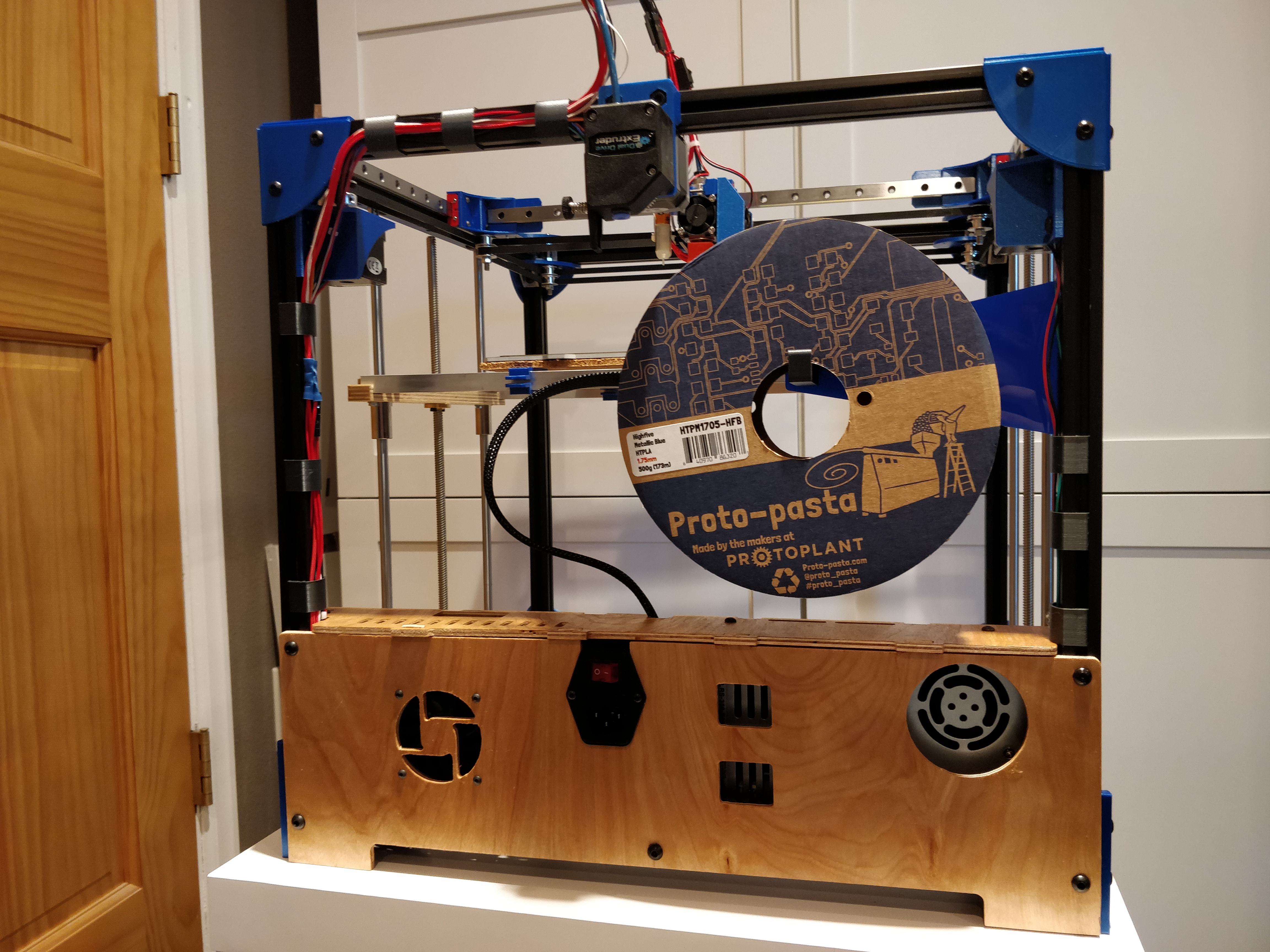

I’m quite pleased with the wiring. There is extra motor wires under the controller, but I managed to keep the top of the controller pretty clear, and I only had to make a few wires.
The spool mount looks pretty awesome.
I am super excited to finish the software and feed some filament through. I won’t have much time for a few days though.
Dude, that’s nice looking!
OHHHHHHH!!! Yes, Looks pretty dam slick so far!
Who needs sleep? YOLO.

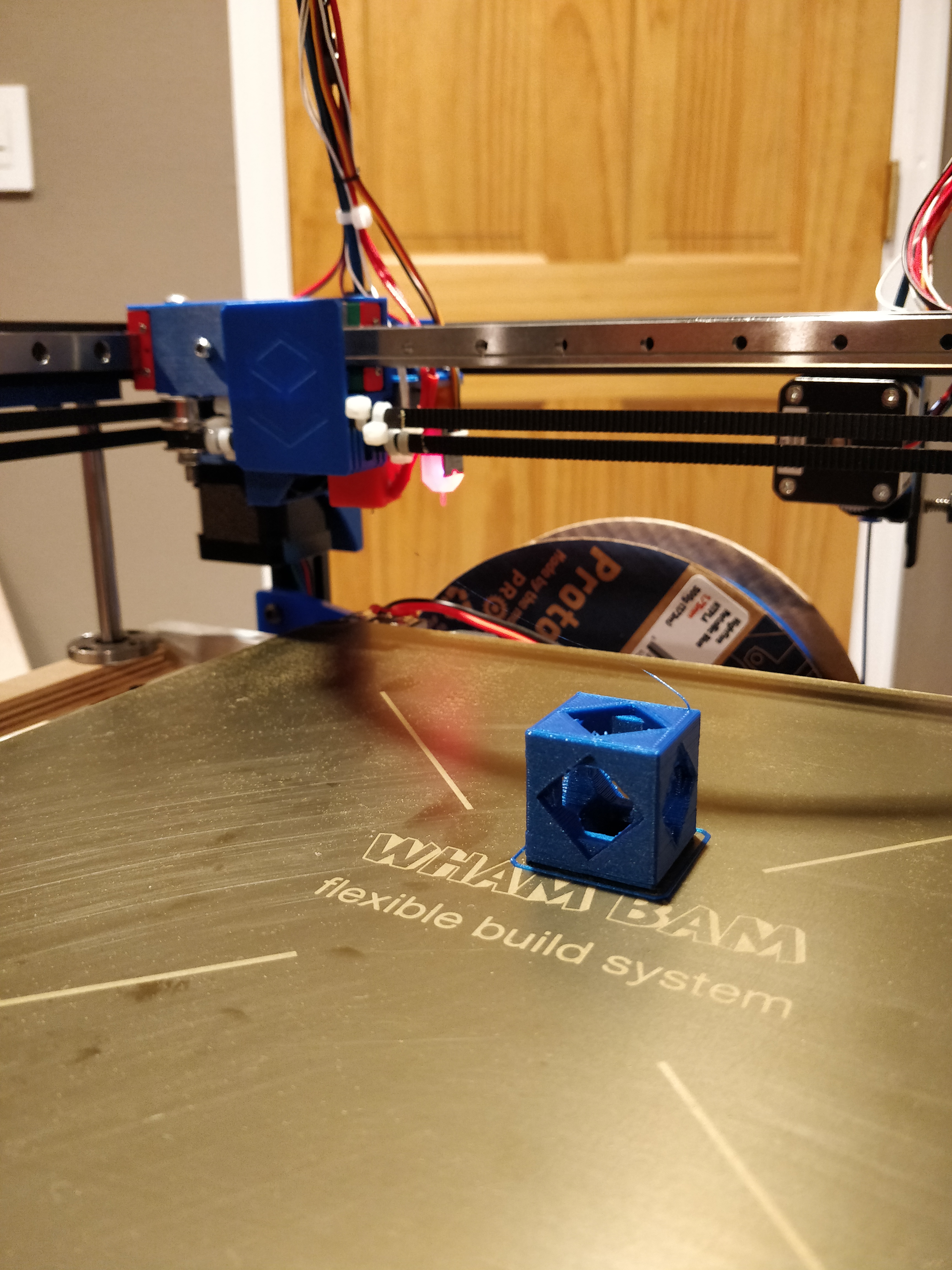

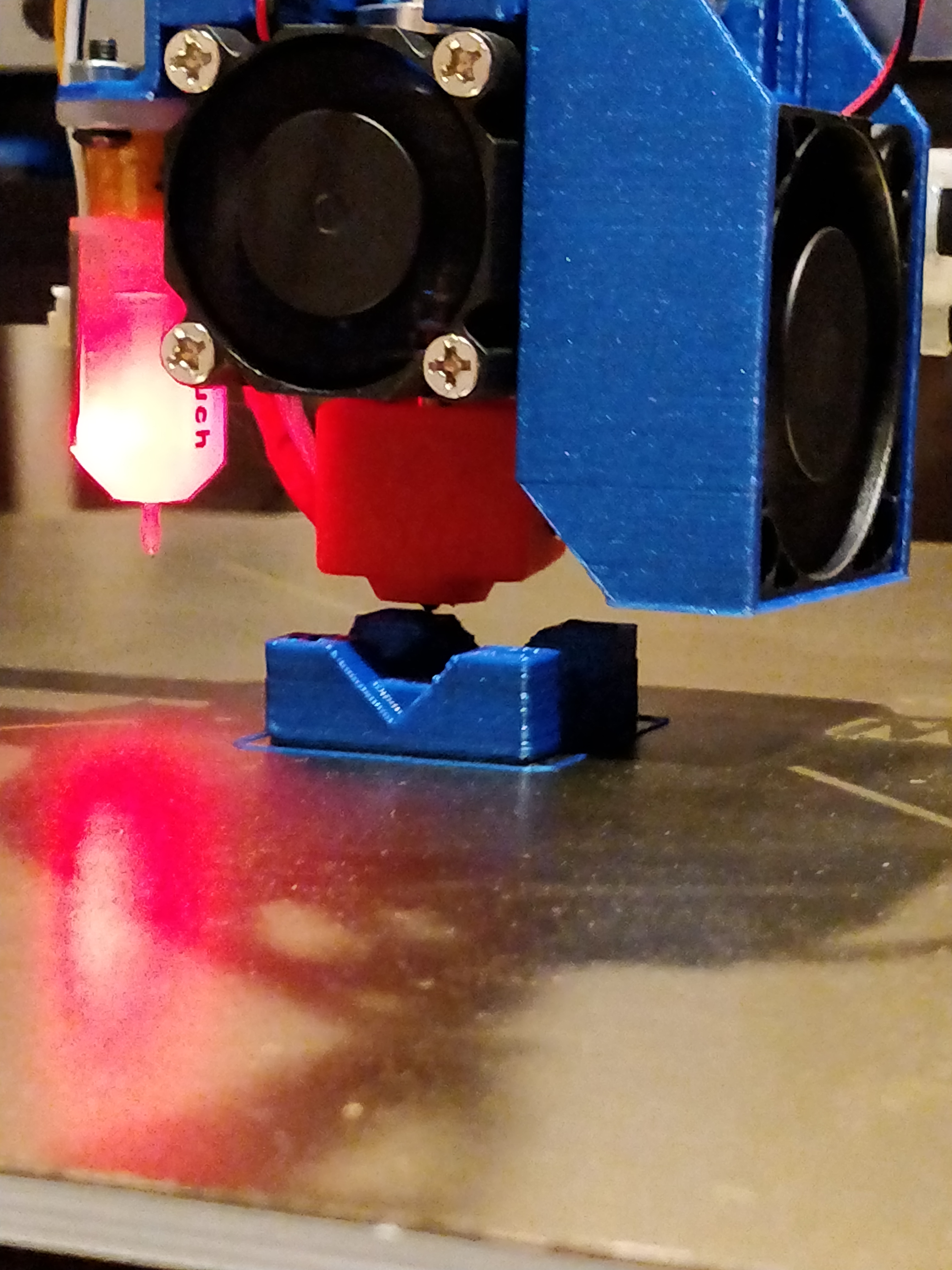

Not too bad, considering I still have quite a few tuning steps to go (bed leveling, temperature, extrusion, slicer settings, especially retraction).
Try a bit of silicone calking on those solder joints. That should be able to handle the heat and will look better than Kapton tape.
with a bowden drive, you definitely want to enable linear advance (k-factor) in your marlin build and then figure out what it is for your system. mine are all around 35-40.
