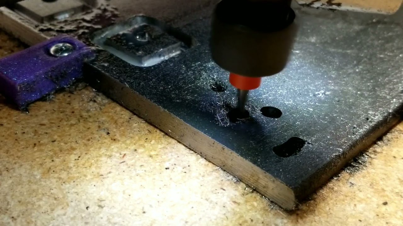

A while ago I got some cutting oil that’s supposed to be mixed with water:
I mixed according to the directions.
I don’t have a flood system so I have it in a handheld spray bottle and I squirt occasionally.
My RC2 is on rails and I forgot that I had to lower the router a bit. The spoil board is not quite as thick as the rails and with the router at it’s “correct” position (all the way up), the Z axis bottoms out just barely above the spoil board, about 2 or 3 mm.
It took me a while to figure out what was happening, why it wasn’t cutting all the way through. :laughing:

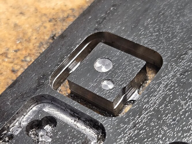

Here is what another failure looks like. Started with a brand new bit:
And afterward it looked like this:
What is a little strange to me is that the (accidental) partial-depth cuts from before were sorta okay-ish, and my thought was that the load on the edge was okay and I could just use more of the cutting edge, provided the torque and stiffness were enough.
I am guessing but I think these might be the differences:
  • Perhaps heat is nonlinear with depth because at let’s say twice the depth, there is twice the heat generated but it is harder for the heat to get out
  • A partial-depth cut allows the coolant to pool slightly in the cut rather than soaking into the spoilboard, for a dramatic difference in cooling
I also haven’t tried reducing spindle speed from the maximum, so that is probably a factor.
Next attempt, I will:
  • Just do shallow holes, assuming I can finish with a drill
  • Reduce spindle speed
  • Try step-down of 3mm per pass (three passes total)
  • Trochoidal plunge vertical instead of at an angle
Would the reduced chip evacuation associated with the deeper cut be the reason for the increased tool wear?
I found that when cutting 3/8" aluminum vs 1/4" aluminum, the air/mist system I was using wasn’t nearly as effective in clearing (blowing) the chips out of the slot, so I was getting a lot more chip welding and recutting happening (single pass full depth trochoidal).
I get that you don’t want to use IPA, but could you not use the soluble oil in the mist system?
If you are only using an occasional squirt with a spray bottle, then perhaps using an air line to blow the chips out of the slot might be effective.
The difference in chip evacuation could be a big part of it.

I did try multiple shallower passes and it was at least able to complete, although I think I got missed steps somewhere along the line.
This was also at speed “4” instead of “6” on the Kobalt.
Again a brand new cutter and this is what it looked like at the end. Not great, but not a total disaster. Tip is blunt/broken and there’s a chip at about 2.5-3mm.
