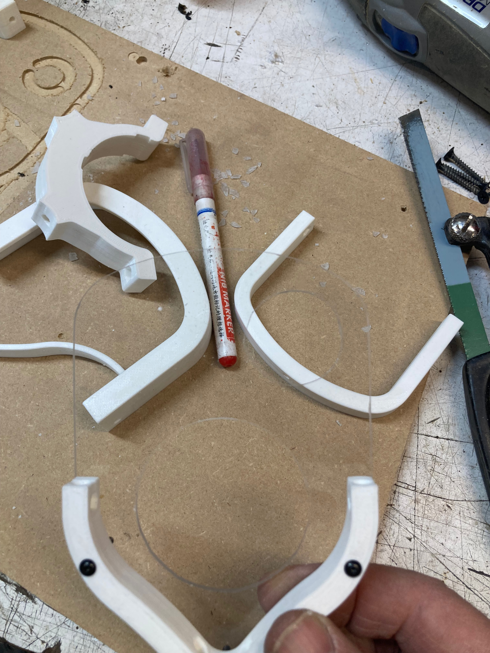

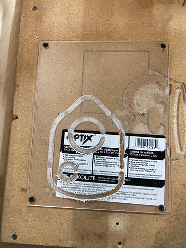

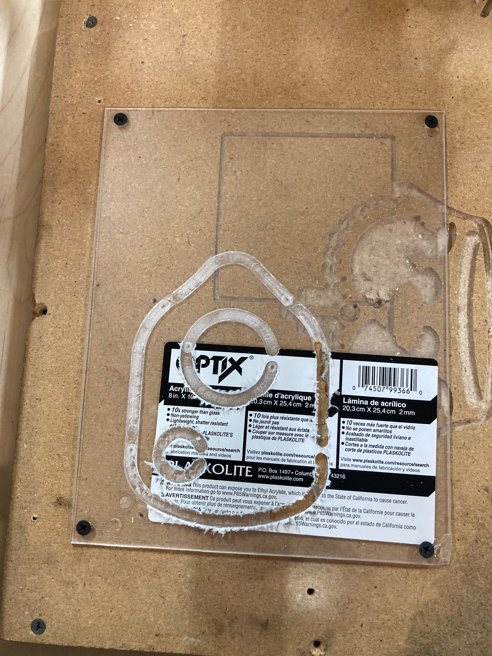

Quick update on this FluidNC config. Finally had time to run my first cut part on the cnc after tuning the cnc steppers etc. configs over a few weeks when time permitted.
i cut an acrylic plastic plate for the dewalt 660 dust boot.
Found out my table base sacrificial wood is more off horizontal than I originally thought but it cut out ok and ran very well.
I think I am going to set up the end stops as well soon as a next update. I have a large 3d machining model to do so getting the cnc dialed in as much as I can before starting the larger project.
Thanks to everyone for helping me work through newb questions.
