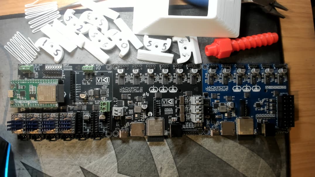

I’ve just finished assembling the MPCNC mechanics and I’m now waiting for my Jackpot3 delivery from Elecrow. In the meantime, I wanted to design a control box, but I can’t seem to find any documentation or a 3D model of the Jackpot3 board anywhere. Is something like that available and I’m just missing it, or do the board dimensions match or are similar the ones discussed in “Jackpot 3d Model” thread? (mainly the placement of the mounting holes.)

Board dimensions and mounting hole locations are the same as Jackpot 1 controller if that helps…
ESP32 module’s antenna sticks out side of Jackpot 2 and 3 boards.
The CAD link is here, Jackpot3 Box by V1 Engineering | Download free STL model | Printables.com.
