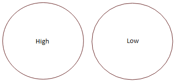

I looked into the short lines as curves in lightburn and this is how lightburn works with curves, the software uses short lines to make the curves. I tried lowering the tolerance for the curve detail but that did nothing to help the issue.
I also tried lowering the laser power setting and that did not help either.
Is it possible that the Jackpot does not like the use of small lines for curves because of the controller having to make many very small movements quickly ?
Copy of the text from the lightburn website regarding curves:
Curve Quality:envelope:¶
This controls the precision LightBurn uses in displaying curves on the screen. All curves are displayed as a series of short lines, but the higher this value is, the shorter those lines will be. You can see the difference below.
Curves-High-vs-Low
If you’re working with files containing thousands of curves and your computer is lagging you may want to try reducing this value. If you need your curves to be very precise, you may want to increase it.
