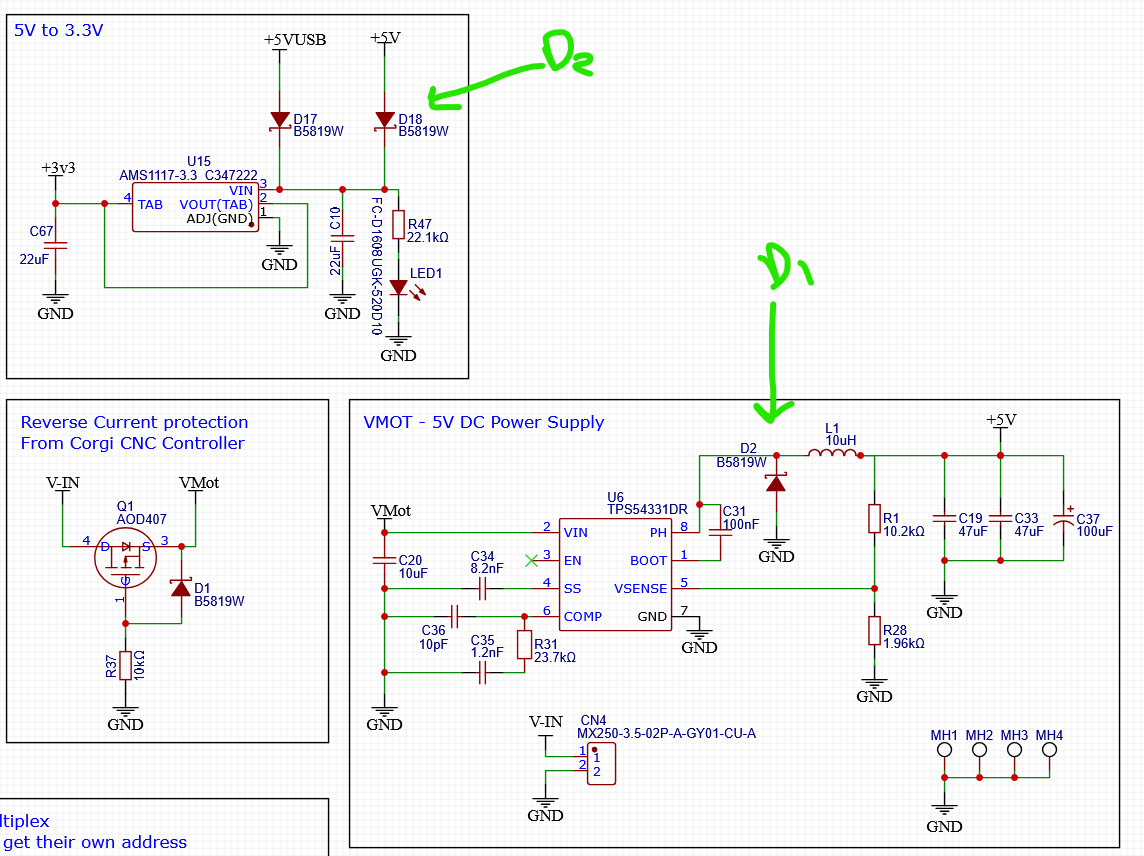

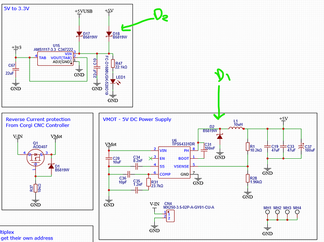

The inductor on the 5v PS still gets pretty warm. It is rated at 5.5A. looks like the m5 pendant runs off the vmot circuit, that is much better.
Running a macro makes the pendant disconnect? I tried the disable motor and turn on an output.
Yes. M5 runs on 24v where the CYD runs on 5v
The inductor is rated at 5.5A, the buck converter is rated at 3A and is not warm.
Pendant is running at 0.19A@5V.
Maybe I am overthinking it. No pendant the inductor still gets warm. I will check a jp1 vs jp2 to see if there are any differences in temp

The inductor on the jp2 is larger and does seem to get more hot than the jp1 inductor. on the jp1 the bottom of the board is hotter though so maybe this larger inductor on the jp2 is pushing more heat out the top instead of the pcb. I would not mind it being cooler though, add a heatsink, redesign the circuit?

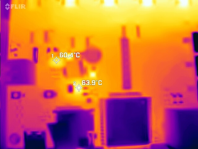

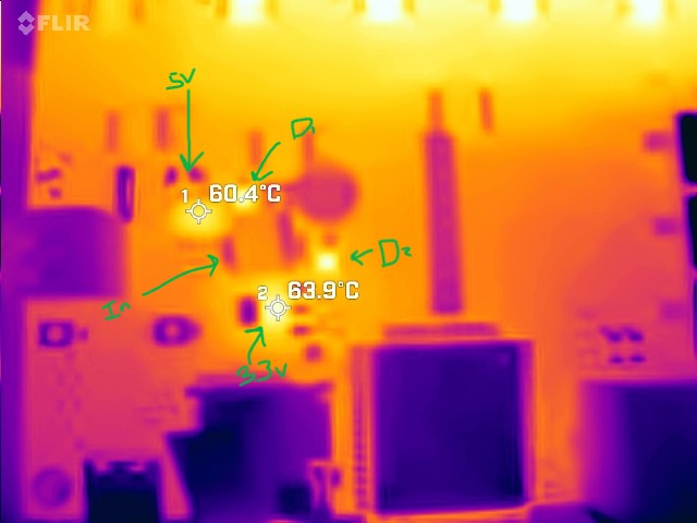

Okay so it is not the inductor. It is the regulators.
This one has been on for a few hours with zero airflow so worst case.
Should those diodes be working that hard?
That is only on gpio12, it is the only one that really matters.
I can’t help but wonder why the PS stuff is so warm, as in did I screw something up, I only added the diode, D2. On the other hand, the board itself is much much more warm because of the drivers that are sitting here cooking everything (no heatsinks on these right yet). So is it additive, or are the regulators just hotter (the surrounding pcb is only 7-8C cooler than the hot components)?

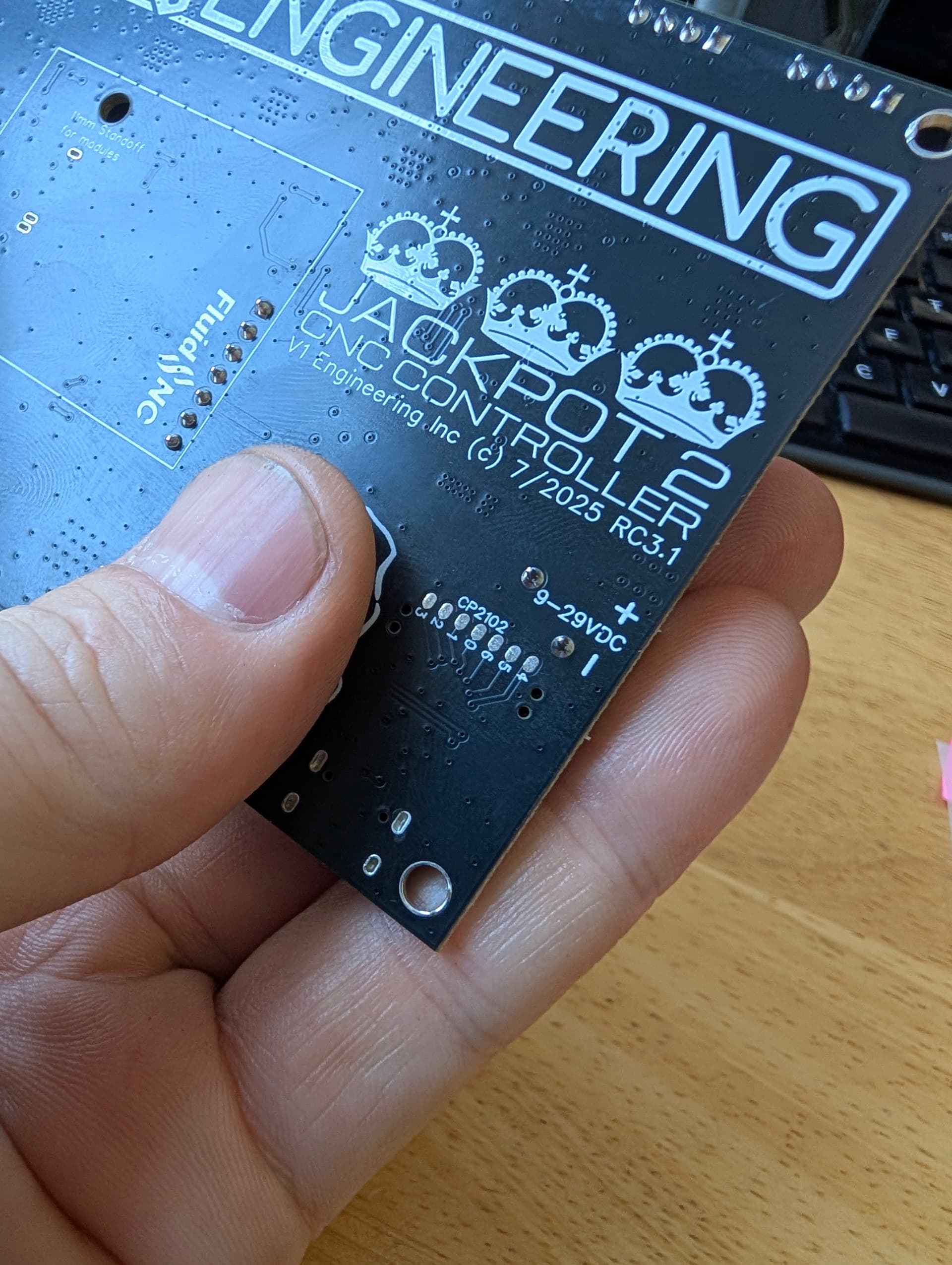

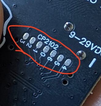

So for the rest of the discussion- what Ryan’s actually pointing out is that he did something really cool for me or anyone who does any funky testing with these things.
On the V1E ESP-32 module, Ryan broke out the extra IO on the CP2012 chip to pads, which means you can use those ESP-32s not only as ESP-32s, you can use that extra IO to do all kinds of cool test things with the module.
The V1 ESP-32s have thus gone into some really cool places that have nothing whatsoever to do with CNC machines.
Here, Ryan put those very same test points in the JackpotV2, so if someone were wanting to do some automated test of the system, it’s an option.
