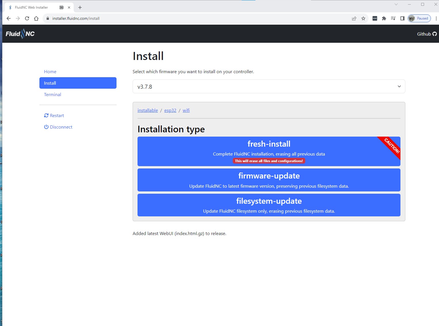

  1. update the firmware on the ESP32 to the 3.7.9 version.
    The only way I can seem to get access to the ESP32 is via the FluidNC Web Installer link listed on the V1 site, but I have to do it over a USB connection (virtual com3). It will not connect over the WiFi.
    I am unsure if I have to install some form of a WiFi software on the ESP32 or the exact process to do this.

Correct, webinstaller is hardwired.
Yes, I have updated the docs with a cut and paste section (you still might need to tweak depending on your laser)
I do not understand this question. The interface is on the ESP32 index.gz.html or whatever.
If the web installer does not say hold down the button you do not need to.

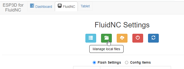

Once the firmware is flashed, you should see a “FluidNC” WiFi network that you can connect to.
If you can connect to that and navigate to http://fluidnc.local or http://192.168.0.1, you should be able to upload the config.yaml from the web interface and/or verify that it is there.
Make sure the config.yaml is going to the local file system and not the SD card. I made that mistake in the beginning.
If you use the web installer
The easy way is just firmware update, Although I like fresh install and reload all our files. That way everything is ne and fresh.

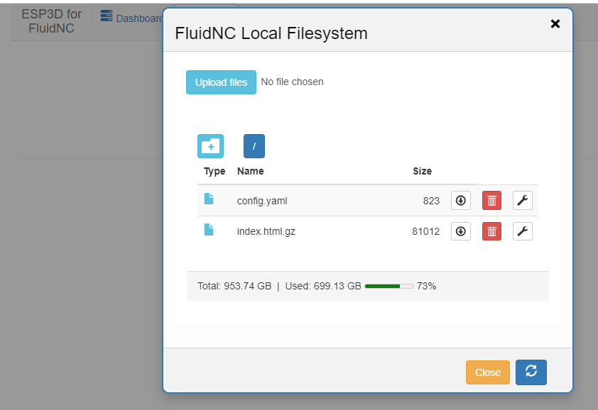

The following files are loaded as per the files tab in the web ui
config.yaml
favicon.ico
index.html.gz
preferences.json
All the files from GitHub - V1EngineeringInc/FluidNC_Configs: Configuration and support files for the FluidNC boards typically used and V1 Engineering
If you download the entire thing and unzip it you can get all the files for your machine.
