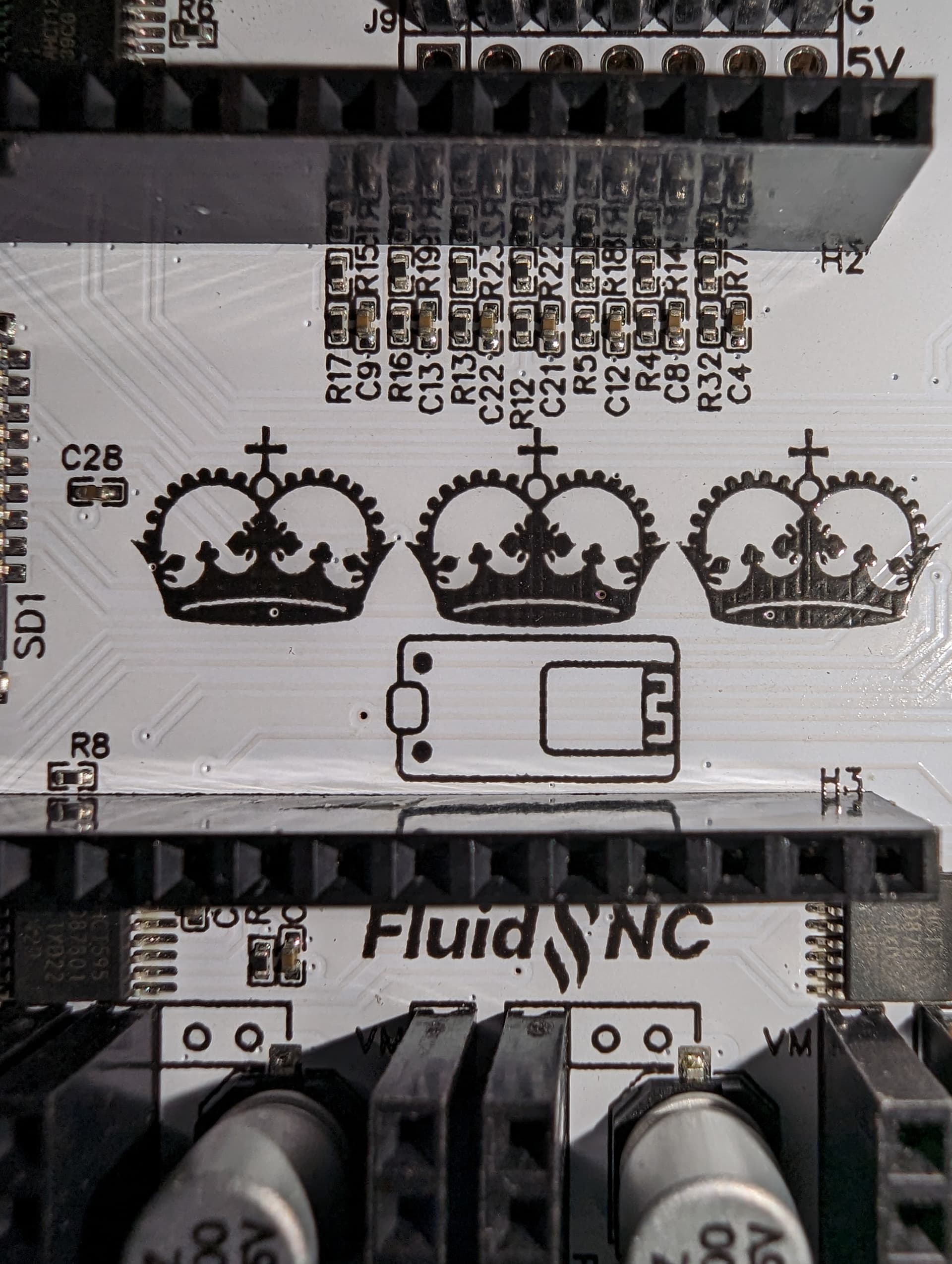

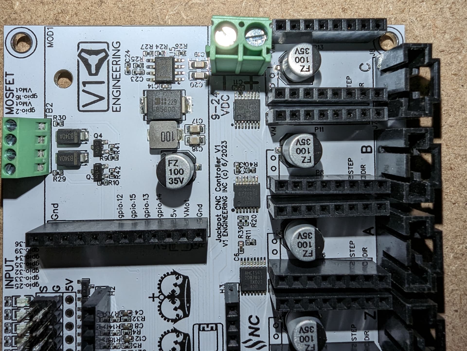

Hello everyone, I wonder if anyone has had a similar issue? I have just replaced my SKR Pro 1.2 with a jackpot, everything worked perfectly before the change. I have the correct configuration, I am 100% sure I have connected it correctly, and I’m receiving signals from all endstops. The symptoms I have are as follows: The X, Y1, and Z2 axes work as they should. However, the Y2 axis lacks power to the motor. The Z1 axis has power to the motor but doesn’t perform a pull-off when it reaches the endstop. I have tried moving Y2 from output (A) to output (C) and copied Y2 instructions in the config file to output (C), which gives me full functionality. I have also tried changing drivers to rule out any issues with them, but there is no difference. I have cleared the ESP and started over, reloaded the config but the exact same issue persists. I’ve ordered a new board from Ryan, but it will take a few weeks to arrive to north Sweden. If I can resolve this issue with the current board, I’ll use the new one for the next build.

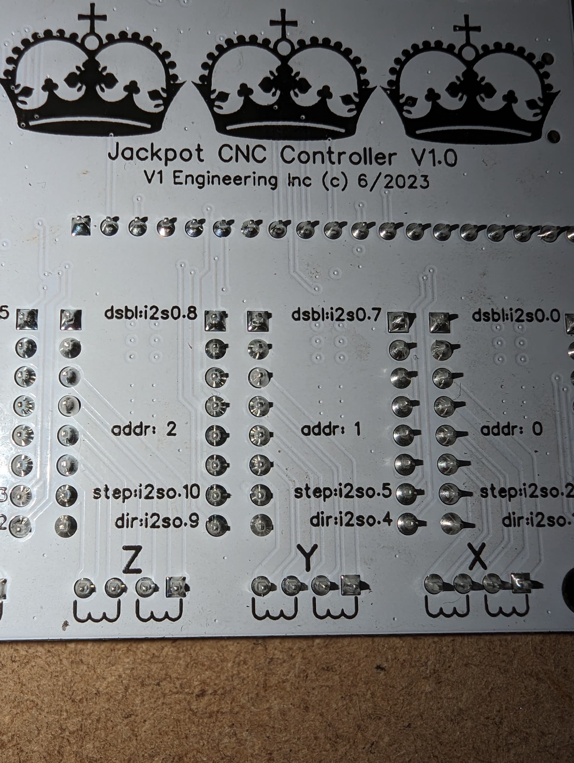

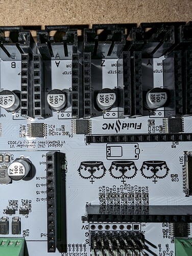

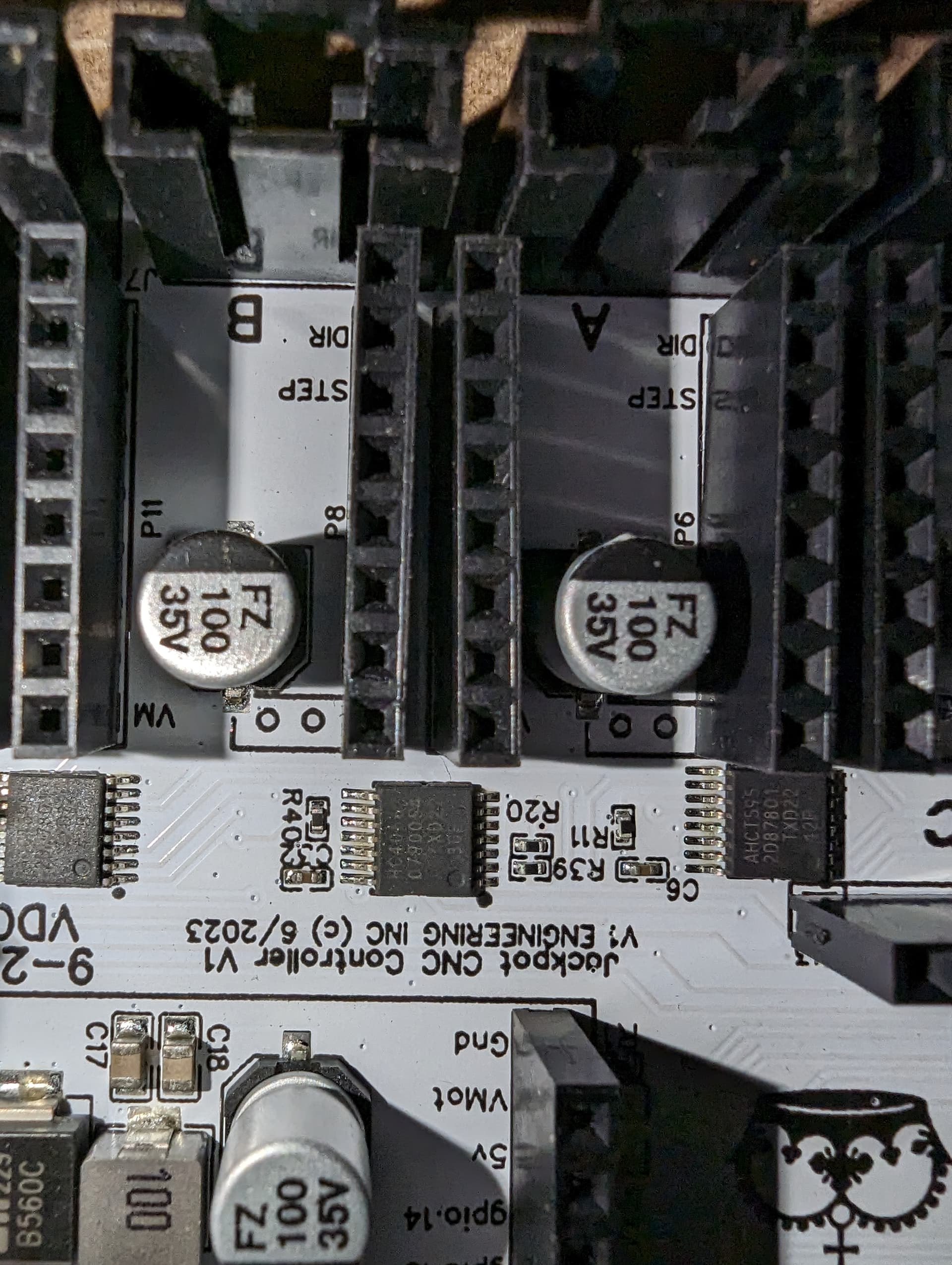

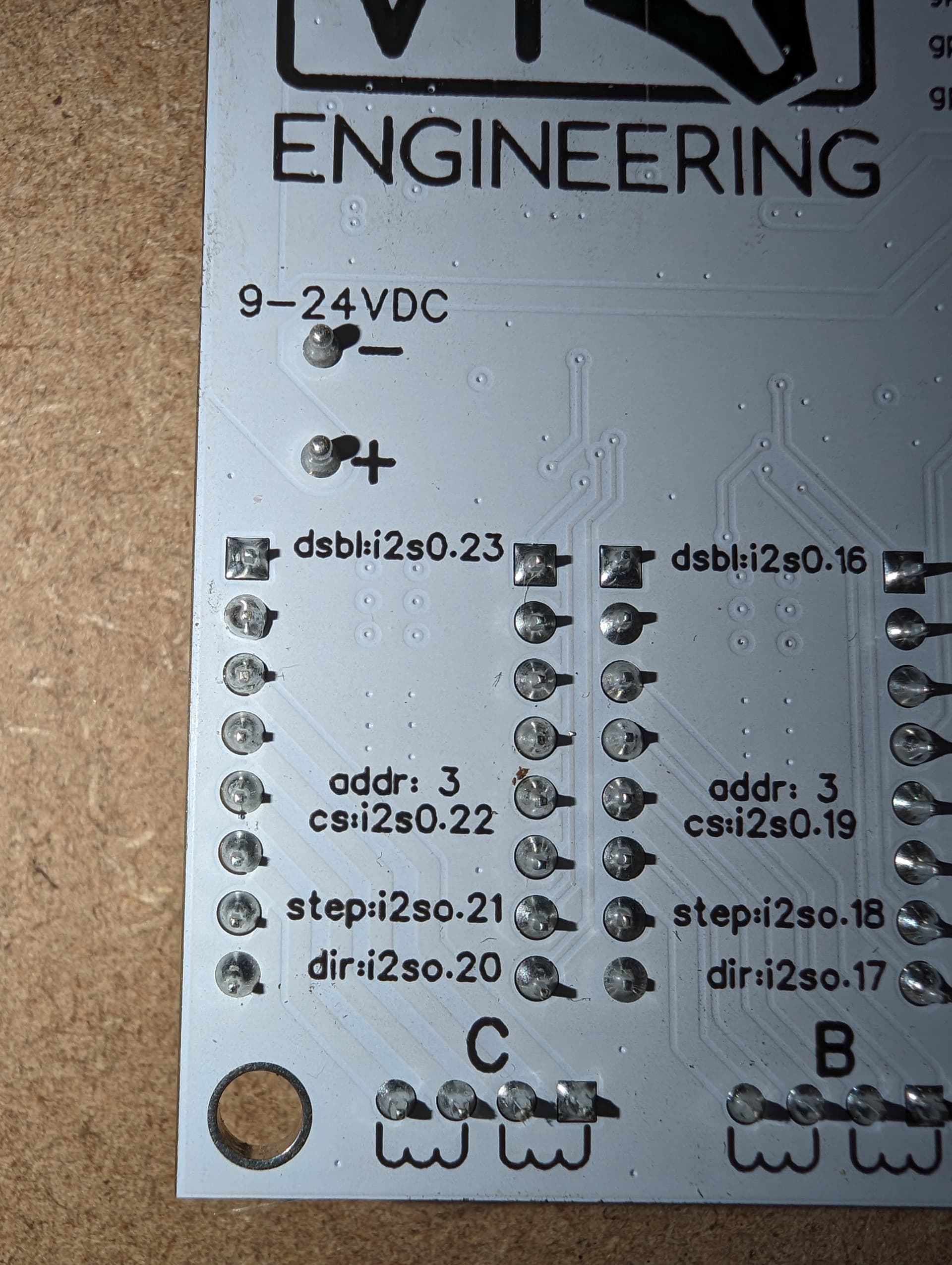

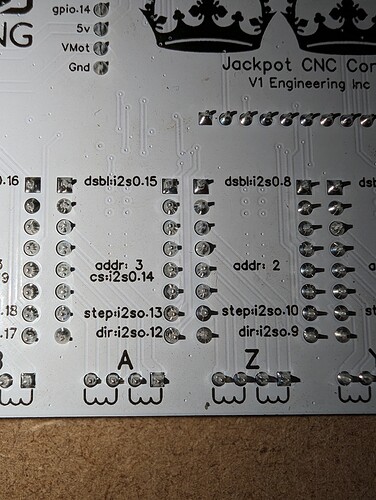

Can you send some clear high resolution pictures of your board, top and bottom so I can look for solder bridges.

Okay, lets try another option, the pics look okay.

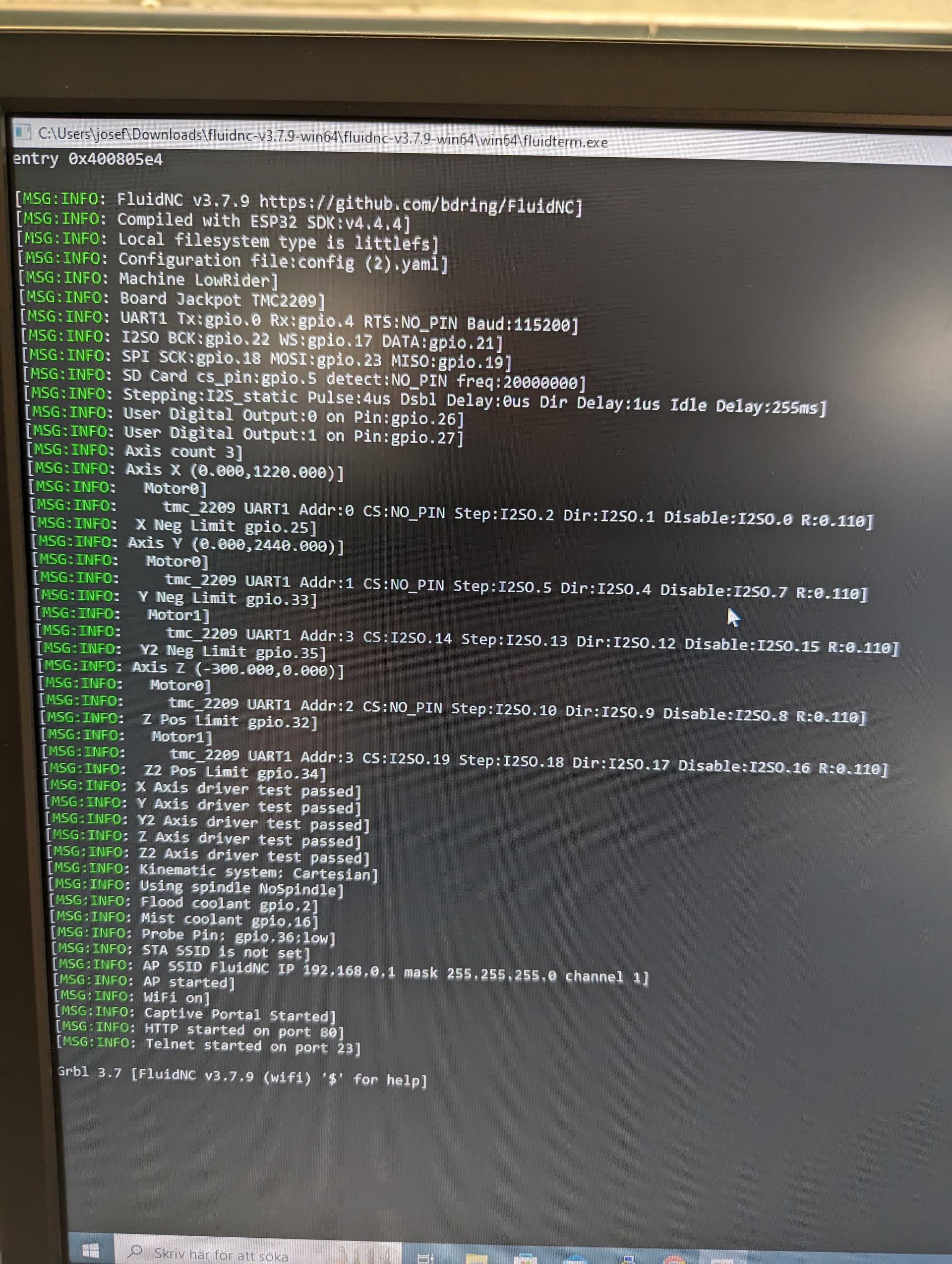

If you unzip this in the win64 there is a fluidterm program (Releases · bdring/FluidNC · GitHub). Can you run that and reset(ctrl r). Put up or screen shot the entire readout. The board does a diagnostic at boot.

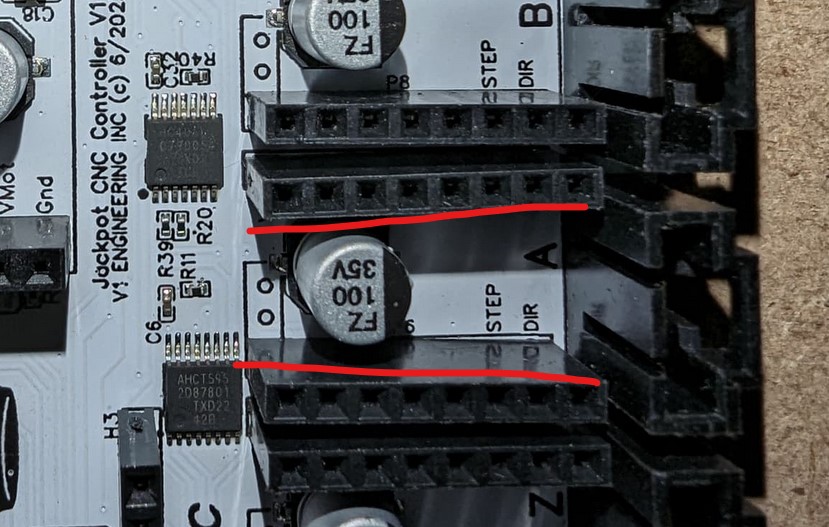

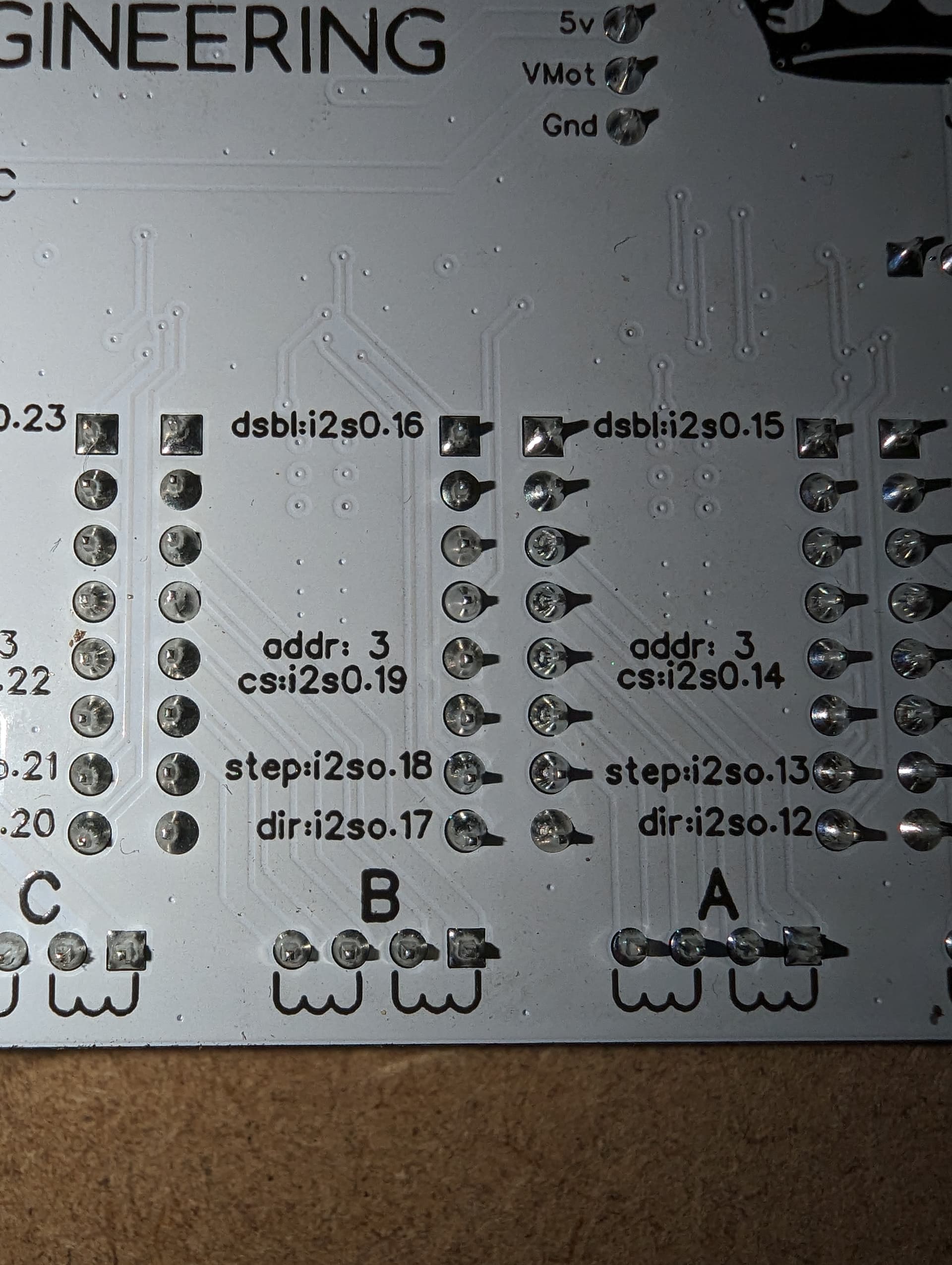

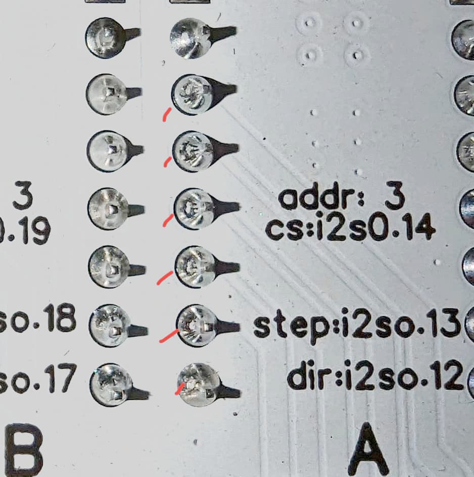

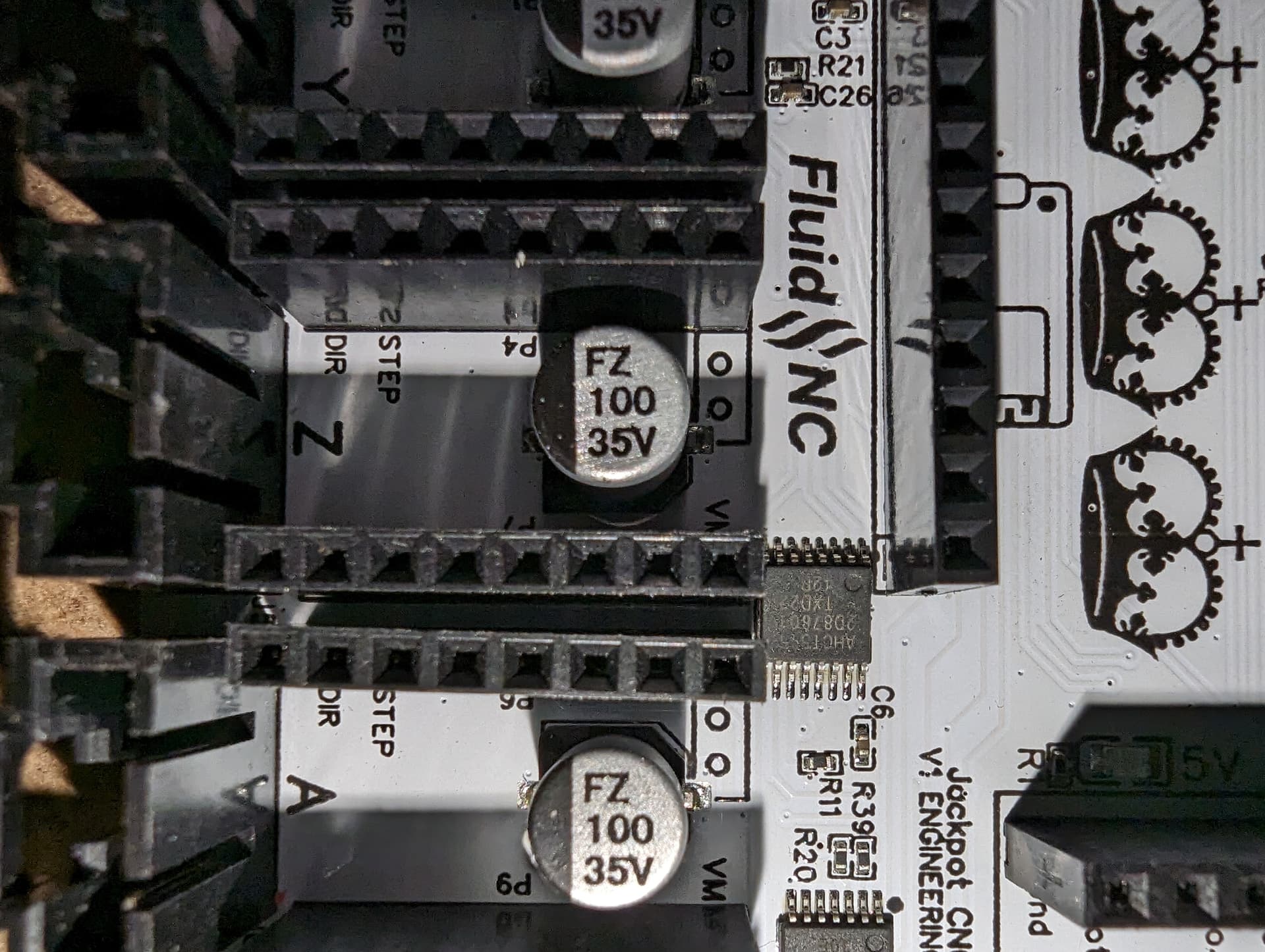

Is this a weird shadow or are these soldered poorly? A driver
These headers have a big slant on them. Are you sure the pins are getting in on both sides?

Sure looks like a crap solder to my untrained eye. But it also appears to be making a connection on the other side so I don’t think that would be enough to cause any actual problems.
Looks like a shadow.
Other picture looked different

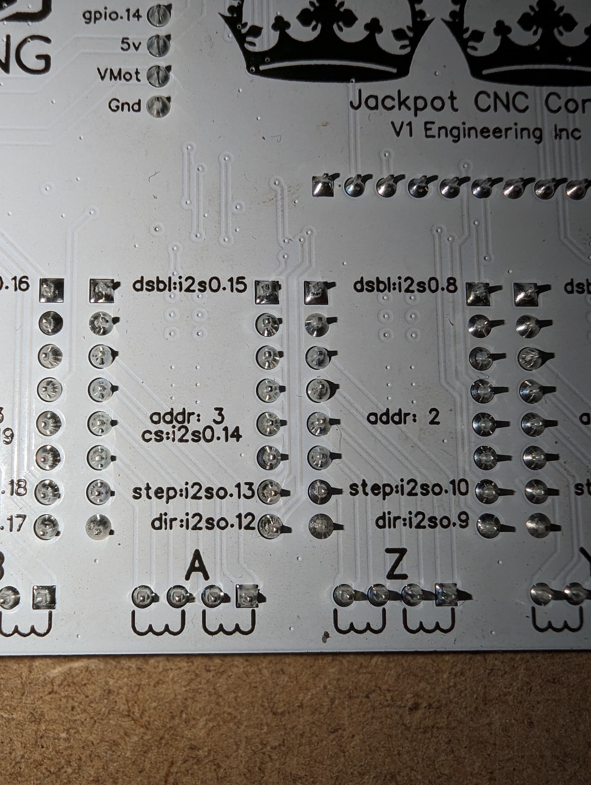

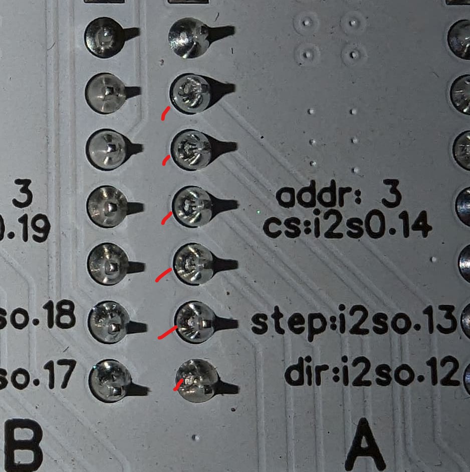

That’s also the stepper with the weirdly sloping headers, and the one misbehaving- right?

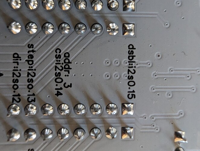

Using an overlay to brighten by converting a copied layer to greyscale, decreasing luminosity and adding contrast, and then inverting that- it still looks really crappy to me.

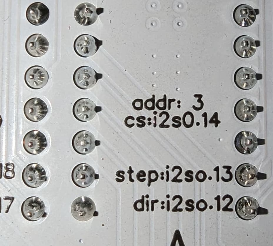

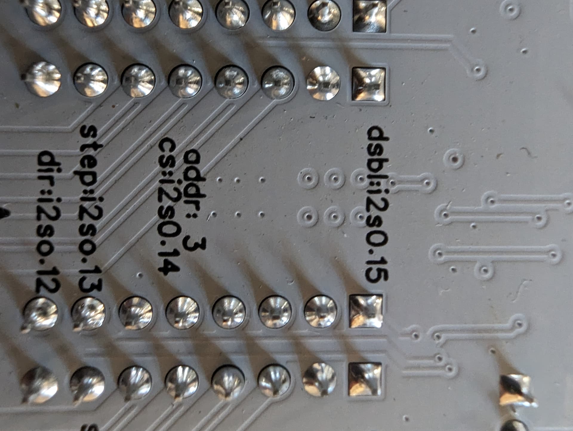

I’d like to see a better picture at a different angle of the A stepper header solder work.

The FluidNC boot looks clean to me at least for that one boot. if you reset it a few times, does it spit out errors occasionally?
The solder work still looks suspect to me in that latest photo.
When I see things like crooked connectors or possibly cold/bad solder workmanship, the whole hand assembly work for the board becomes suspect to me.
This is a strong indication that the problem is specific to the Y2 (Axis A) location, and that it probably isn’t the 2209/UART as if it was, we’d see an error on boot. You swapped drivers already so I dont think it is a bad 2209. Another reason to try a few more boots to look for any errors.

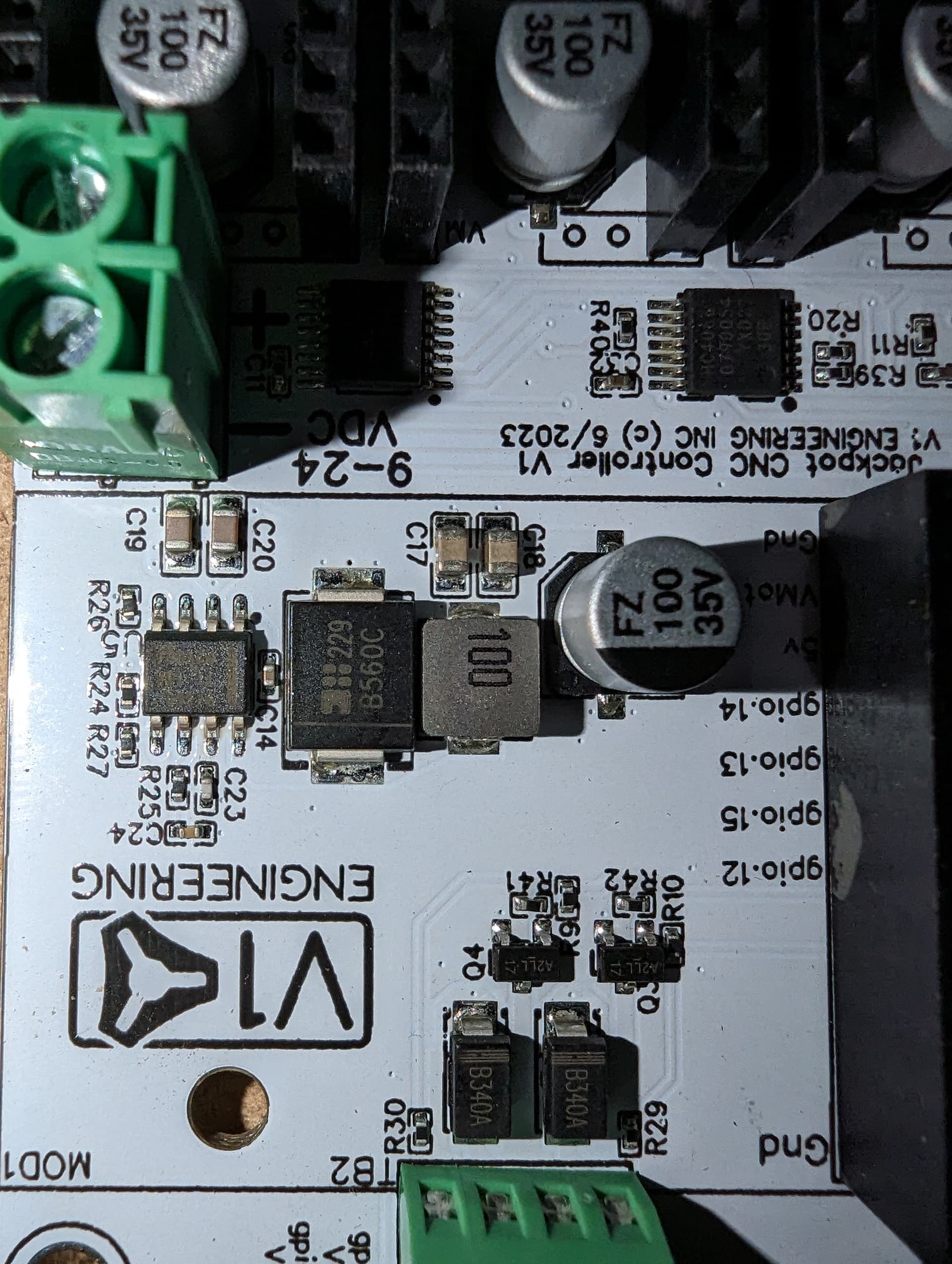

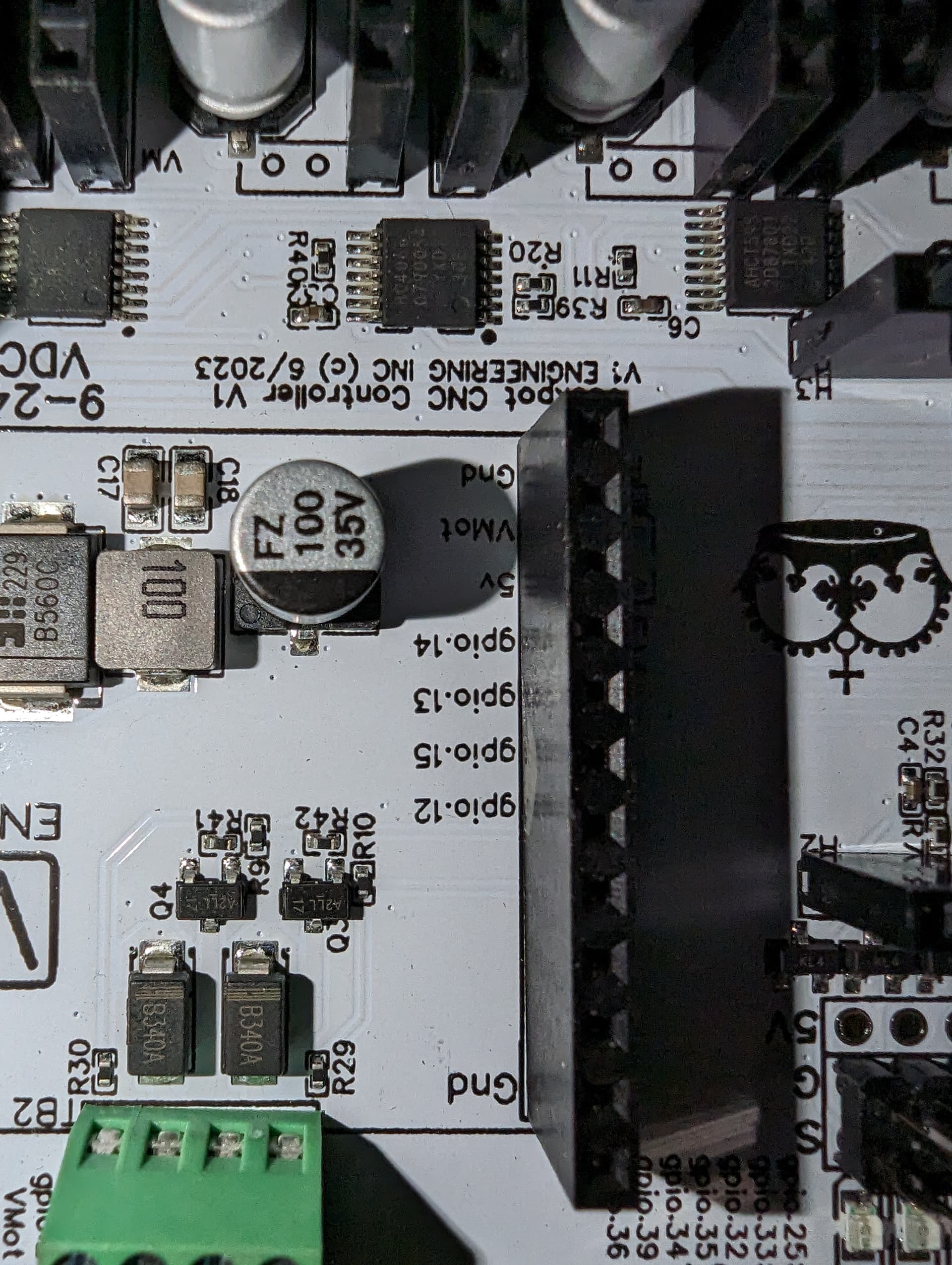

This also clears the Vin pin right? So that leaves Vmot and the outputs. It can’t be all 4 outputs if even two worked there would be some sort of resistance at the stepper, right? Even if the big cap had an issue it would still be fine since the Vmot is still connected dirctly to power.
