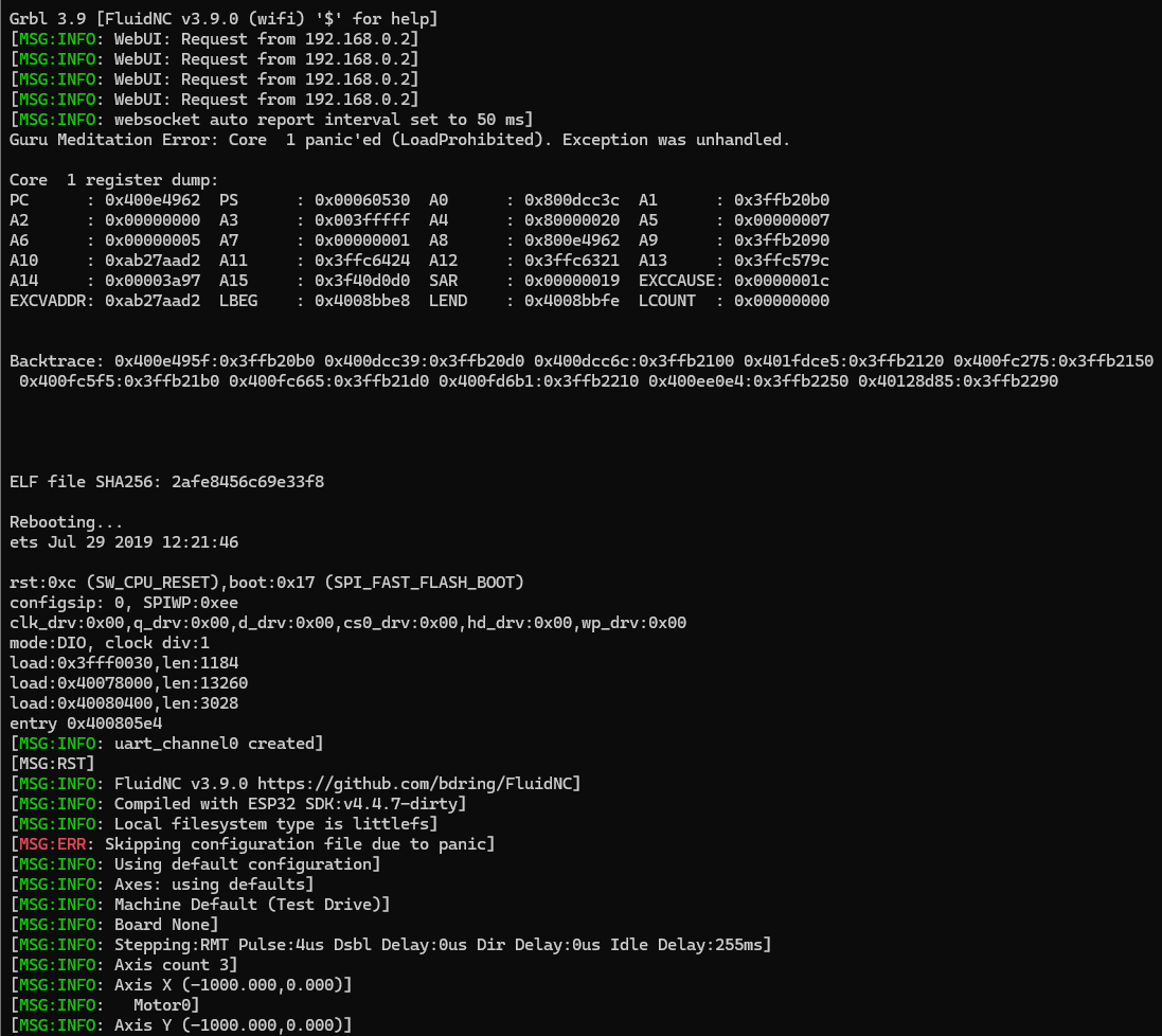

Ummmm, I am having a problem.
I am re-flashing and trying again before I report anything.
If I try to run a file from the SD, nothing happens.
Know good board, known good file.
Tried a new board, same file Boots fine, hit go it reboots, and looks like this.
I can save a lightburn file gcode and try to run that on the JL1.
Your SD card is also known good?
