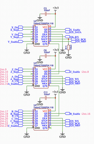

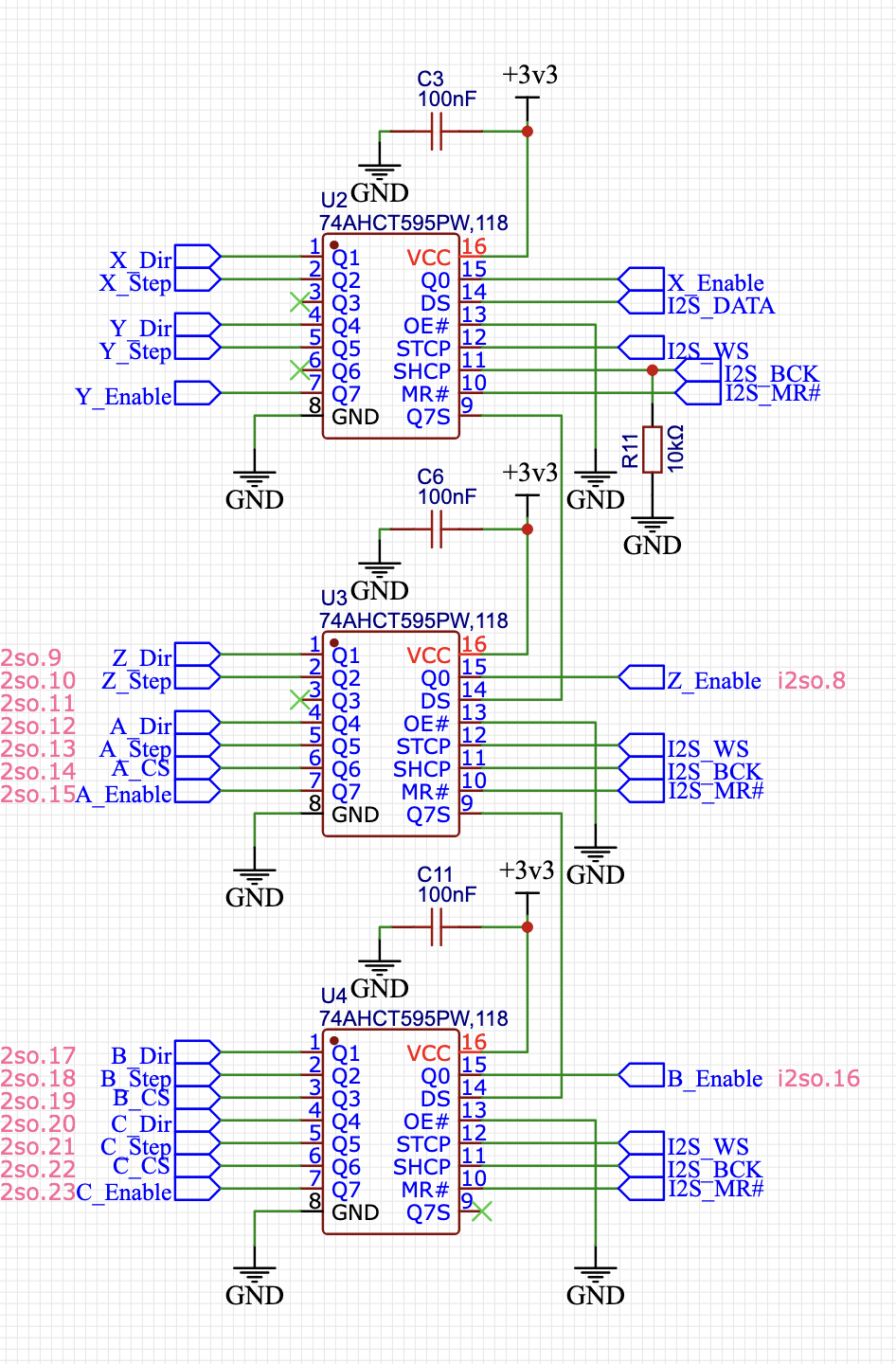

On Jackpot, the first two stepper (X, Y) are on the first mux I2S chip.
Adding Z and A then uses two mux chips.
Adding B and C then uses all three mux chips.
I bet this has to do with he ESP-32 built in I2S bit clocking acceleration that is THE enabling feature for FluidNC supporting 6 stepper drivers.
The JL1 configuration doesn’t need to clock any bits out to anywhere but the first chip.

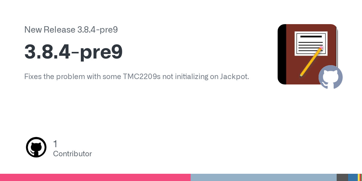

Fix for the Jackpot driver initialization problem is out as pre9. I’ll try it later this evening.
I’ll put this on the JL1 this evening as well.

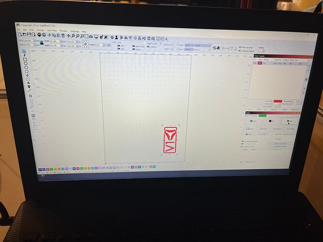

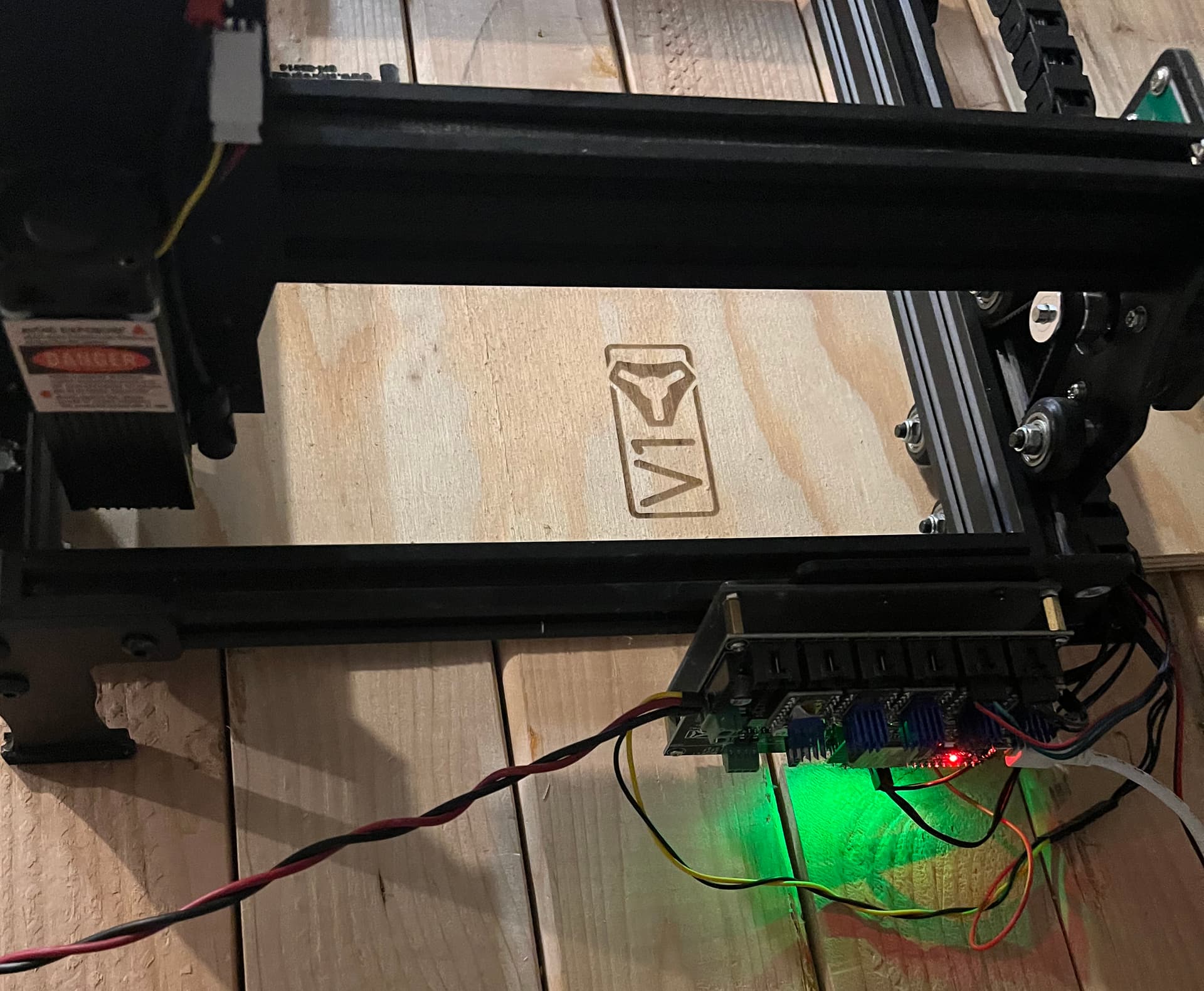

OK, so I loaded up Pre9 this evening on the JL1.
Drove around moves and trying to get a webUI crash with reloads and stuff, couldn’t.

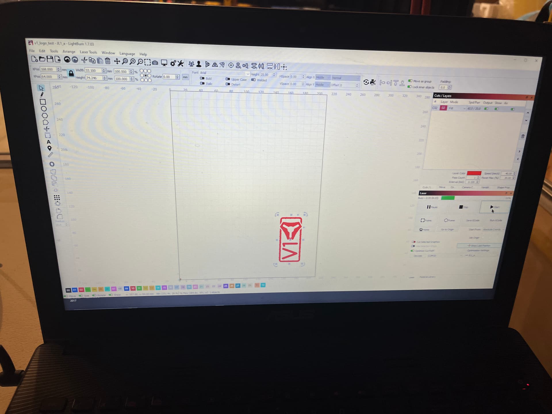

Busted out my old Windows Laptop and updated to the latest LightBurn.
Threw in a quick test pattern.
I still have the JL1 partially apart from using it as a testbed for my stacking pendant adapter (lets you use a pendant and still have the lower 2 GPIOs pass through so it can e.g. run an isolated RS-485 spindle.)
Didn’t bother to position the scrap plywood I threw in, and pardon the mess… but repeated this several times:
So at least from the standpoint of laser ops on my JL1, this is working fine.

The latest release is 3.8.4-pre9 as described above. The issues you describe are part of known bugs, with the known stable release prior to this being 3.7.17. Anything between these up to 3.8.4-pr8 have significant issues.
Link to the latest pre-release which seems to be fixed:
3.8.4-pre9

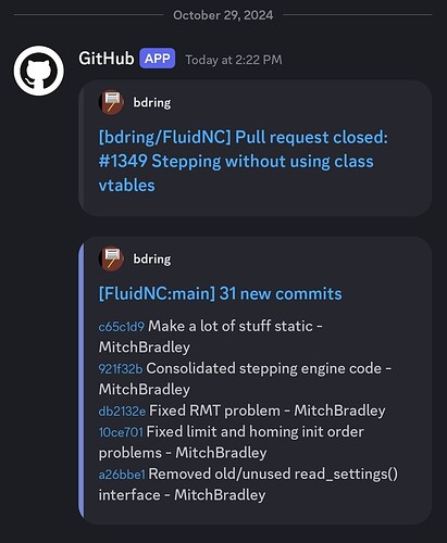

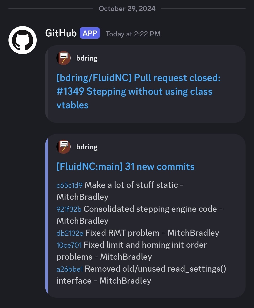

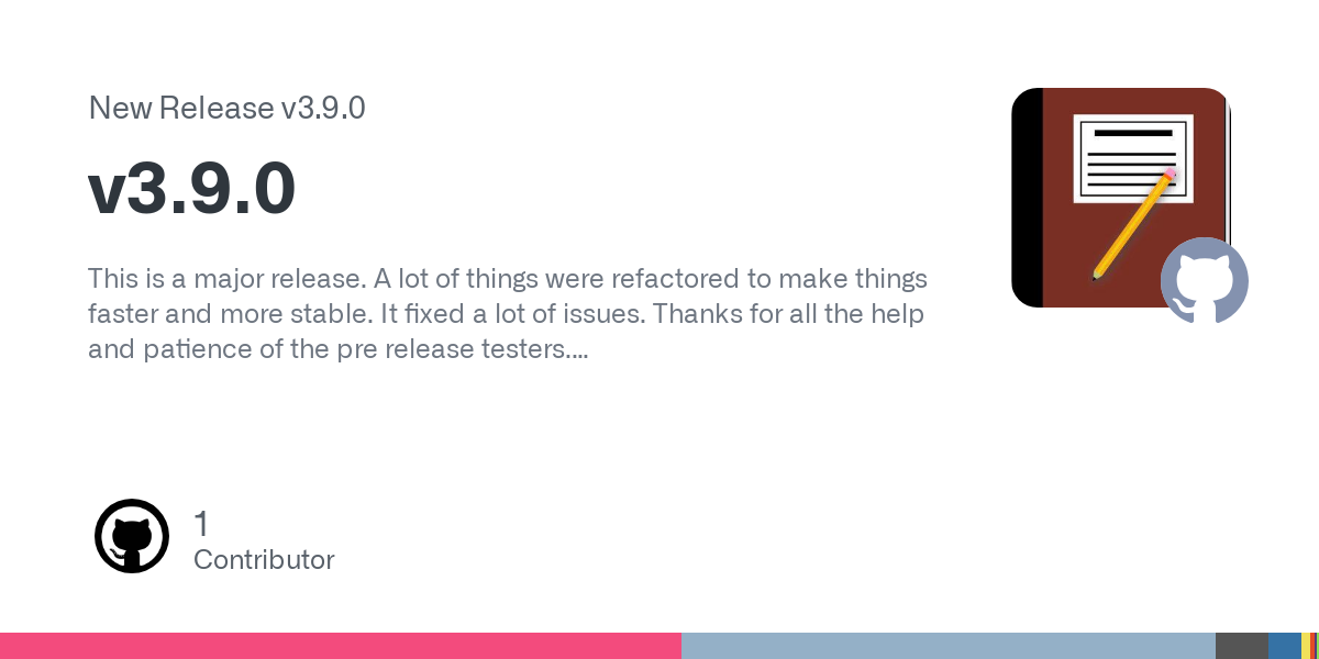

Ooh. I think the official release is coming. This all just got merged to main.
Well, at least this isn’t introduced with a 3.8 version. Hopefully it’s just some kind of config.
Hooray! Released as 3.9.0
