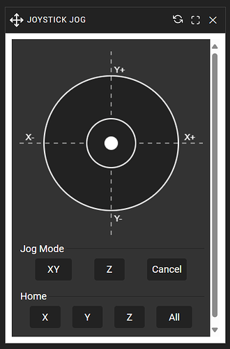

I thought I used that version but will try upload again. Might be something I’ve messed up with the css to cause that tbh. Here’s the file if you want to check.
theme-V1E (Dark) - Dan.gz.zip (4.2 KB)

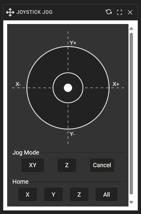

You must be using a different version of WebUI v3 than me. One of the things that changed in the latest version is extension borders. It changed other extension related things that messed things up too. It’s slowed down but there for awhile WebUI v3 was a bit of a moving target.
When I load your version, the extension looks like this:
For reference, I’m using the latest WebUI v3 build here. It messed up formatting when it came out and I had to make changes. I did my best to keep my themes and extensions still looking good on previous versions.
