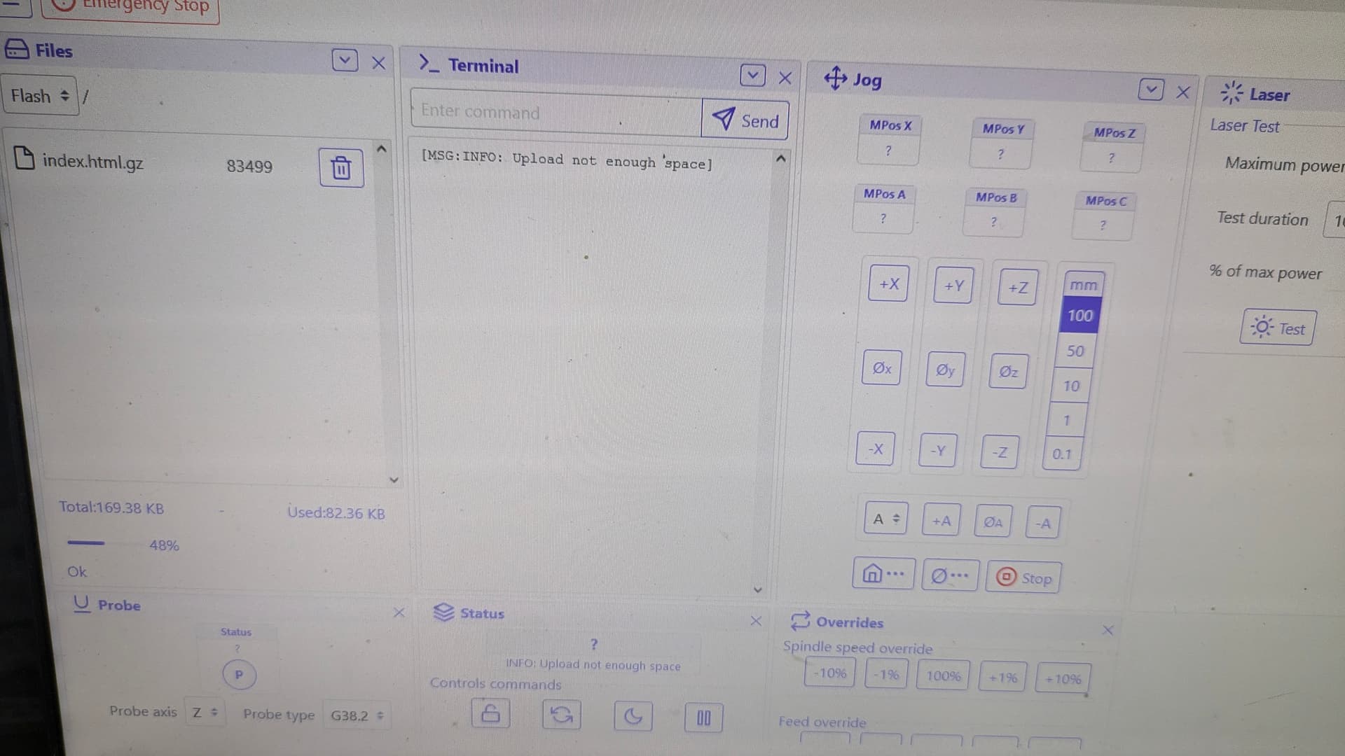

Must say: not a fan of the V3 WebUI. Getting errors to upload my config.yaml

How big is it???
“not enough space” is coming from FluidNC, not the WebUI itself
I know it’s unpopular, but for testing I always use the native OS installers to do test loads.
Run
erase.bat (or .sh)
inststall-wifi
install-fs
Then re-uplink the config files, v1 stuff, and the index.html.gz.

The files im trying to upload are the ones downloaded from the v1 LR v3 github.

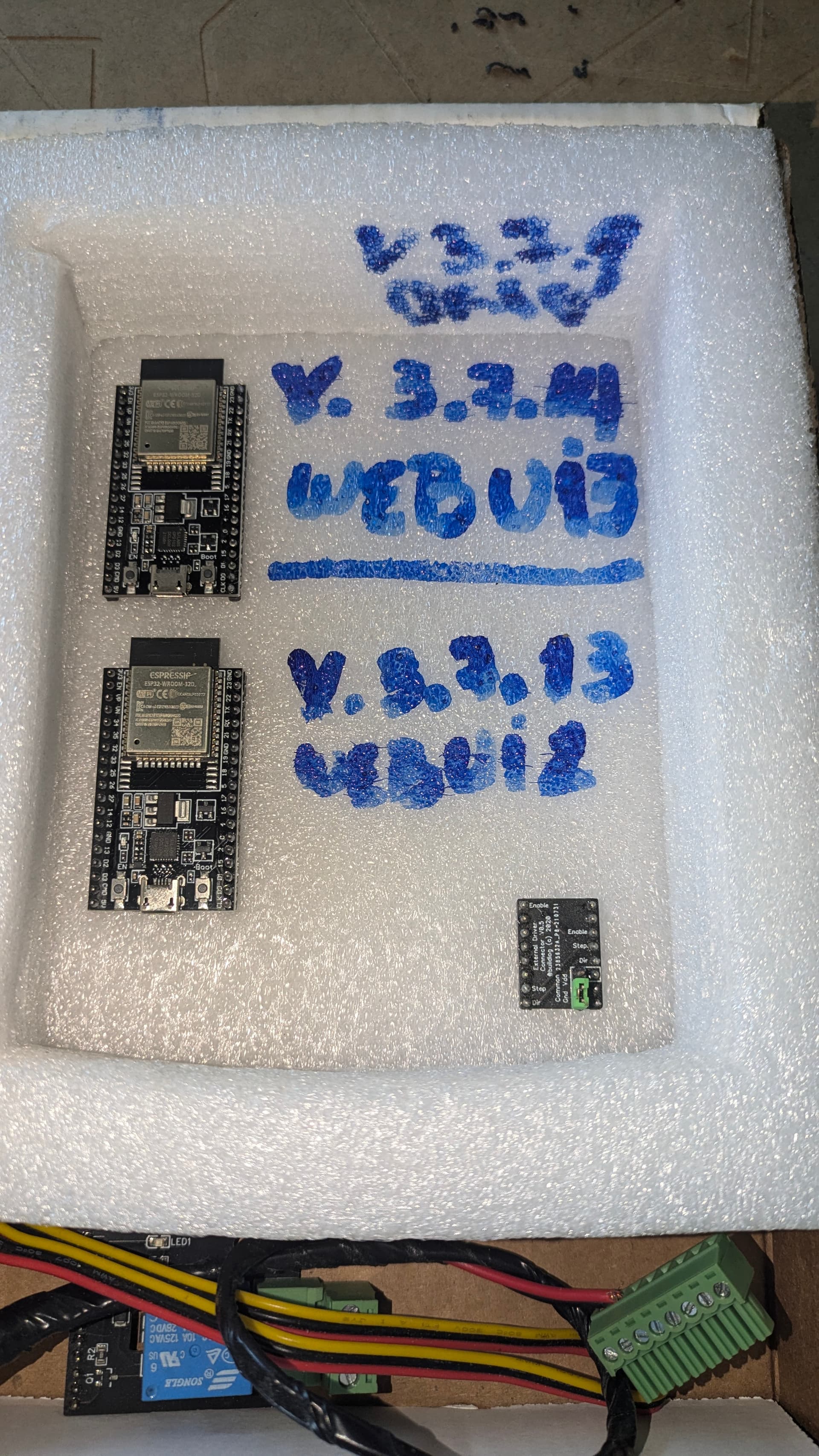

So, any particular thing you guys wanted to be tested with this version of fluid?
@azab2c 's scenarios- going into setup causing a crash, not being able to recover from a pause or reload- I’m not as immersed in all the scenarios, but he had outline a number of them.

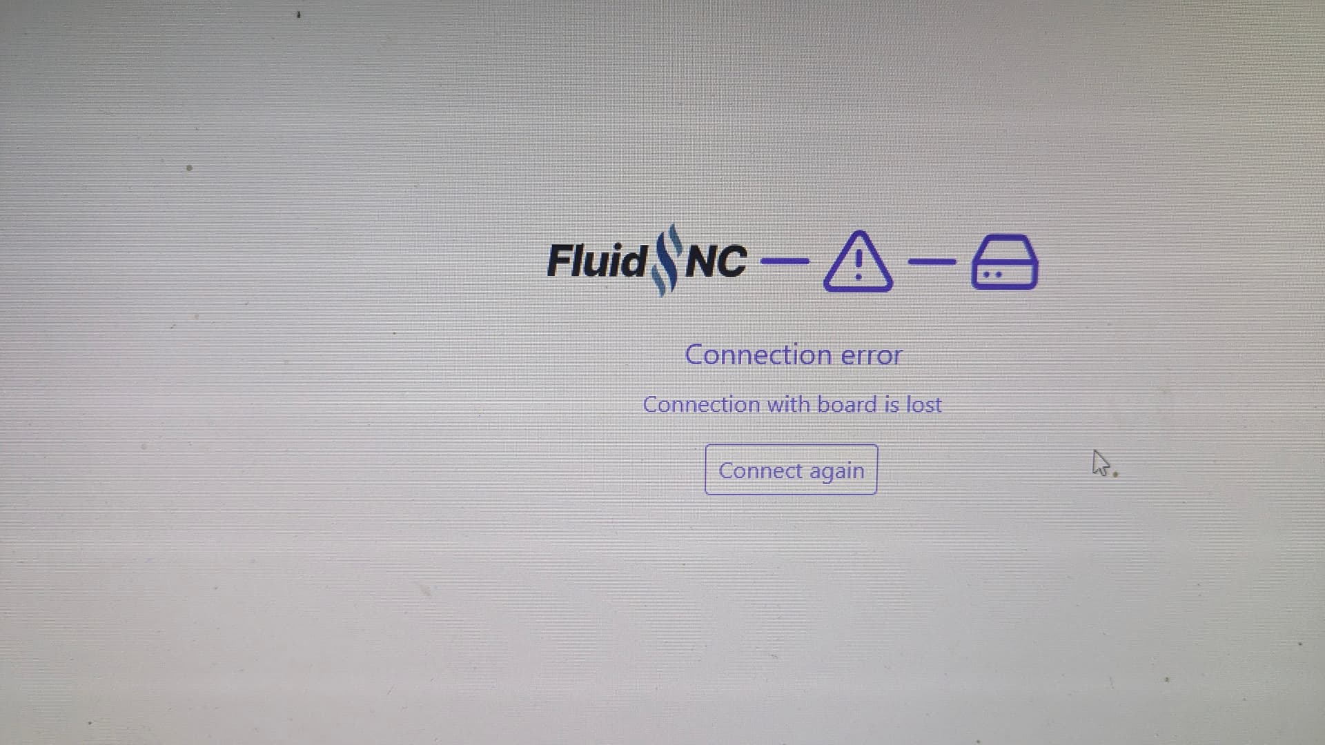

Yep, still going with it. Can confirm the issues, settings tab causes :lock: (cant speak about the old cersion i regularly use )
reloading pages also.
Will be downgrading 1 version at times until i get one that doesn’t do it
My suggestion is: To find a stable version that works for the most of the users and the rest to update their boards at they own risk. Some of us can commit to test new versions to see if they are stable enough. (I dont update regularly but i can buy a new jackpot just for this.)

This is all a bit confusing because in my view, there are really 3 different issues going on here:
  1. Reloading the WebUI, depending on FluidNC version, will either kill the job or display that basic screen. This issue at least has to do with reading the index.html.gz off Flash. If you can keep your browser open for the duration of the job, this shouldn’t be an issue.
  2. Clicking on the Settings tab will kill the job. This is similar to #1 but I think it’s different. When you click on the Settings tab (at least on v3), it’s sending an ESP400 command to retrieve FluidNC settings which I think may include reading the config.yaml file off Flash. I think if it could default to the ESP3D Interface tab, it wouldn’t crash until you selected a different Settings tab. Workaround is don’t do that.
  3. After running for some period of time or in some condition, it will crash. I don’t know much about this one.

Jason, have you had the settings page crash the Jackpot? I ask because you said you use VS Code to install FluidNC to take advantage of the 8MB on Ryan’s ESP. I do too and I haven’t had Fluid crash. I don’t go clicking all over the webpage either.
In general, I don’t click Settings when running a job, but it will crash it for me. Note that it only loads the settings once, so if you click Settings before running a job, then run a job and click Settings again, it won’t crash.
