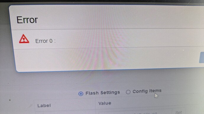

I haven’t done a 3d carve job in ages, thats not my line of work. That said you can trigger the error with simple code exectuting and just open the config window and hit the esp32 file tab. Throws me an error
BTW this is 3.7.18
Will try now with my old trusted version in use (but i still can’t put my head into messing with the config files while running a job)
