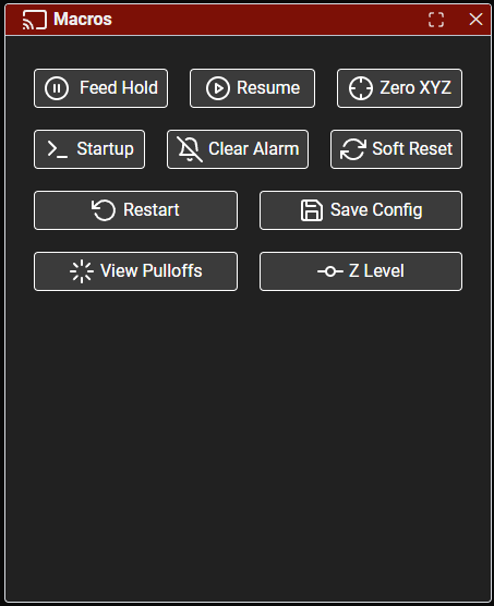

The only non-related theme change I made was to the Macro panel. I’ve been messing with macros lately so I made them have more of a grid layout and added some spacing. It varies based on width:

Is your “Clear Alarm” macro just executing $X or $Alarm/Disable?
If so, this “Unlock” command issues the same command.
I’m working on getting the text on those buttons to be clearer as to what they are executing
This would be wonderful.
Yes. I know it’s the same as the unlock button. I was just fiddling with macros and considering making my own version of the status panel. No intentions of doing that at the moment.
Ok, just checking. I had never actually looked to see what those other buttons did. :slight_smile:
The Sleep button doesn’t do anything for us, so I’m going to look into maybe replacing it with something that’s actually useful for us.
