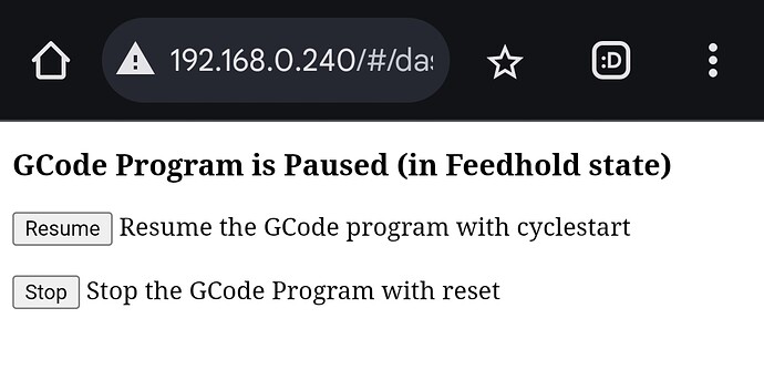

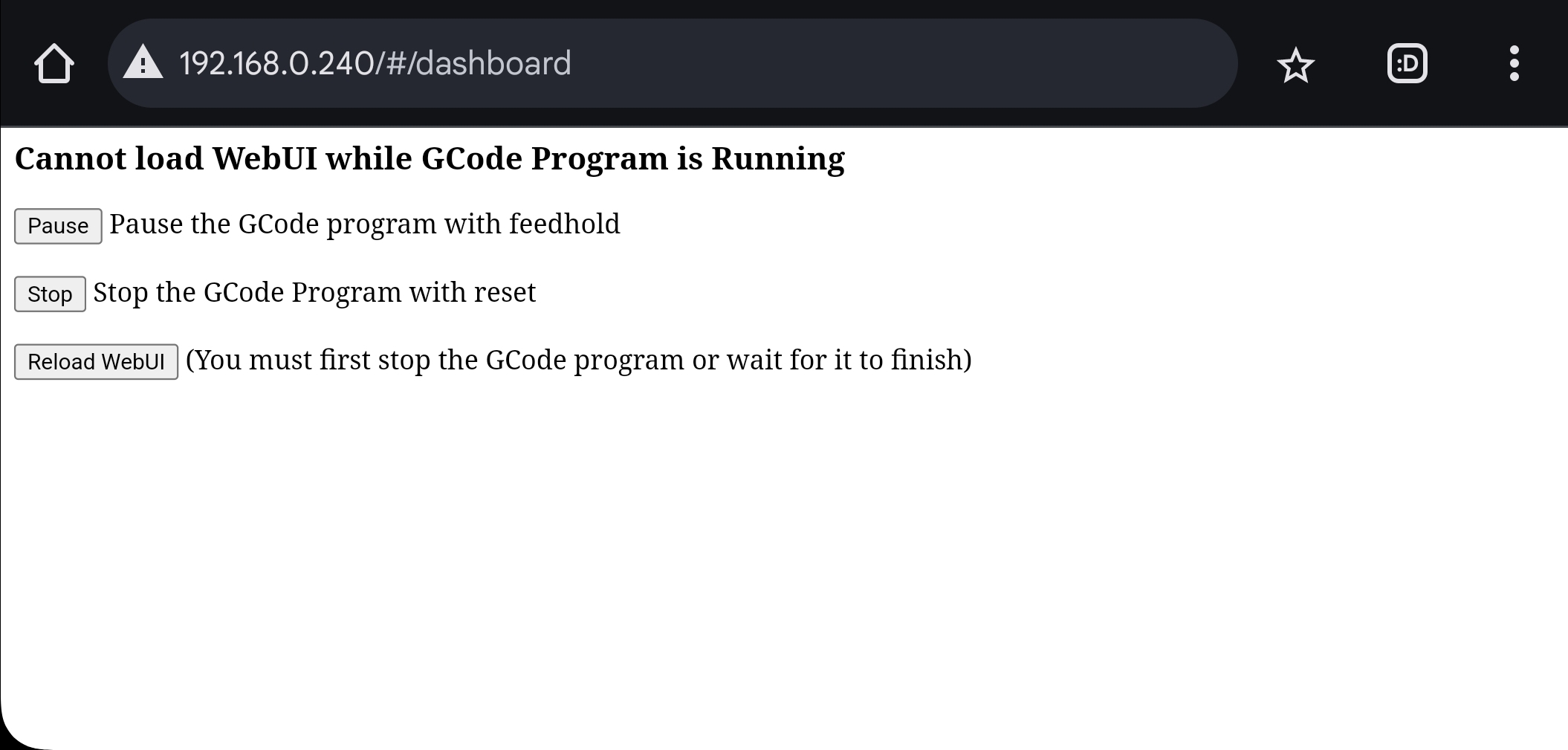

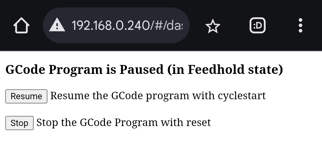

Yuck. The 3.8.3 change I mentioned about preventing the UI from reloading if a job is being run means that you can’t get back to the UI until the job is complete or you stop the job. I’m assuming this means you couldn’t do a tool change.
The alternative seems to be crashing it.
Does a pause count as stopping the gcode program?
No. I could have lived with that.
It does allow you to resume from that special page though.
I wonder if a tool change will cause that window to pop up and let you do what’s needed. Thankfully I added a fluid dial recently so I don’t hardly use the webui anymore
I assume the screen would let you do what is needed. You only need some sort of UI to resume. If the WebUI was up the whole time, it would still work.
I am pretty sure that does not show up when it is paused waiting for a tool change. That used to be there and I have not seen it in a while. It used to only show up if I refreshed accidentally too many times (bad swipes on the touch screen).
This was changed in 3.8.3. I’m pretty sure it will show that screen for a tool change. For a quick test, I ran the crown file in the air, paused from the UI, then refreshed and got that page. Unless M0 is handled differently than a feedhold.

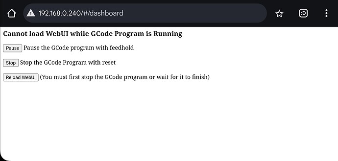

With 3.8.0 - 3.8.3
  • Clicking on Settings during a cut will kill your job.
With 3.8.0 - 3.8.2
  • Reloading web pages during a cut will kill your job.
  • Losing network connectivity long enough to result in “Connection Lost” (takes ~1min?) results in not being able to view regular dashboard until job is complete. You end up with the crappy pages that Jason screen capped in earlier post. Those pages may not be pretty, but they help protect continued execution of your job.
Workaround: Don’t touch anything, or :rubberduck: around when running a job, make sure your browser device is close to jackpot throughout the cut. Consider 3.8.3 if you need features from 3.8.0 or newer. Some 3.7.x version may be better option :man_shrugging:. Note I’m new to FluidNC and don’t know enough about FluidNC to have a high confidence opinion.
