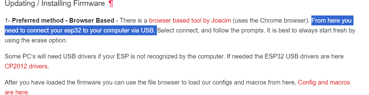

Noticed https://docs.v1e.com/electronics/jackpot/#updating-installing-firmware contains…
Flashing issues - Remove the ESP32 from the Jackpot and try the web based installer again
Can we connect and flash a USB wire connected ESP32, while it’s mounted to a 24v powered Jackpot board? Or, must the ESP32 be removed before flashing or connecting USB wire?
Would like to make fast edits/updates for fully wired (and powered) test rig.
That is the troubleshooting section. To flash, USB only, do not power up the 24v use the web tool. It was updated yesterday and is working a bit better again.

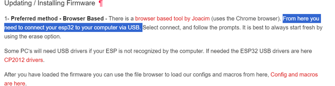

Doc currently says…
I’ll take a stab at clarifying and submit pull request, hope that helps!
What is unclear about that?
Unclear whether ESP32 needs to be removed from Jackpot during flashing.
Was unclear whether Jackpot main 24V power needs to be powered off. But you clarified a few mins ago.
I’m ASSuming ESP32 can remain mounted to Jackpot during USB flashing, but Jackpot 24V supply should be deenergized/powered off? Guessing ok to remain plugged in while powered off to remain grounded.
Yup it works either way so no big deal.

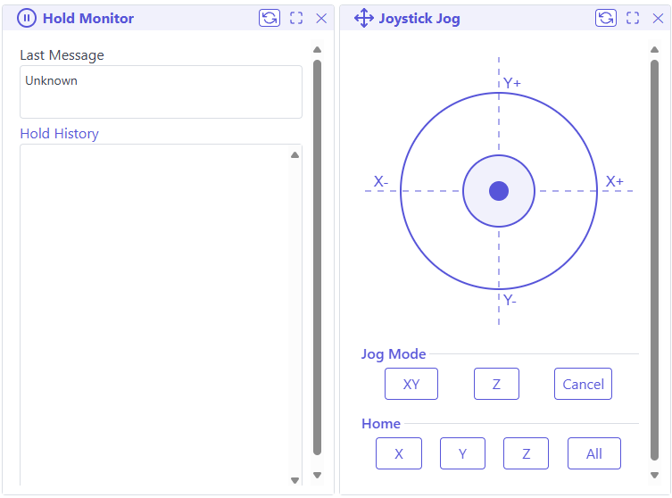

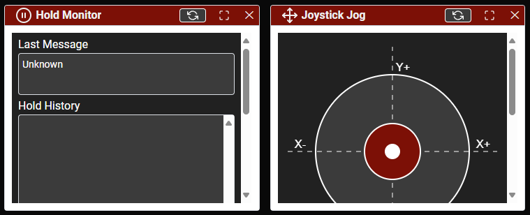

Yea, it messed up my extensions. I’ll have to see what changes I need to make.
Also connected to my theme, looks less messed up without one.

After some investigation, the persistent extensions does mean that they stay loaded. Before, if you switched between the dashboard, then the settings page or a page extension and back to the dashboard it would reload. Similarly, if you had a page extension and switched away and back it would reload. This is helpful depending on the extension. It also means that it’s loading all extensions on page load instead of just panel extensions. So, for something like my hold monitor, if you don’t want it taking up space on the dashboard, you could just make it a page extension and the hold popups would still occur. Otherwise, that would only work if that page extension was active. That’s useful.
I’m a bit annoyed at the moment that as part of this, it’s doing some weird things for how it’s setting size and position of panel (dashboard) extensions. It also adds a 10px padding to the content of an panel extension that you can only override in a theme. So, basically, I have to size things to deal with that extra space so it looks reasonable in my themes and in the base theme. It also means that a feature of my theme where it would allow dashboard panels to shrink if they didn’t need the full size (like Status, Terminal, Macros) is now no longer possible.

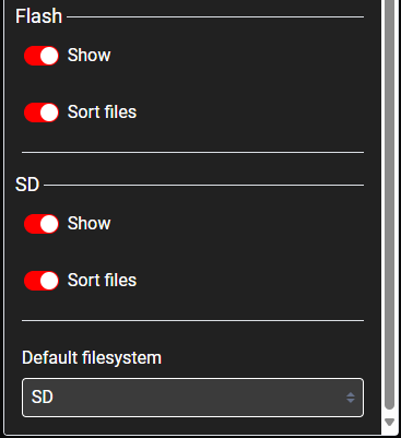

There is another new feature that allows you to specify the default filesystem for the Files panel. So, now instead of defaulting to Flash, it defaults to SD which makes more sense. However, there’s also an optional “Sort files” option for Flash and SD. It seems to sort properly for Flash, but not SD.
The flash vs SD stuff I thought was already there in the previous version.

Maybe but I don’t remember the SD sorting being messed up.

This is a WebUI issue with the FluidNC specific code. Although, it looks like it duplicates the GRBL code which I assume is also wrong.
It has to do with having a config setting named “sort_sd_files” vs “sort_directsd_files”. So, it can be fixed by either updating src\targets\CNC\FluidNC\DIRECTSD-source.js or src\targets\CNC\FluidNC\preferences.json so they use the same config value. I’m not sure which is more appropriate but changing either fixes the problem.
