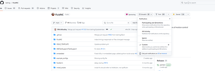

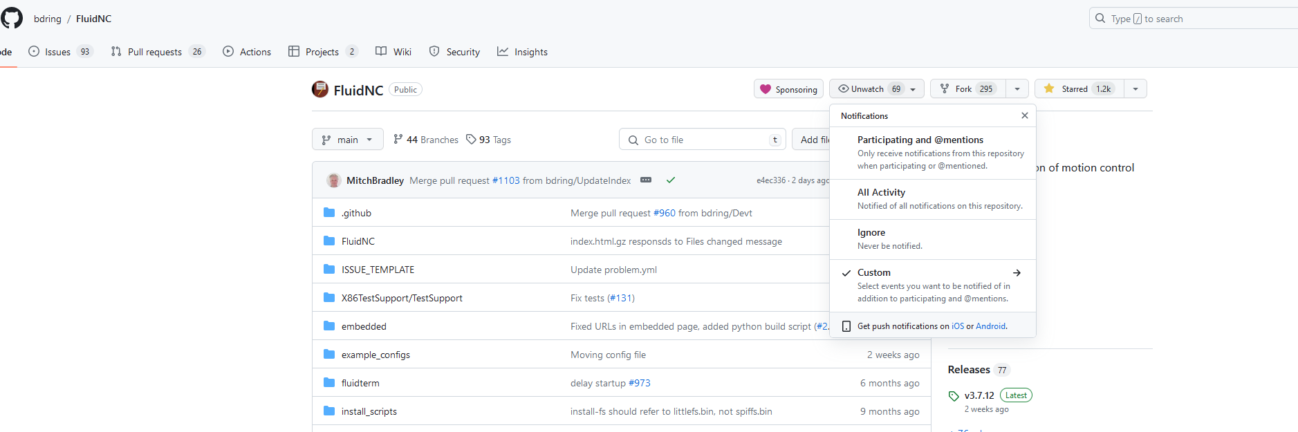

If you are interested in helping out you can get FluidNC release notifications here, GitHub - bdring/FluidNC: The next generation of motion control firmware
in the custom settings for “watching”.
When a new version comes out load it up and give it a shot. Post your results below with something like “3.7.12, did a probe and some milling, also ran $ss, no issues” or “3.7.12, laser etching, no issues”. If you do find an issue put as many details as you can so someone can try to replicate it.

I get fluidnc release notifications so I try to load it before any CNC work I do. If you all want to do the same then just drop your results here when you get them, that makes it super easy. GitHub - bdring/FluidNC: The next generation of motion control firmware
This is where you set that.

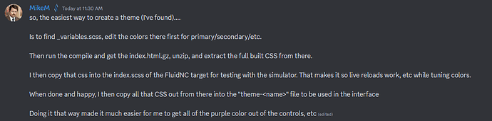

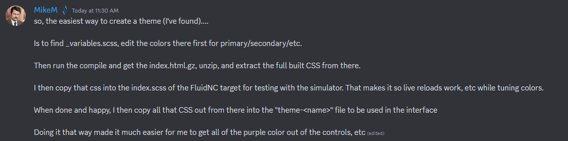

If you’d like to try your hand at creating a dark theme, then I posted this on the FluidNC Discord previously
You would do all of this with the ESP3D WebUI 3.0 branch
