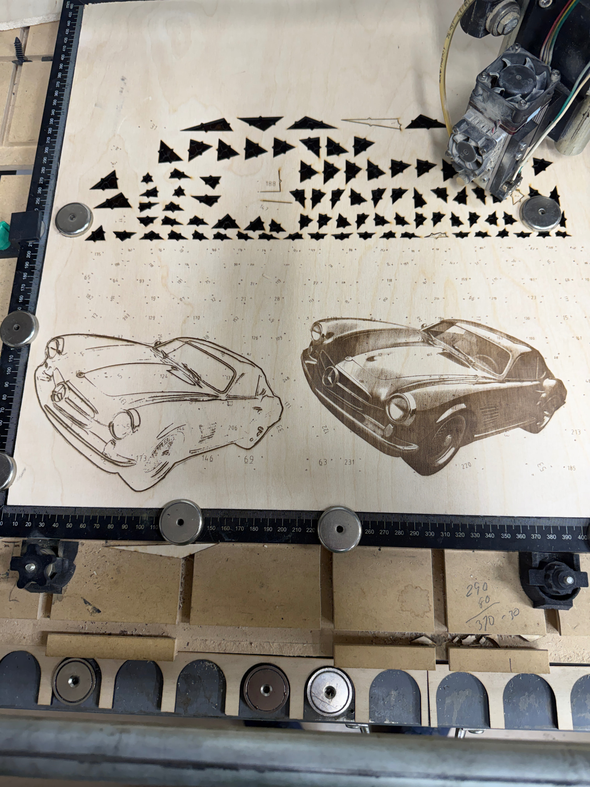

Problem #2 - Random job stops
Occasionally LightBurn stops during a job.
The LightBurn console suddenly shows a long stream of:
\xFF\xFF\xFF\xFF\xFF…
The job stops.
In another instance, after the garbage characters I also saw:
MSG:INFO: Restoring spindle
The interesting part is that I also see a long stream of 0xFF characters immediately before the ESP32 boot messages after RESET.
That makes me wonder if the controller is rebooting or the serial interface is becoming corrupted.

I would at least update to 3.9.9, but I am confident the newest version of flyidnc is also safe.
3.9.9 seems to have done the trick! I did 2 one hour burns.
one fill, one image.
Thanks
