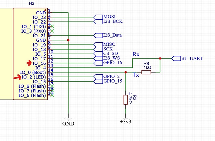

Okay, now that the esps are off for first run…let’s try to make the jackpot more robust.
The boot pin is bugging me, I do not want to move it, but I think it will make all the janky esp’s work fine and get rid of the pull-up.
So to move Tx off of gpio-0(boot) that pin needs to land somewhere known safe. Whatever is plugged into gpio0 needs to be non variable.

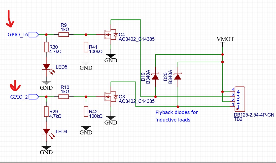

So Gpio16 and gpio2 are close proximity, or easy to use. Looking at this though, they are pulled down at boot(??) So these can not be a boot pin?

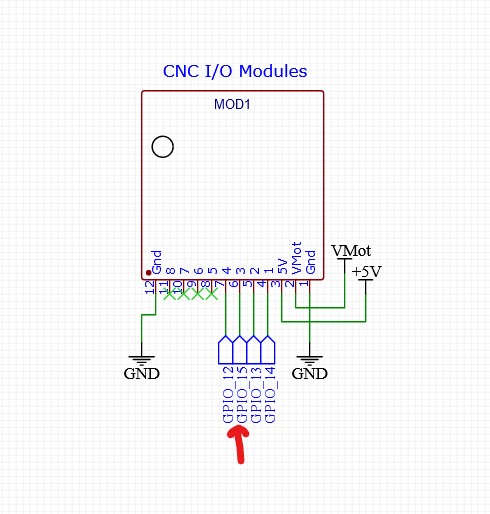

Gpio12-15 is unknown, depending on what module is plugged in, so those are out.
So that leaves gpio 17, 5, 18, 19, 21, 22, 23?
Any ideas?
What’s the specific issue here? Have you done anything to conclusively show that this is the issue? Is this something you’ve tested or just a hunch?
From looking at the Espressif docs, it appears that GPIO0 just needs to be held high at boot, either by its own weak internal pull-up or by whatever it’s externally connected to.
The easy approach to pins like that is to use them as outputs and make sure that they’re ok with being pulled in the right direction during startup. I would have said a UART Tx was a very good option there and this looks pretty similar to how I would have approached it.
I might not have a complete enough picture of what’s going on here, but I certainly don’t see anything here that would convince me that a layout change needs to happen. Some extra investigation or a couple of changes to components etc. to verify things, sure…
Now that we added the pullup, they all boot and flash perfectly fine. Now the odd boards are showing weird $ss messages. So Now I am getting more and more “bad” esp’s because I am not going to ship them if they repeatedly show incomplete $ss messages. Oddly Sometimes they work perfectly fine…after making stepper move a bit.
This does also vary when the Steppers are connected or not sometimes. So it is either a bad pin choice, or that pull up is too strong? Not sure. Or are these esps that are just bad and without the pullup they would not have flashed anyway. Was the pull up a waste?
The number of bad ones has taken a turn.
Heck it could be a firmware thing?
How would I test that. O-Scope the TX and RX pins and look at the signal?
Logic analyzer?
I guess that could be a good first real test. Currently, I am just making a pile of funky esp’s that almost work. Not seeing any obvious resistance differences on the good and bad gpio0 pins. Maybe I should also check the Rx pins.
Lower the baud rate?

So the pull-up was added at some point partway through and that fixed the booting issue? That would make sense, the internal pullup will be extremely weak and needs to be able to charge whatever capacitance is connected to the pin before the boot occurs.
As in there are some boards doing this or are these the same boards that were showing issues before? How is it weird? Garbled characters, missing sections, starts responding partway through? Does it only do it to the first if you repeat the message a few times?
That does sound odd. I think it’s important to try to accurately verify exactly what the failure conditions are and try to nail down exactly what affects it. If you’re trying to keep combinational stuff like that in your head, it’s possible to get lost in confirmation bias. The best scenario is if you can reduce it to a specific course of actions that make it fail 100% of the time. Something like ‘If I power up the board from cold and $ss doesn’t respond with a complete message, I can move a stepper motor and then $ss will always respond with a complete message’. That’s something you can start to tease out the different effects and see where they’re related. On the other hand, if it’s ‘I power up the board from cold and if $ss doesn’t respond properly, moving the stepper motor and then trying $ss will respond correctly 50% of the time’, then I’d say they may not be related and just to try it again without moving the stepper motor. If it’s a case of moving the stepper makes it work 50/50 and not moving the stepper means it works 0% of the time, that’s still a valuable thing to know, you just need to do it 10-20x as often to be sure that it’s actually a real effect and not just luck. Otherwise it’s like flipping a coin 10x and concluding that because you’ve only seen heads that your coin is broken!
A bad pin choice doesn’t sound right, to me, but I learned long ago that it’s always better to devise a test procedure to prove that it’s not something wacky than to discount it outright. Obviously test the easier/more likely stuff first, but never discount something because it ‘surely can’t be that’, etc. Pull-up too strong is definitely possible, I’m not super familiar with the drive strength of the ESP32s. This is where I’d normally say that’s an easy test by getting a scope probe on there and taking a look. Alternatively just drop it to 10k or even 22k and see what happens. Is that something you’re able to do?
Exactly! It could well be some kind of power supply issue causing a slow voltage rise on startup that changed the balance with that weak internal pull-up. It could be something entirely different.
I would never say it was a waste. It may not be needed, but everything is always a balance. Putting it there isn’t a big cost driver and is a conservative/defensive design decision. It may make zero difference, but if it doesn’t then you’ve only spent a couple cents extra per board. If it prevents problems even 1% of the time, it will be worth its weight in gold. Also considering that things need to be thought of as 'does it work on my bench, on someone elses bench, on 12V vs 24V supplies, on supplies with lots of ripple, in places with significant EMI, when the ESP32 is cold, when it’s hot, when it’s a cold boot vs a hot reboot, when it’s a hot reboot and the pin might have been at 0V when rebooted or at 3.3V. When the ESP32 input is at the low end or high end of its sensitivity specification, etc. In super detailed high-end designs or where the fix for an issue might be super expensive, we take ALL of that into account in one way or another and devise tests to make sure that things work in all those conditions. In the vast majority of circumstances or if it’s something like adding a pull-up, you add the pull-up and move on with your life. Consider it like designing a bridge. If you’re a hardcore professional and it’s a hugely long bridge on a tight budget, you do a huge amount of design work. If you’re a home-owner/DIYer and you’ve got a small creek to get over, you likely just over-build the shit out of it, slap it once, say ‘that aint falling down any time soon’ and move on with your day!
Could well be. In that case, writing a basic test firmware that just spams a message out of the UART could be useful to see if it’s re-creatable.
Yes to both of those things. Scope zoomed in to check that the waveforms going in/out of the ESP32 are crisp and square-wave looking with no glitches on the edges or ringing. Logic analyzer or good scope with good memory depth and serial decode to see that frames are being formed correctly, no doubled edges, timings are stable, checksums are correct etc.
How are you checking that resistance? I wouldn’t expect that to show anything useful, to be honest.
Another great option. Is this a hardware or software UART in the ESP32? Software UARTs are notorious for falling over at times when the software has too much other stuff going on. If you’re seeing ESP32s fail to work properly immediately after boot, maybe there is some other setup stuff still going on in the background or something that hasn’t timed out completely yet taking up cycles.
Again, separate it into testing vs fixing the issue. For testing, do the most extreme thing. Change it to 9600 baud and see what happens. If the comms issues go away but the drivers start doing weird stuff due to slow comms then that’s a huge win, evidence wise.
The flashing process should include some form of read-back verification step, so as long as the flashing completes successfully, you should be in identical scenarios either way. If the flashing process doesn’t do that, I’d frankly be horrified.
