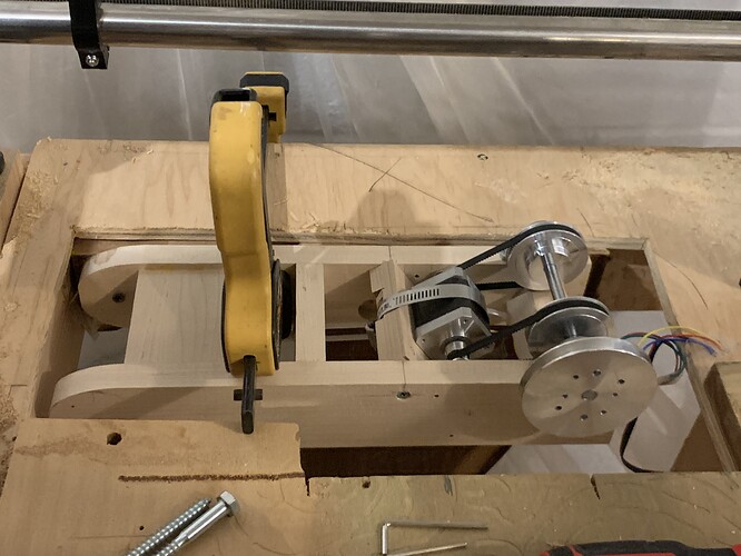

I’m setting up a rotary axis using two 4:1 pulley sets on this motor
CNCTOPBAOS Nema17 Stepper Motor 78oz.in 48mm Length 1.8A Dual Shaft for 3D Printer/Milling/CNC Router Machine 17HS8401B
Incidentally here is the physical part. Pictures next
I originally had a gear motor but it had backlash.
I am setting it up so I can lower the axis to run larger diameter stock. It lives at the back of my workspace (max Y) and pivots at the left end. I plan on mostly flat round workpieces so I’ll just bolt onto the flat face of the pulley. I used the double end motor and 2 belts.
The config file below works with other motors but this brand new motor doesn’t hold position nor does it turn. Is it dead? What else can I try? I have checked continuity of both coils and it is wired correctly.

Here is the result from a $ss command.  I set X max travel to 0 to get unlimited travel.  I get a warning but it did run (with the other motor)

Config File
Your $ss is not showing confirmed connection with all your drivers.
If you put your yaml on here and use the preformatted text option it is easier to read.
Have a look at this yaml for 4 drivers.

Does the motor get really hot when powered up?
When I first got my rotary it didn’t turn and it got really hot. It came with some additional short cables. I tried them and one worked. It changed the wire order to the motor.
I think the Jackpot wire order is AABB and my motor was different.
It doesn’t get hot. It’s wired AABB. The first motor got hot until I turned down the hold amps and run amps.
I’ll try and turn them up as in Ryan’s response.
Thanks
I’m pretty sure it’s a bad motor.
Thanks for your input
Please explain how you see that drivers are not confirmed.
I tried this as written and it worked worked as I expected; only 1 motor on x and y. I tried adding the other motors but didn’t get it right apparently. Is there a table showing all the pins for the 6 drivers?
Should I be able to move A? G0a360f200 or something?
I also have a possibly intermittent problem where the sd card is not recognized. I moved the sd card statement closer to the top of the yaml.
I don’t have time right now to add the yaml file or the $ss response but I will try later.
Thanks
Can you show me a picture of your full machine, I am a little unclear as to what exactly you are doing.
MPCNC with an added A axis?
