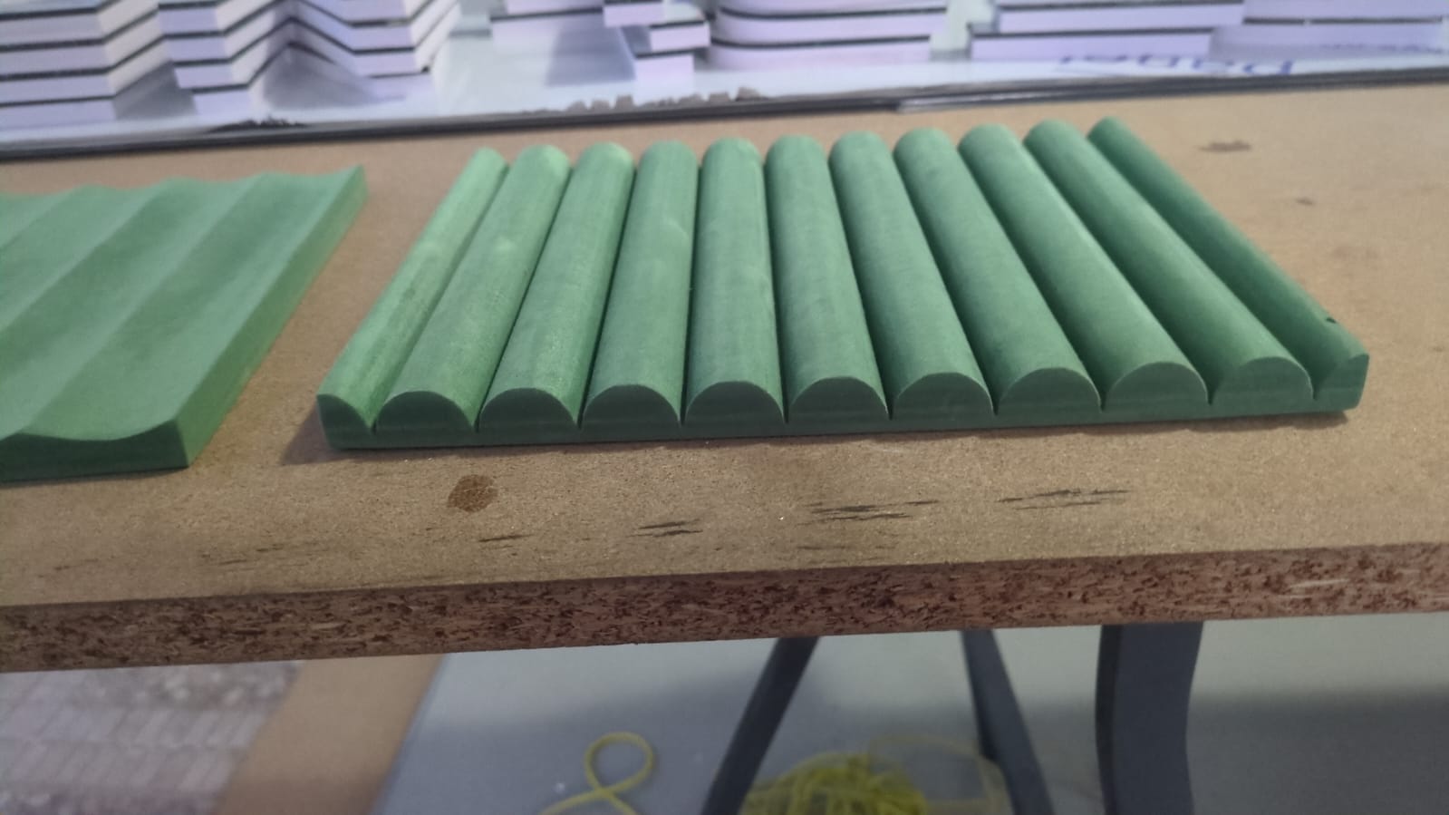

Btw my laser its a neje a40640. -after the repair it cuts 1/8" mdf better than my k40… And its so much easier to do basic engravings, soon will post some pictures of some mdf panels im making with the cnc. (I know different topic but they are pretty neat)
A small peak. (Full 4x8 sheets)
