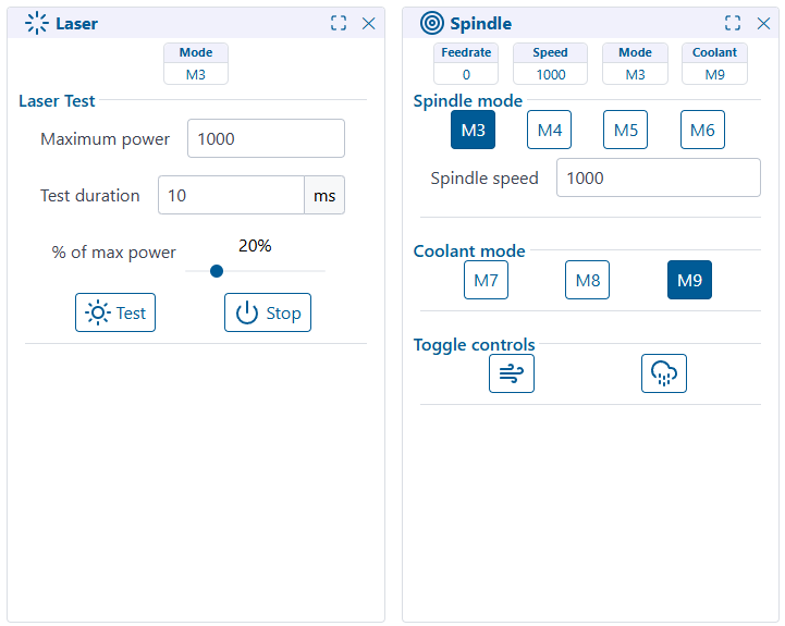

Basic questions:
The web interface still shows spindle control. Does that indicate I’ve got a typo in the yaml file?
Is there an LED that’s supposed to come on when gpio27 is active? It hasn’t lit up.

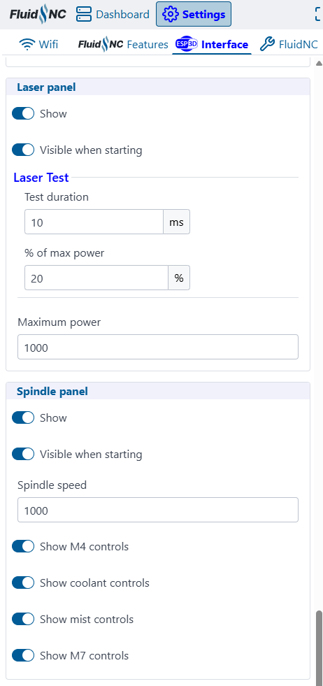

Are you using WebUI v2 or v3?
These are the WebUI v3 panels. Whether or not they show up is only based on WebUI settings and has nothing to do with config.yaml.
Yes, but it looks like the default test duration is 10ms so I doubt you’d see anything.
I must still be on webui 2.I figured I’d get things moving and burning first, then try updating. Sounds like maybe I should update now, if that will make the further troubleshooting easier.
I was excited that Lightburn had no difficulty connecting to the controller via ip address. Looking through the FluidNC documentation on the wiki it sounds like I need to do a little more reading about M3 versus M4 in laser mode.
Last time I used a laser I got hung up on some modes only show light (fire the laser) when moving. Definitely need to have a little look through the fluidnc wiki about laser modes.

I’m pretty sure that’s WebUI v2. The screenshots I showed were v3 which is what I would use these days.
You can update by just uploading index.html.gz, preferences.json and favicon.ico to flash (skip the config.yaml, that’s specific to a machine).
