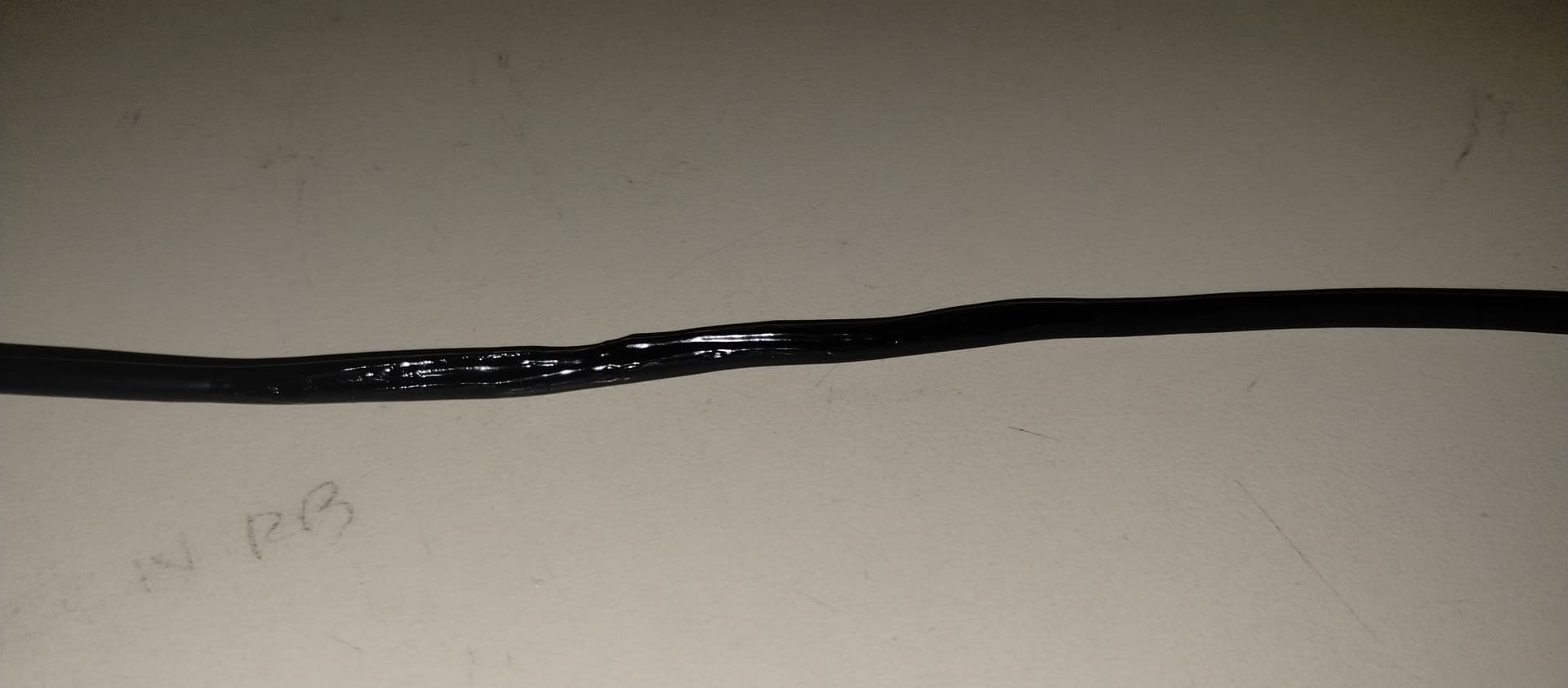

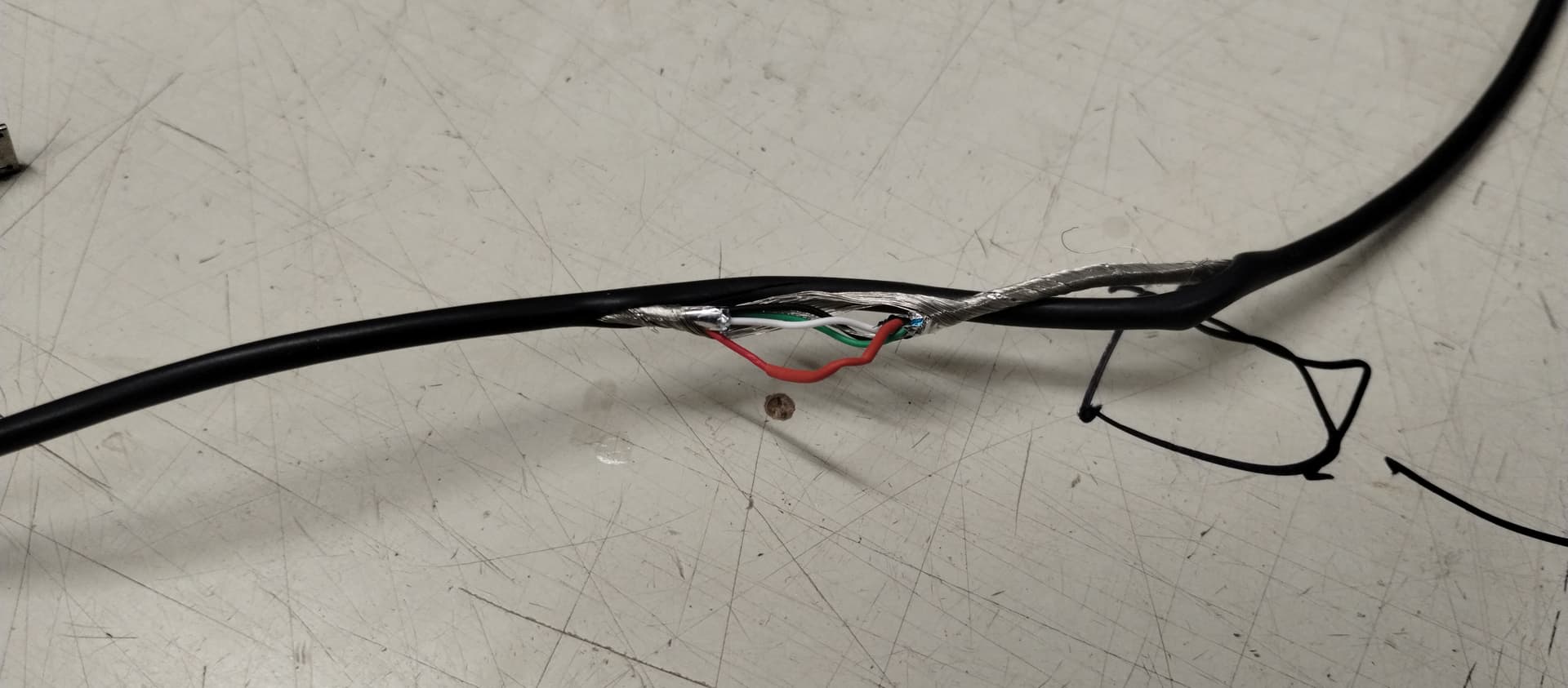

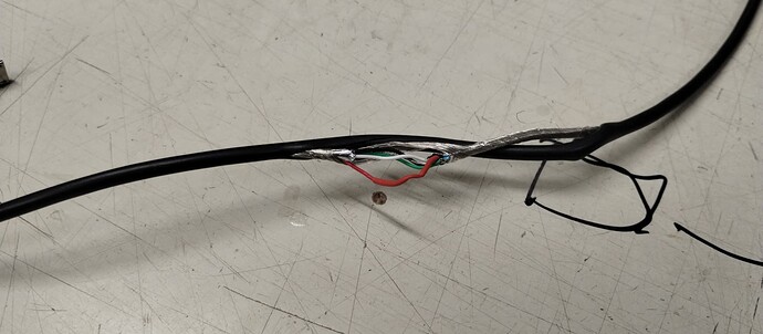

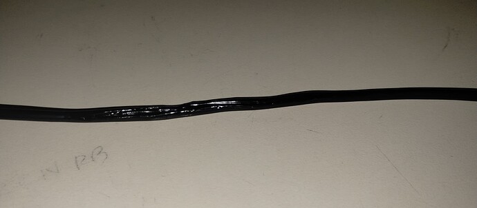

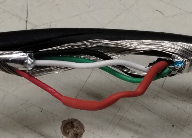

Cutting open those USB cables can be tricky. What did yours end up looking like? The wires inside most of mine are super tiny.
I slice the sheath about 2" (careful not to cut shielding or cut into conductors)
Unwind the cable to allow shielding to be separated
Expose and cut out a section or the red wire about 1/8" long (eliminates the conductor from re-connecting while under heat shrink)
Put heatshrink on the red wire to isolate the conductor ends from touching shield
Re-twist the conductors into shield
Place sheath back over the conductors
Seal cable back up with liquid tape
